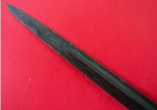

Hi, Alan, thank you for your explanation. But, if it's layers of billet parallel to the core being carved to form the odo-odo, wouldn't the apparence looks like this picture(it's a Damascus steel known for it's folded lines )?
For folded steel with many layers, if we cut a section or a bevel, we will be able to see many parallel lines because the steel block is folded in multiple layers, and the welded lines can be seen in the bevel or cut surface. But this keris does not show these layered features in the odo-odo and the bevel caused by the slotted middle. So, I guess, is this keris carved first, including the formation of odo-odo, the groove of the sword, and then welded with a thin layer of Palmer?
