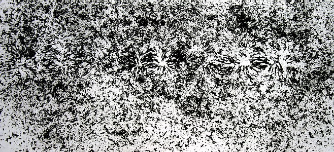

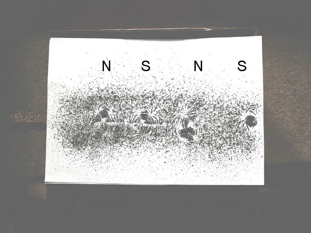

Old 20th February 2005, 01:45 AM   #40
Mare Rosu
Deceased
Mare Rosu's Avatar
Location: USA, DEEP SOUTH, GEORGIA, Y'all hear?
Posts: 121
Question Dagger magnetic fields
JENS
I had a very hard time getting these two pictures of the Mysore dagger.
It took several days just to get them. I used two different types of material to show the effect, one was a powder Iron and very rusty, but it did a better job as it was finer and dispersed better the other, which was Zinc coated Iron filings while not rusty it very course and did not disperse as well.
Regardless the compass will start N and then S and back to N and finally S at the very tip of the 12" blade.
Gene
Mare Rosu is offline   Reply With Quote
Old 20th February 2005, 02:00 AM   #41
Rivkin
Posts: 655
A fantastic picture. I see that most of the blade is not magnetized at all, but there 4-7 macrodomains, which are magnetized. I would say that there definitely has to be some kind of a structural nonuniformety at these points. What surprises me that these domains are quite big, moreover rather than forming let's say a vortex like structure they are actually very well separated.
For now I would say that there are 4 areas that either cooled much slower than the rest of the blade, or somehow else vastly differ from the rest of the blade.
I'm not surprised to see N/S/N configuration: the interaction in between of these areas is obviously dipole-based, and knowing the fact that is magnetized perpendicular to the line that connects these (I don't really want to confuse people by saing "domains") areas, the most benefitial configuration would indeed be the one with the opposite magnetizations.
I will try to get some other opinions on this image - great stuff, thank you.

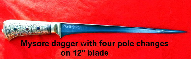

JENS
This is a picture of the dagger.
RIVKIN Thanks for your comments on the picture.
I would like to tell all that would try and duplicate this, is this. Be ready for a lot of frustration! as I tried this well over a 50 times over a two weeks time period taking hours and hours of time. I gleefully jumped into this project and just dumped the Iron Powder over the covered blade, sorry it did not work at all for me. To make a long story Short, I had to make a box (patten applied for! )that would hold the dagger level and keep all wind currents away from the Iron powder (sneezing will do "wonders" to the effect, don't ask ) I had to just about place each Iron particle by hand on the paper, as the Iron powder would not form a pattern if to much was used in one place and it had to be even over all the blade. I also think that by leaving it undisturbed, with the Iron powder in place, for two days did allow the Iron powder to take a "set", that's my thinking anyway. It would be nice also if your Iron powder was not rusty as mine was, it sure is messy, and will cause you to sneeze (I said do not ask!). The Zinc coated Iron filings just did not work well for me as it was just to course however it did not cause a mess or make me sneeze.
Gene

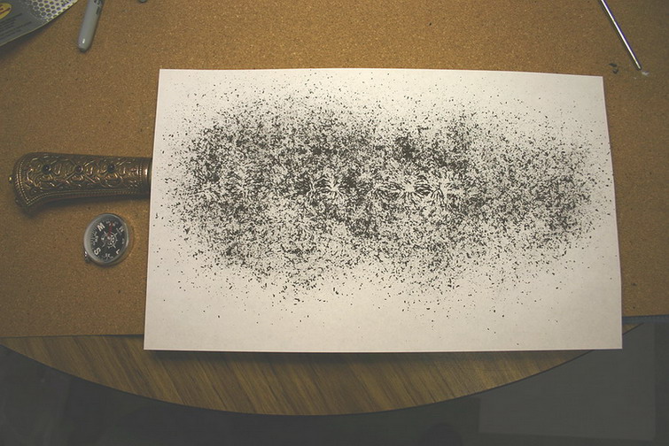

I have good news and bad news on my dagger I call Mysore ( I think that is a name that depicted my feelings when I dropped the dagger, My Sore!, I wish no disrespect to the good folks in Mysore India as my southern humor is at play here )
I have replaced the Period stone in the handle and it really looks good, that is the good news.
The bad news is that the magnetic field has changed after the drop. While the same N,S,N,S, pattern with my compass is still the same, the overall attraction is a lot less now, I will try to set up a visual display of the effect tomorrow using the Iron powder (no Jens I did not polish the rust off the Iron powder and take some pictures for posting here.
I have something else to confuse, (at least it is confussing to me, that for sure), you good forum folks about all of this, is that the compass needle does not change directions the same way as I move the compass over the blade, one time the needle goes counterclockwise and then it goes clockwise as I move the compass over the blade as it reverses direction. I would think it would always move in the same direction, I will post more information, tomorrow to make this a little more understanable.
Anyway things are getting back to normal with the repair done.
But the mystery of the Mysore Dagger goes on!
Gene

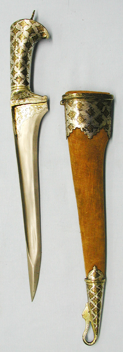

Gene, it is very unfortunate that you dropped the pesh-kabz, but at the same time it is very fortunate that it did not piece your foot. Always look at the bright sides of life.
Do you have the impression that the hilt of your pesh-kabz is hollow?
The one shown below has a hollow grip, and the blade is magnetic, but only one time N-S.

Thumbs up New pictures of the magnetic field
JENS
Two pictures of the change in magnetic field on the Mysore dagger.
As you can tell the Iron powder is not showing the magnetic field as well as the first time we tested it. I had to use the side of the blade instead of the "T" back as I did in the first "test", to even get this amount to show.
The N, S, N, S change in the compass is still the same, and I cannot tell any change in that at all.
What is puzzling to me is that the needle on the compass does not turn in the same direction. It will go counterclockwise at first then go clockwise the next two times when going to the new poll positions.
The hilt is also solid and that is why it did not go point down and stab me in the leg

Hi Mare,
Sneaky is as sneaky does, sahr.... (Forrest Gump reference, in case you didn't catch it)
(Un)fortunately, everyone in my family is pretty honest--great practical jokers, but honest otherwise.
One suggestion about the compass needle flipping back and forth is that I suspect it's taking the minimum energy path for flipping. I've seen the same kind of thing playing with a compass and magnets, and I'm pretty sure that the needle will flip back and forth in the minimum arc necessary to follow the magnetic field. There's no particular reason (that I can think of anyway) that the compass will always spin in the same pattern every time.
Personally, I'm enjoying the patterns you're producing. If you really want to get involved, you could get one of those magnetic knife racks and a couple of cheap kitchen knives, and see if you can reproduce the banding pattern.
Fearn

I will get one of those knife holders today and give it a try, great idea.
However you are just confirming my deep convictions of your upbringings
I do agree, now that you have explained it to me, on the reason why the needle swings the way is does, most things do go by the path of least resistance.
I am also going to try and find four (cheep) compasses and place them on the blade and take a picture of the compasses all being in a different direction at the same time, just to show to the nay sayers (if there be any out there) that this is happening the way I am explaining it.
Gene

Gene, I can see what you mean – did you use the same amount of iron powder, and are the iron pieces of equal size? I guess that you did, and that they are, but it does not hurt to ask, or I may look forward to another sleepless night .
Fearn's suggestion sounds like a good idea to try, I am looking forward to hear how the experiment runs.

I did use the same Iron powder as well as trying to do it the very same way. I could not use as much of the Iron powder as the magnetic field was so weak that if I use more it overwhelmed the effect and I could not take a picture of it. I am getting better at this as it only took me six times this time. To answer the question about the Peridot replacement on the dagger is that I went to a store in Franklyn NC called Ruby City and they has a pear/seed shaped stone of the exact size needed for the replacement. I did not want to leave the dagger with them so I bought the stone at the outrageous price of $5.00! and did the replacement my self. I did get "how to" advice from the owner as to how to do it. All in all not a bad days piece of work don't you think? For your information, ( I know you did not ask but I will tell you anyway) that Franklyn, NC is famous for it's Ruby mining as well as Sapphires and Garnets and other gems. You have to watch out as there are a lot of "sea sick" Rubies for the unawares for sale. What is "Sea Sick" Rubies you ask? Rubies from overseas that are of very poor quality and the name comes from the sea voyage over here, are then "salted" in the mines for the "tourist" to find.
FEARN
I took your advice/suggestion and did acquire a magnetic knife holder to test the effect on a cheep carbon knife. I also got four compasses to show the effect on the pol changes on the dagger. Will set this all up tomorrow and take pictures for you and others of the forum.
