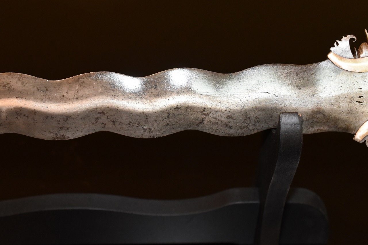

Default #4 Etching and New Scabbard
I etched #4 and had a new scabbard made. The wood is Kamagong (also called Mabolo), a variety of ebony endemic to the Philippines. It is a highly esteemed wood but I have never seen it on an antique Moro scabbard before. Probably, the reason is because it is dense and heavy. While based on traditional Moro design, the scabbard is in the style of the makers (well known blacksmiths from the Province of Pangasinan) and thus modern.
Here are some pictures showing the condition of the kris at the time of purchase, after initial restoration and finally, after etching. I think it turned out nicely.

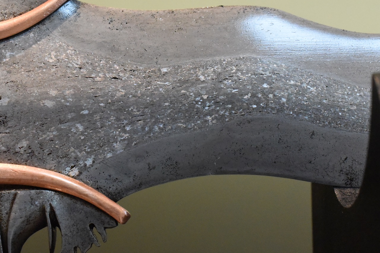

Wow, I'm glad that you rescued this kris - the blade did came out very nice!
Could you add some close-ups of the blade for getting a better glimpse on the laminations, please?

Hello Kai and Detlef. I completely understand your preference for traditional design. I had this made in the style of the makers because the material used was non-traditional. I just wanted a scabbard made of kamagong (I really like this wood ) If ever I have another scabbard made, it will be as traditional as it can get.
Kai, attached is the photo you requested. Thank you both for your comments!

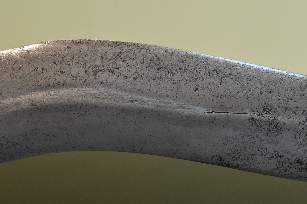

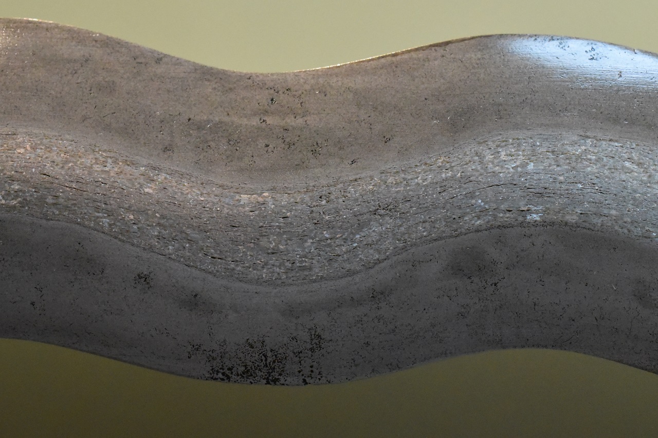

Default Re-etched #5
I re-etched #5 (http://www.vikingsword.com/vb/showthread.php?t=22242) and a pattern emerged on the core. Did I over etch? It looks almost like glitter. I wonder if this was intended by its maker.

That's a very good etch that you achieved, and a very unusual pattern that emerged. It's hard to know if the creator of the blade intended it to have such an effect, but some of these guys were really talented at producing specific effects and it's quite possible that this was the intended outcome. Perhaps Roland or one of our other metallurgists can speak to the way this effect was created.

What you see is the microcrystalline structure of the metal. It get visible by the etchant you used. By an other etchant it wouldn't be visible like this.

Thanks for your comments, Ian and Detlef!
Detlef, I used white cane vinegar (sukang puti) to etch the blade. I was just trying to make the contrast stronger between the metals when the pattern emerged. I felt like I was looking at stars when I wiped off the oxidized metal because of the way it sparkled. But I was also concerned that I may have ruined the blade. Anyway, it looks so much better in person.

I agree that the etch seems perfectly ok - you often see these crystalline structures once the polish is done nicely and the etching accentuates the details of the clean metal surface.
I prefer to use industrial acetic acid because its strength is exactly known and can be diluted for routine use (more reproducible). The advantage of AA being volatile is that it can be completely removed via heating the blade and that it tends to also work on rust in crevices (it helps long-term preservation to remove all active rust). This can lead to some porosity of the blade and you start to see this with the narrow pamor band on each side. IMHO this is not a problem but I'd avoid to etch more (repolishing and re-etching are always an option if the surface gets too rough from over-etching). After a thorough oiling, you can go for sealing with microcristalline wax (which can also be used to close the larger pores if deemed preferable).
Hi F. d. Luzon,
don't worry, the outcome is very nice, the blade isn't ruined but look much better as before. It's a nice piece and you have given it the best care!

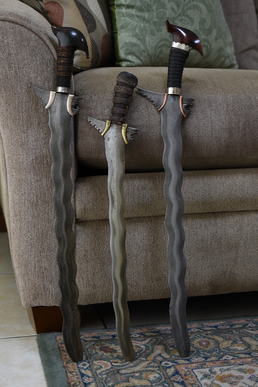

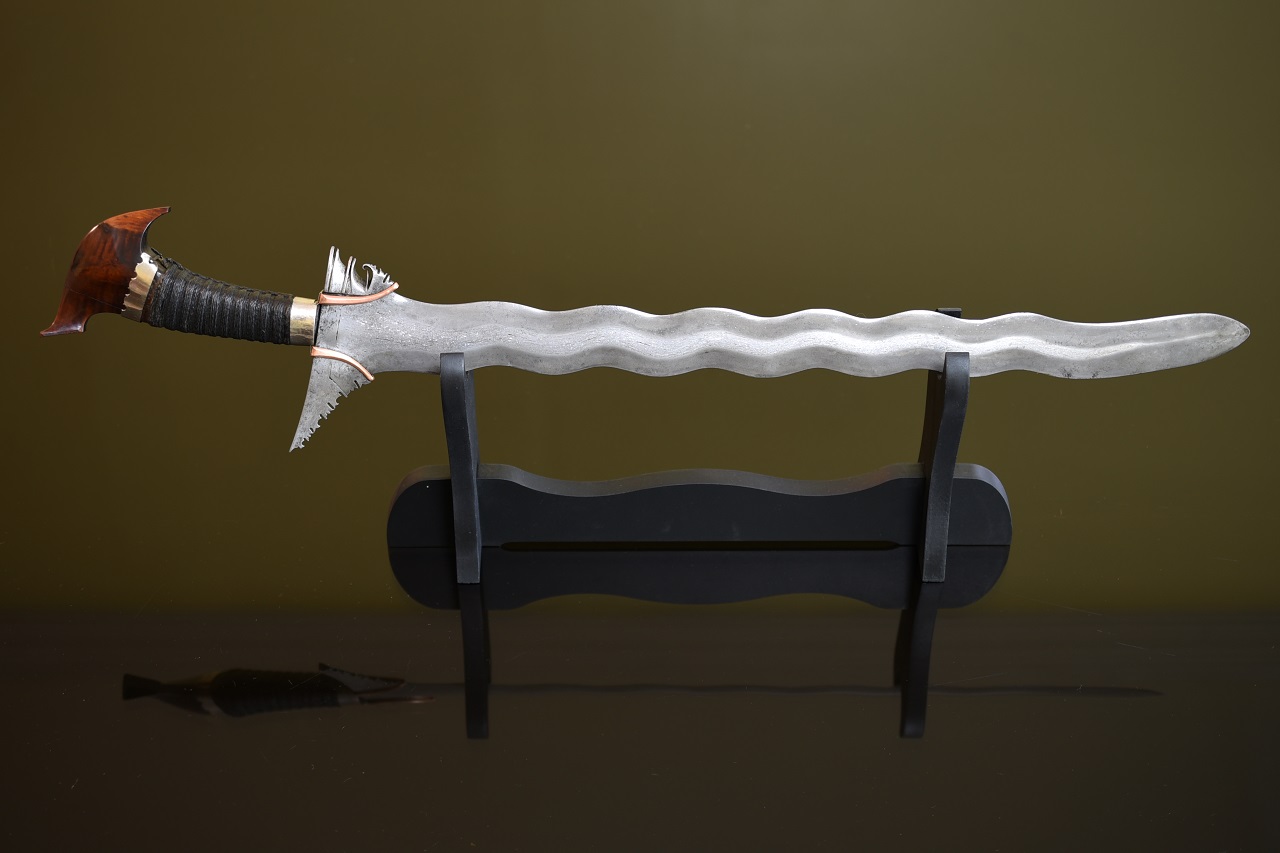

Thanks for your comment Rick.
I have a kris that is smaller than the others in my collection and I've always wondered if it was a child's kris. The blade is only 17.5 inches long (44.5 cm) and the width is proportionate to the length. Below is a photo for your reference.
Please share your thoughts.

F. de Luzon:
Another nice kris. Not all small kris are necessarily children's kris. We should not forgot that some Moro women fought beside their husbands, brothers and fathers. I'm inclined to think some of these slightly shorter and slimmer versions may have been meant for women. Also, many of the older kris (pre-1800) were shorter and slimmer than those of 19th C Mindanao. I'm not suggesting that your smaller example is earlier than the 19th C, but we should not think that all short, slim kris were designed for children--they were definitely weapons and could be used as such by adults.

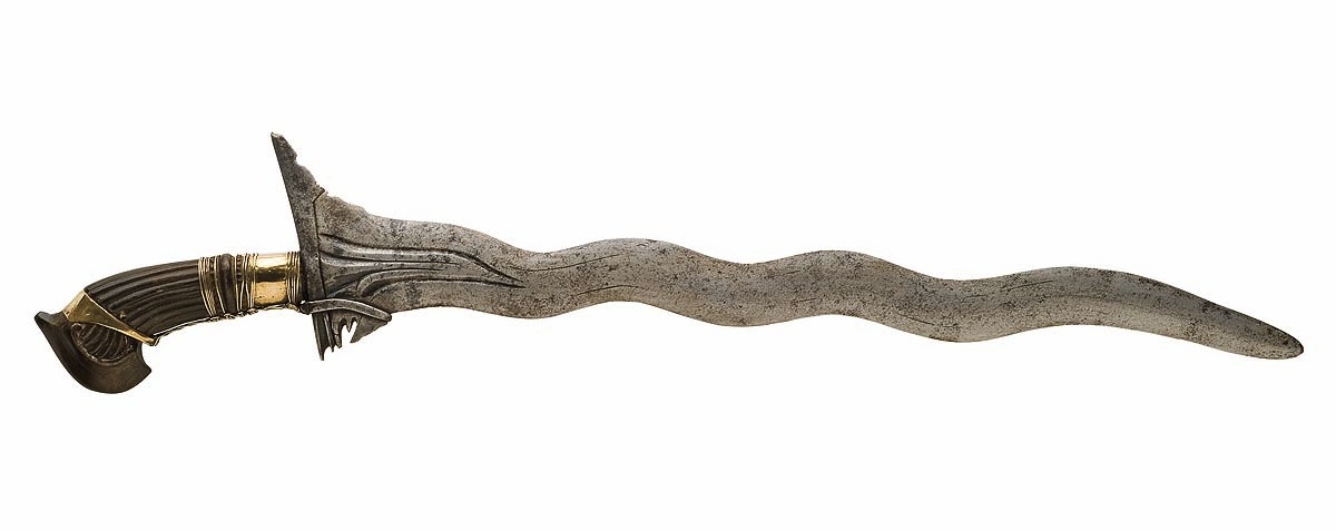

Attached below is an example of an 18th C. kris that is similar in length to your shorter example.
Ian.
----------------Attachment--18th C Moro kris------------------
