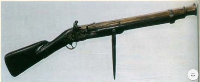

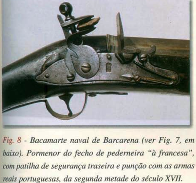

So, i was crossing some information towards checking a (possibly) faded mark on my bronze barreled blunderbuss, and what do i find ? Confirmation that guns with a dog lock system were indeed (also) made in Portugal. The place is Barcarena, where Royal smithy facilities were first implemented in 1487 for the purpose of arms making, having circa 1618-1619 taken place the first factory of black gun powder.
We can see in THIS CATALOGUE, besides other illustrations, that of a naval bronze barreled blunderbuss from the middle of the XVII century, "which could shoot nine bullets connected by a chain, with purpose to tear the rig of enemy ships".

Now, that's what I'm talking about!! Sorry, couldn't resist- As I mentioned, brass and bronze blunderbuss, particularly those on a swivel (rail gun) very popular with the naval men. Quite surprised to see one loaded with anti-rigging chain-shot!

In what I understand, the trabucos uploaded by fernando (post # 1 and # 43,) the safety hook (dog.lock) hooked in half mounts to the foot of cat (cock, hammer) is automatically unhooked when placing the foot of cat in full-cock, the two flat surfaces run one another, moving the end of the safety hook away from the notch in the foot of the cat, that is, the movement of the cat foot backwards (full-cock) to disengage the security mechanism.

By the way, the doglock, with it's banana shaped lock plate on the navel swivel gun on Post #43 is similar to the English doglocks from the 4th Quarter of the 1600's to about 1720.

Rick, you posted some good info that puts Fernando's gun in a meaningful historical context. To which I'd like to add that the banana-shaped lockplate, generally with a pronounced teat on its tail (the stem? ) is a common feature of the fully developed "French" flintlock in general during the period you mention, as applied to all types of firearms using it. In conservative regions like parts of the German-speaking lands, it is recognizable on guns dating from a bit later as well.
