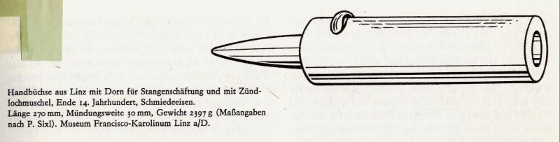

The Loshult gun is 30 cm long, its maximum outer diameter is 11 cm at the rear end and 4.7 cm at the muzzle, the irregular bore is 3.6 cm and provided firing gun arrows.

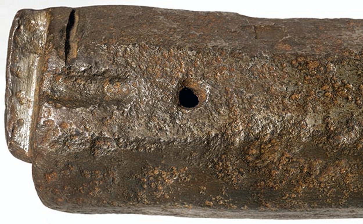

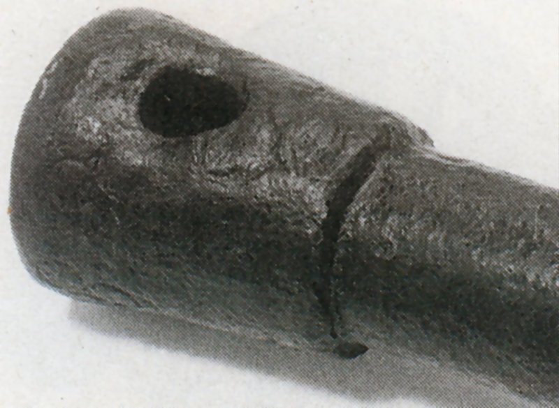

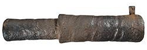

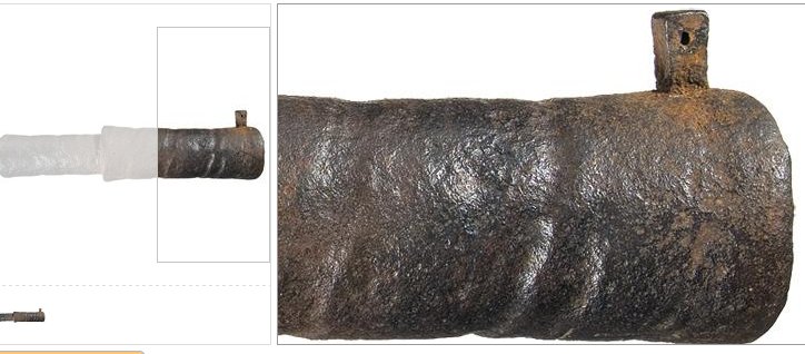

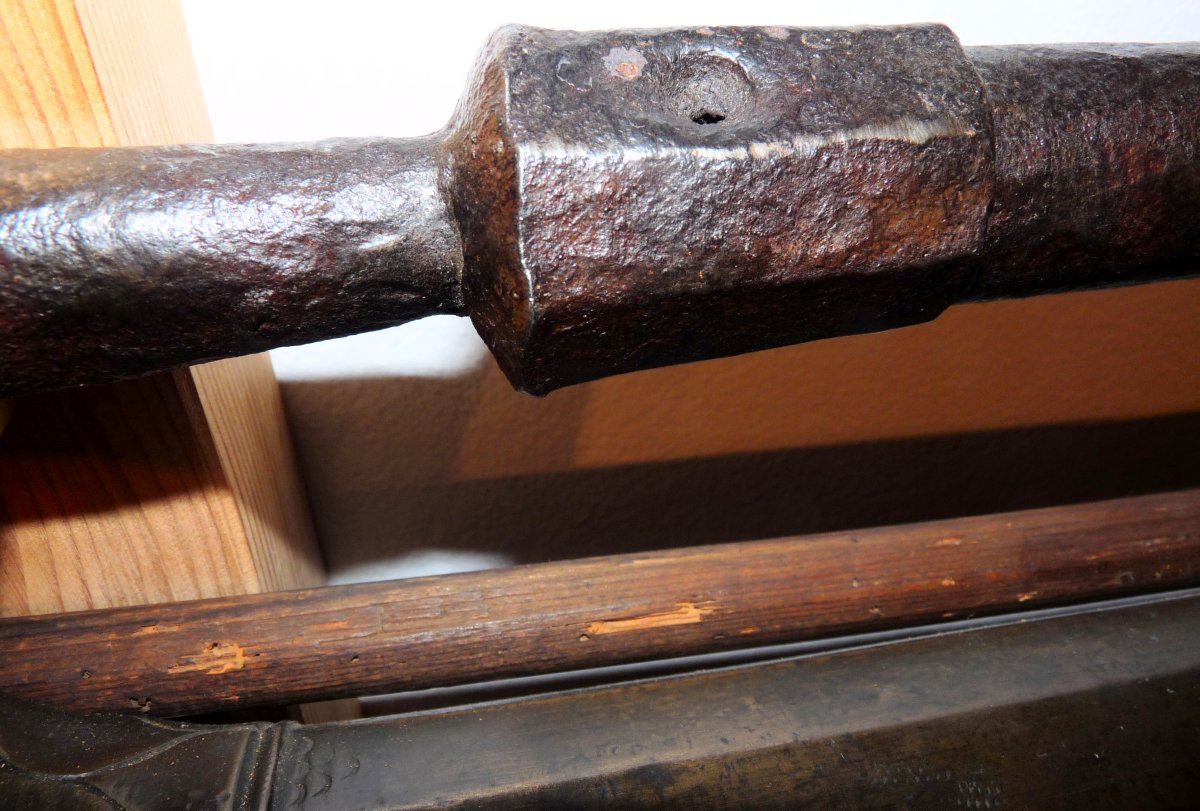

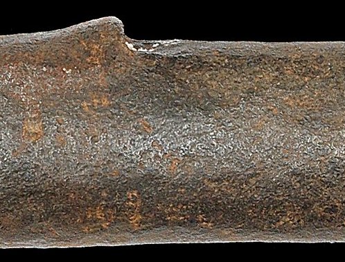

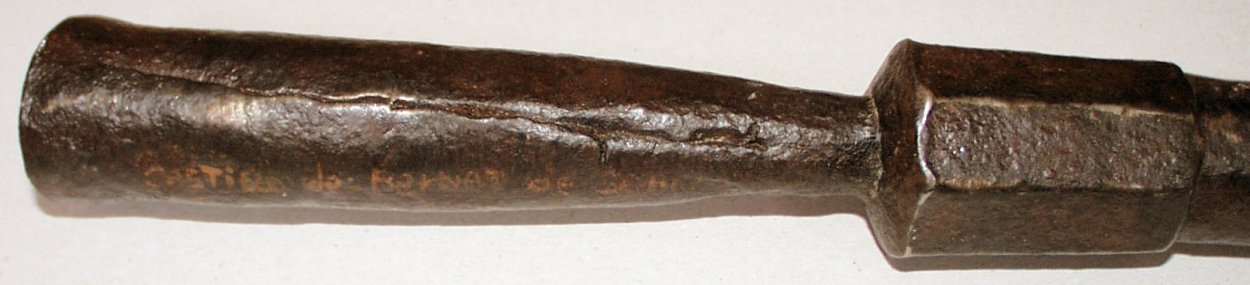

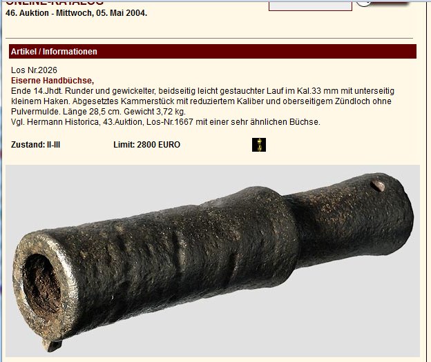

One of those historical Aljubarrota barrels is in the author's study collection (attachments) and I attached (sadly poor) images of another. We may safely imagine them to be employed fixed to a long and thin wooden stock by the means of two flat iron bands.
Its length is only 13.4 cm, the maximum outer diameter is 4.3 cm at the rear, the touch hole is struck irregularly, ca. 2.5 x 3.6 mm and located 1 cm in front of the rear end, the 'bore' at the slightly swamped muzzle is 2.7 cm but I am sure that is was not drilled, just fire-wrought.

http://www.vikingsword.com/vb/showth...nd+cannon+1400

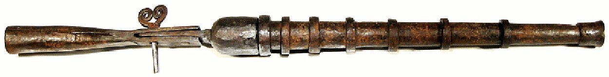

In the 1430's, the iron first barrels with integral fire-welded recoil hooks on the underside seem to have appeared, and such hooks were added to older barrels the way just described. As one of the many results of my four decades of closest research and studies, the famous earliest gun in the Historisches Museum Bern, Switzerland, generally known as the Bern gun, cannot have been stocked with its present hook before the 1430's. The barrel of course is the oldest part and dates from ca. 1390-1400.

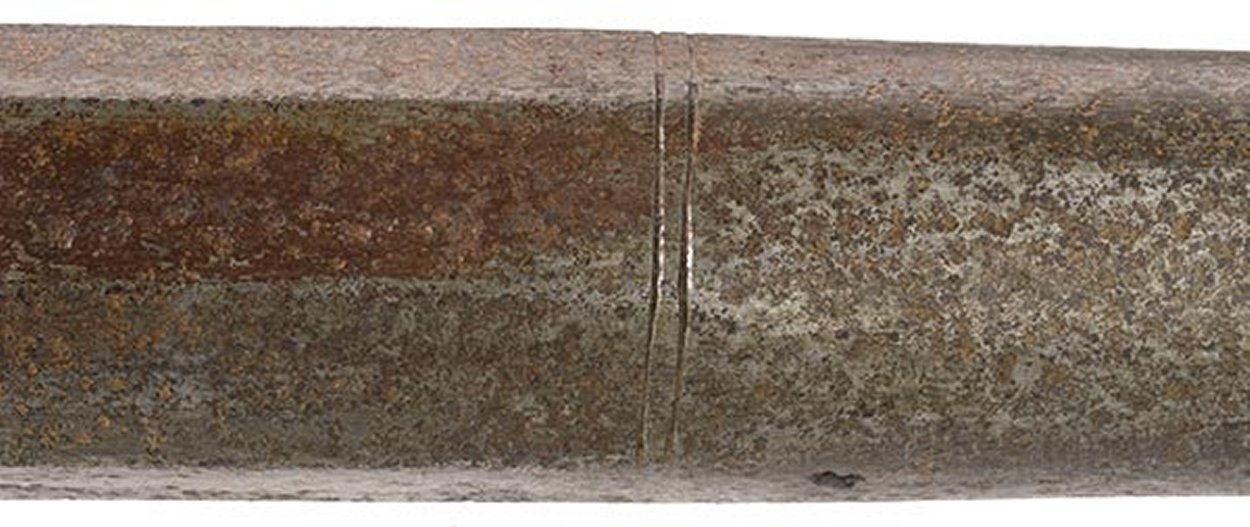

By ca. 1460, the octagonal outer shape of the barrel had been well established; the touch hole now began to slightly make its way to the right, at the beginning located on the first edge next to the top flat clockwise. At the same time it becomes notably larger, and diameters of 1.5 cm are not rare to find, although they must have resulted in a significant loss of gas. From that time on, similarly huge touch holes became common on most barrels. Also, the position on the first edge next to the top flat clockwise, in many cases remained the same until the end of the 15th c., especially in Alpine regions like Austria and Tyrol. I attached a barrel at a dealer who dated it 'ca. 1460' based on the position of its touch hole. The shape of the muzzle section, however, is the latest, 'youngest' stylistic criterion and therefore crucial for correctly dating any barrel, and the 'Maximilian' style crown-like muzzle hollowed between the spikes is a clear indication of ca. 1490-1500.

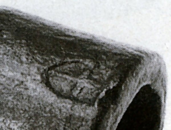

The presence, position and shape of sights are another important dating criterion on barrels. They first appeared around the mid-15th c. starting with a raised rear fire shield behind the touch hole on top of iron barrels, incised with a small central slot for aiming (attachments). At about the same period there was just a very subtle small raised portion of the swamped muzzle that acted as the first preliminary stage of a foresight. On my earliest Nuremberg/Passau barrel of the 1460's, a very rare instance of a hog's back barrel (Schweinsrückenlauf), an edge instead on top of an octagonal barrel fulfills the function of both sights over all its length. My next-in-line Passau barrel, bearing the earliest known city mark of Munich according to Erasmus Grasser's design of 1477 together with the date 1481, is the second-oldest dated handgun barrel in the world:
http://www.vikingsword.com/vb/showth...+dated+handgun
(after I discovered this barrel dated 1417 just a few days ago:
http://www.vikingsword.com/vb/showth...+dated+handgun)
It has a fully developed rear sight, most probably dovetailed, with a central slot over all of its height (ca. 1.5 cm), right on the base (rear end) of the barrel, and one edge of the heavily swamped octagonal muzzle section acts as a foresight.

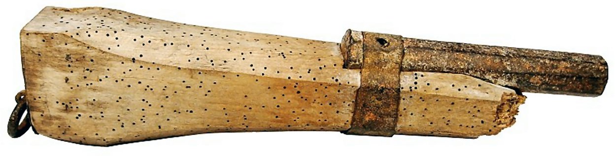

My earliest matchlock arquebus, the stock ca. 1520's, features a small, older and re-used bronze barrel of ca. 1490 which already has a tiny sighting blade mounted inside its founded rear block sight! A singular instance of the pursuit of optimum aiming at the turn of the Gothic to the Renaissance period 514 years ago!

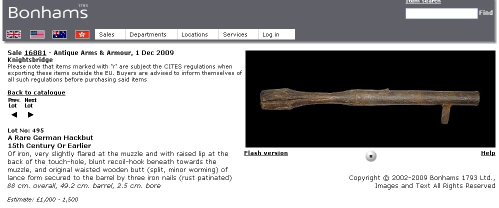

Just for the principle of completeness, I wish to add that instances of hooks on wrought-iron wallgun barrels were made as long as the second half of the 18th century. And the old Gothic barrels were still used parallel to new productions, often restocked in the respective taste and combined with wheellock and flintlock mechanisms, way up to the mid-19th century when some of them saw their last service update by being transformed to percussion, like a few sold from the fortress of Hohenwerfen near Salzburg, Austria.
Those barrels, though hundreds of years old, proved resilient and indestructable, in spite of the fact that many of them got drilled out to a bigger bore! Only the strong black black powder of the second half of the 19th c. made of few of them burst, mostly bronze barrels.

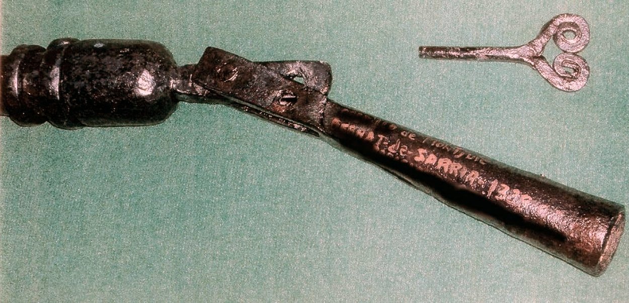

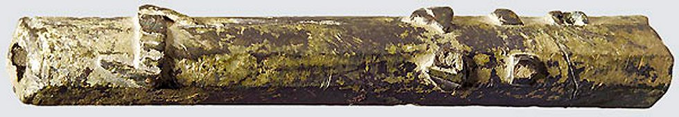

And here the circle is complete. Cast-bronze barrels marked the beginning of it all. Although we have no more records of them since the Loshult gun (ca. 1350) until the so-called Tannenberg Barrel, which to some is still 'the oldest datable gun barrel, pre-1399', but which, as I have pointed out earlier, really was cast only around 1440-50, more samples are known by ca. 1460-80, and they were made as long as the mid-16th c., one sample in the museum of Verden in North Germany is even dated 1584.
Bronze barrels mostly followed stylistic criteria of their own. They seem to have been the first staged barrels, as the Tannenberg sample denotes, which does not yet have sights at all, and starting from ca. 1480 they came complete with an integrally cast rear sight on the rear end (base of the barrel, German Bodenstück) and a foresight. Foresights were an integrally cast part of the reinforced muzzle section.

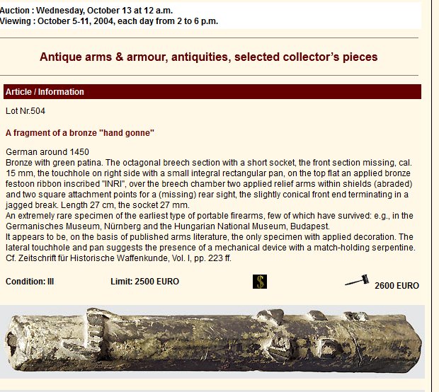

Until ca. 1480, both Nuremberg and Tyrolean bronze barrels were mostly octagonal throughout, sometimes changing sides at about 40 per cent of their overall length, with pronouncedly bell-mouthed muzzles and the bore enlarged at the muzzle for easy loading. By about 1490, two-stage barrels, octogonal to round, prevailed, equiped with a short, accentuated round or octagonal muzzle section (German: Mündungskopf) with integrally cast low and narrow foresight that was as long as the muzzle section (ca. 2 cm). The rear sight was also integrally cast and rather low, ca. 8 mm high, as broad as the top flat of the barrel, and with a narrow central slot right down to that top flat.
A finely structured and filed, fully developed rectangular pan with a rounded shallow trough around the touch hole was also cast integrally, and a swiveling bronze or brass pan cover was pivoted on a horizontal bronze or iron rivet, with a finely wrought drop-down handle.
Also in the 1490's, a roped frieze (German: Schnurbandfries, Schnürlband) often emerged immediately in front of the muzzle section and in many cases stayed at least until the 1530's.
In ca. 1490, Nuremberg as the leading style designing German center, introduced a third rear stage on his bronze barrels. By ca. 1512-15, Nuremberg bronze barrels now had an elongated muzzle section (German: langer Mündungskopf) bearing a raised and rounded blade foresight that was moved back from the muzzle plane by ca. 2 cm. Our modern foresight is 500 years old! At the same time the first, rear barrel stage now beame rather short and mostly multi-sided: octagonal, twelve- or 16-sided, while the second stage was mostly round and the longest stage of the barrel. A finely preserved snap-tinderlock arquebus in the St. Petersburg Hermitage is the oldest known sample (inv.no. 5054, see attachments). Leonid Tarassuk, in Antique European and Armerican Firearms in the Hermitage Museum, 1972, no. 2 in his book, dated it 'ca. 1500, which is a bit too early; 1512-15 seems exactly correct. The stock is painted black, the right side of the buttstock bearing the red and white coat-of-arms of the Nuremberg patrician family Behaim (Pehaim).

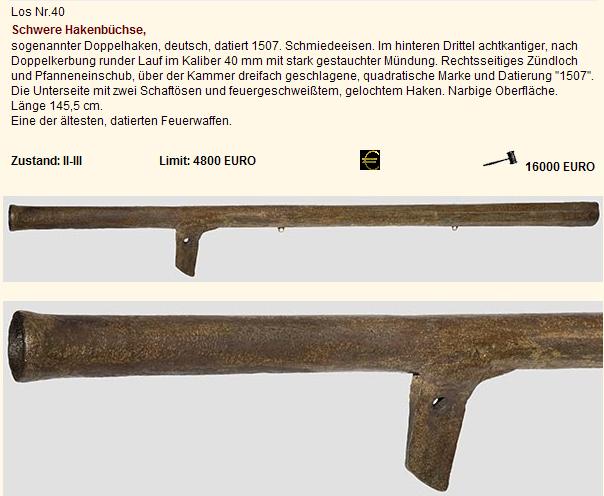

A singular, fine, huge and heavy, perfectly preserved Nuremberg wall gun (German: doppelter Doppelhaken), with a weight of 35 kg, ca. 1515-20, features a finely wrought five-staged bronze barrel with elongated muzzle section; filed moldings and raised, rounded scales were employed to accentuate the respective stages:
http://www.vikingsword.com/vb/showth...emberg+1515-20
The forth, round stage is the longest, and the muzzle section bears a low blade foresight over all of its length.
With barrels staged like that, those heavy wall guns emphasized their membership of the 'family' of cannon pieces. They were employed rested on a tripod, often equiped with two wheels, and had to be served by two men who aimed and ignited the heavy piece respectively (Richt- und Feuerschütze)

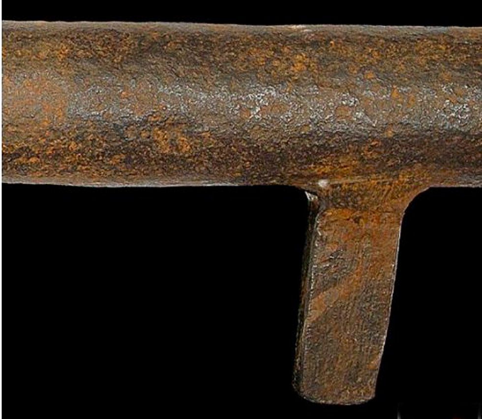

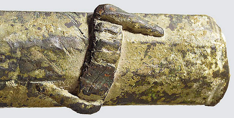

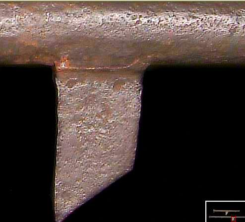

One last point: hooks, their shape, size and position also play a minor role in dating barrels. When an early barrel features a hook fixed with a sleeve over the barrel this may mean that the hook is a later addition. As stated, hooks normally appeared in the 1430's and were fire-welded integrally to the underside of the the barrels, their position varying from about the midst of the barrel to right beneath the muzzle. Earliest hooks are mostly rather small and triangular, but the correct interpretation of this definition requires a whole lot of experience. Hooks on tiller barrels are not normally pierced; when they are, it was usually to move them suspended on a stable pin, a tripod or a triangle for easier management in firing. On barrels that originally were fully stocked, the hook was often pierced to use it as one of the loops for attaching the stock by transversal wooden or iron pins. On heavy pieces, these pins mostly consisted of iron or iron nails.
Hooks on bronze barrels were cast integrally, mostly of flat rounded shape and often staged, structured and segmented. On the latest bronze barrels of the 1530s, hooks sometimes are placed backwards as far as the middle of the barrel. Interestingly, hooks were attached at the center of gravity of the barrel.

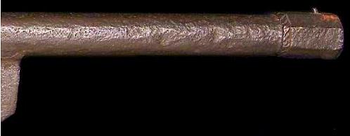

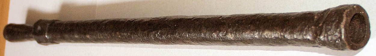

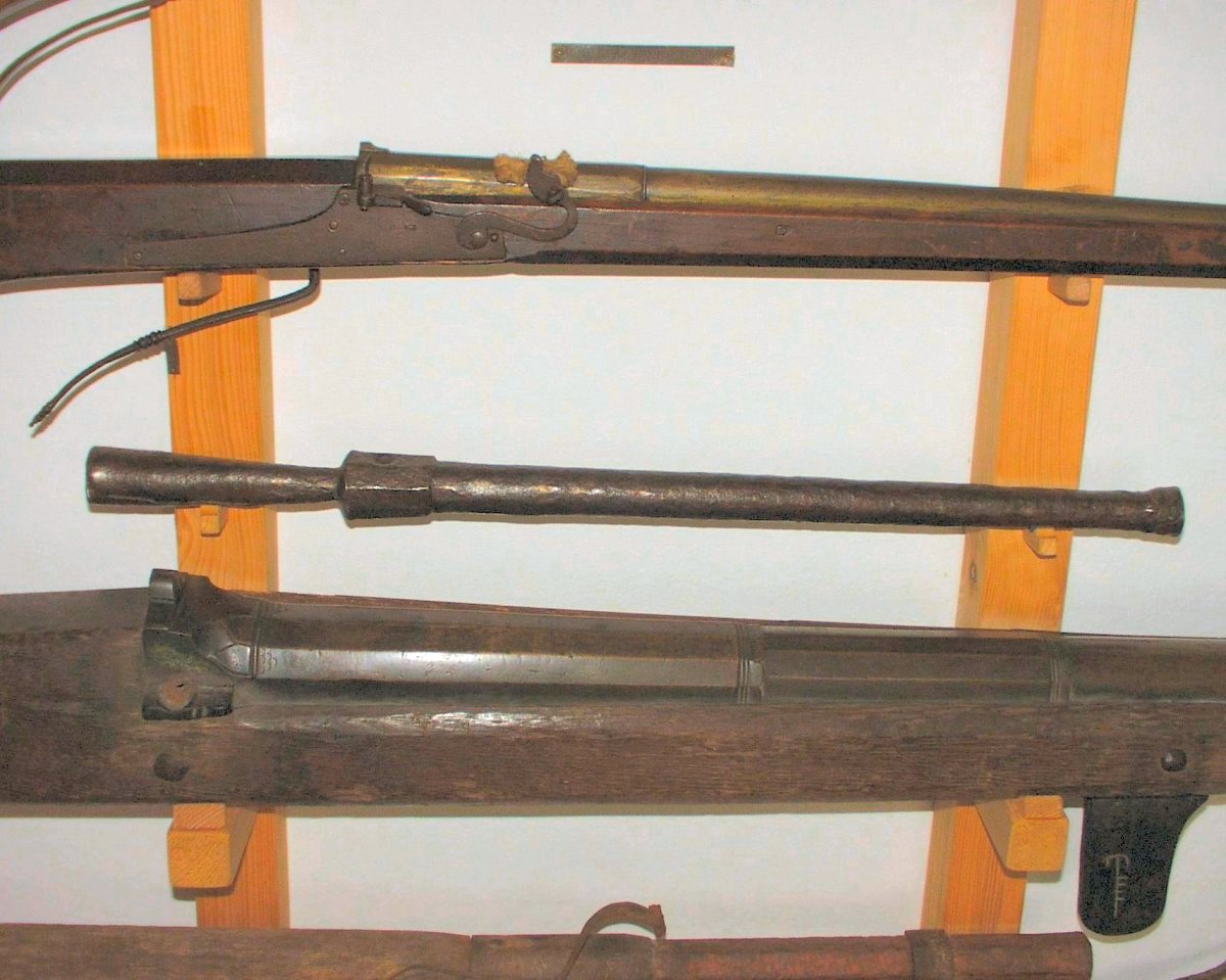

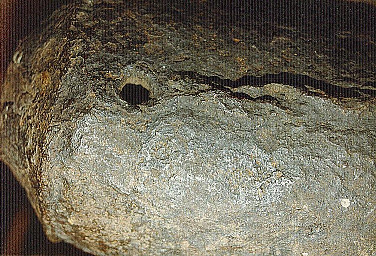

- overwiew of the row of earliest wrought-iron barrels in my collection, from the left:
- Aljubarrota barrel, ca. 1360-70:
http://www.vikingsword.com/vb/showth...on+hand+cannon
http://www.vikingsword.com/vb/showth...ht=aljubarrota
- octagonal barrel with alternatingly broad and narrow flats, retaining one of its originally two iron bands for fixing the barrel to the stock, with some small nails still preserved; excavated from brickearth in the Hürtgenwald woods, Eifel, West Germany, in the 1960's, the second iron retaining band and the stock were left in the ground!
- foreground:

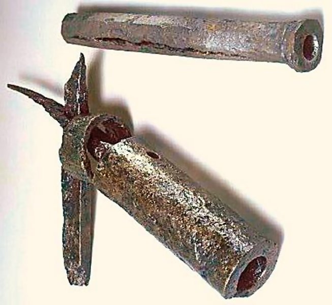

two small handcannon barrels, the left hexagonal, the other octagonal, ca. 1400
- background:

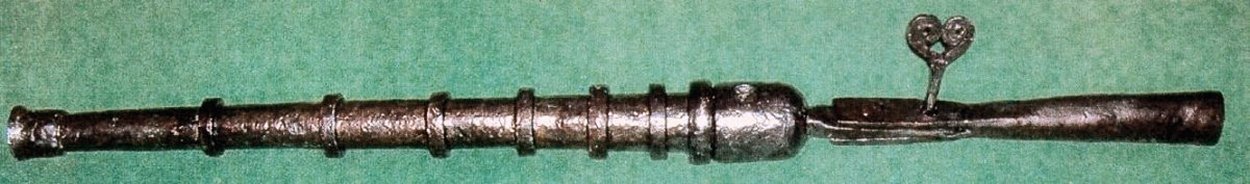

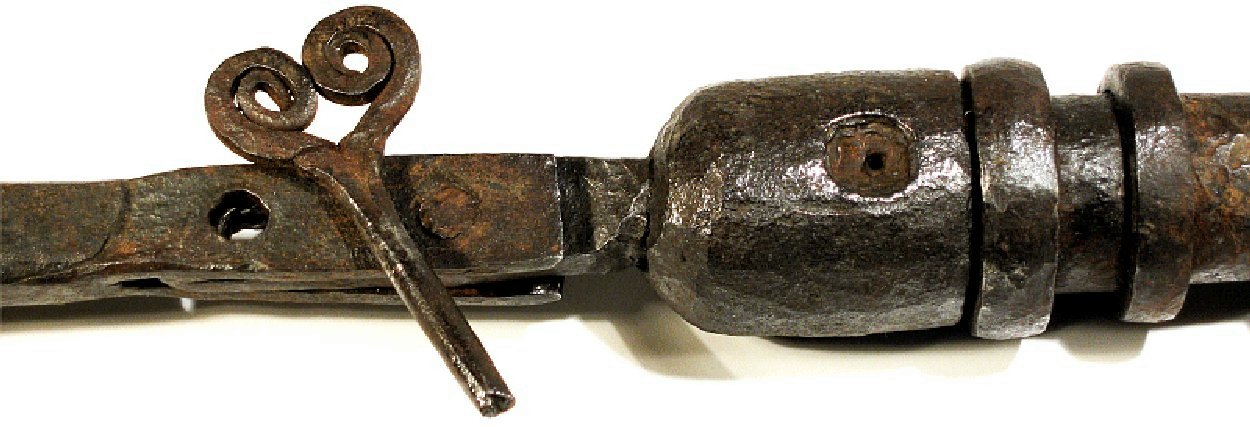

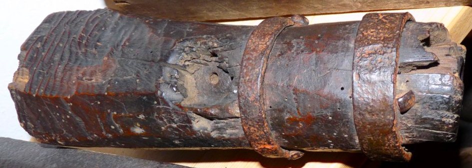

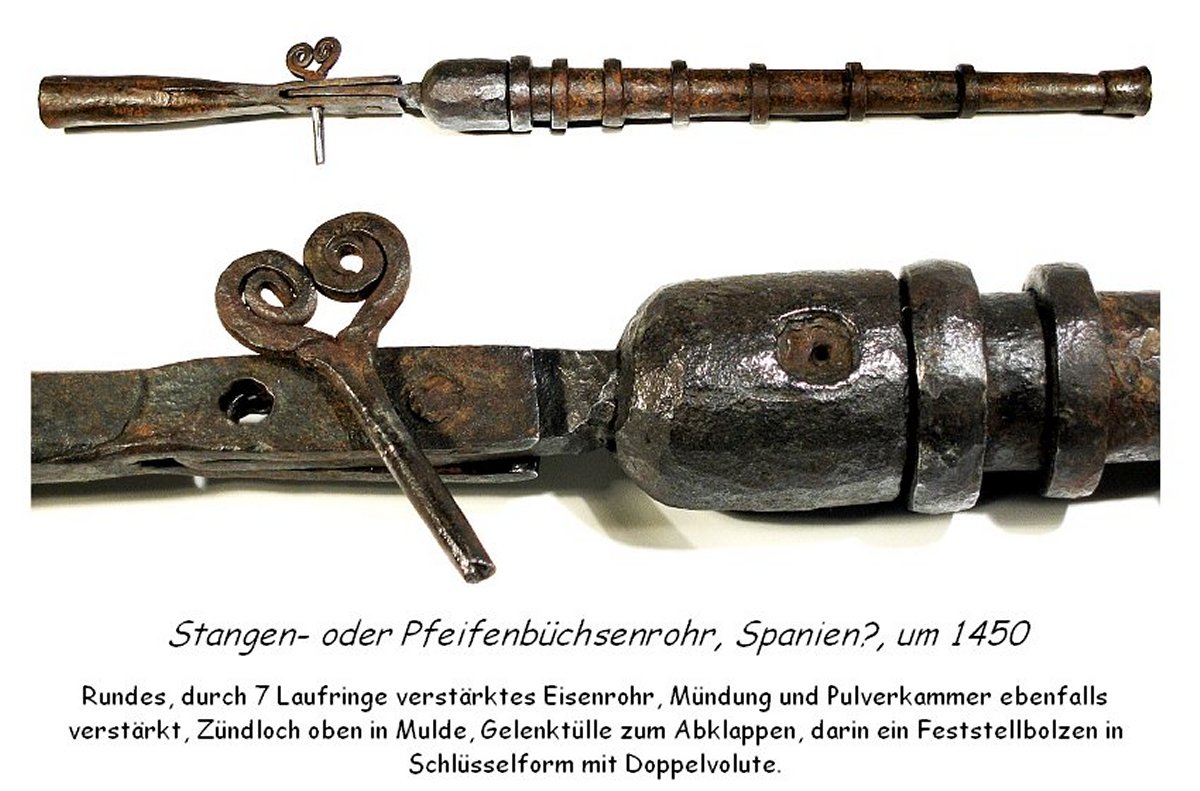

two more, one octagonal, the other round and with three rings for reinforcement, ca. 1400
- heavy, round barrel of hand cannon, early 15th c., found together with two iron balls (all retained), the massive barrel walls interestingly burst and deformed both left and right to the muzzle
- exact copy of the so-called Tannenberg gun in the Germanisches Nationalmuseum Nürnberg, a lightweight bronze barrel finely wrought, filed and in two stages, octagonal with shifted flats at about 40 percent of its length, bell-mouthed muzzle. This direct comparison with barrels of ca. 1400 makes it perfectly clear that the Tannenberg barrel cannot be 'pre-1399' but should be dated correctly ca. 1440-50!
http://www.vikingsword.com/vb/showth...ght=tannenberg

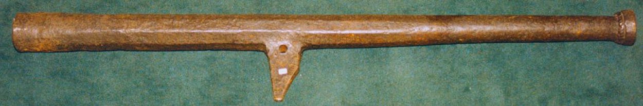

- two extremely rare, long and heavy octagonal wrought-iron barrels with hollowed predecessors of pans around the big touch holes, for attaching a priming mass - see explanation to my my barrel dated 1481 above; certainly from multi-barreled gun arrangements (see following attachment); ca. 1470-90:
http://www.vikingsword.com/vb/showth...t-iron+barrels

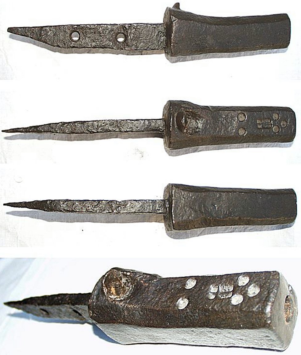

- a singular and important small handgun, ca. mid-15th c., the octagonal barrel retaining its original limewood stock fixed by two iron bands (now loose) showing remains of red lead minium paint, in the rear center of the stock a movable iron ring for attachment to a wall; most interestingly, that gun was ignited with an igniting iron or a linstock directly into a hollowed touch hole in the center of a deep hole within the surrounding limewood!
- an extremely rare small alcove cannon (German: Nischengeschütz) retaining its original oaken block stock and fixed to it by an iron ring that is secured to the underside with two big female screws; the round barrel a shortened and re-used iron tiller barrel, ca. 1440, tapering towards the rear end; the shortened tiller pierces the stock and is secured by a third female screw:
http://www.vikingsword.com/vb/showthread.php?t=18049

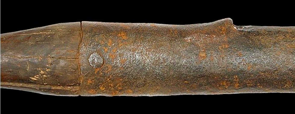

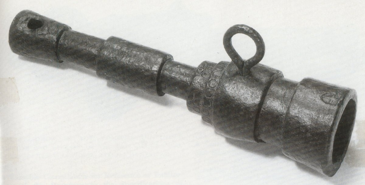

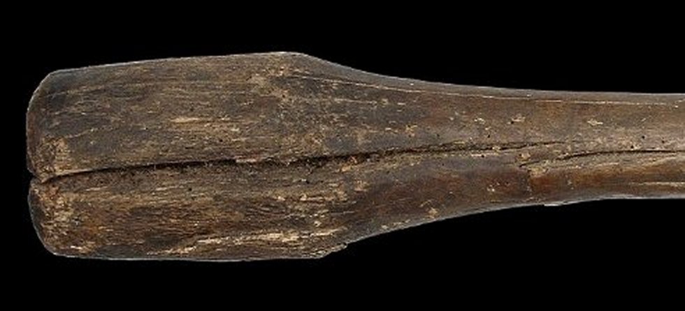

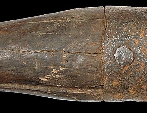

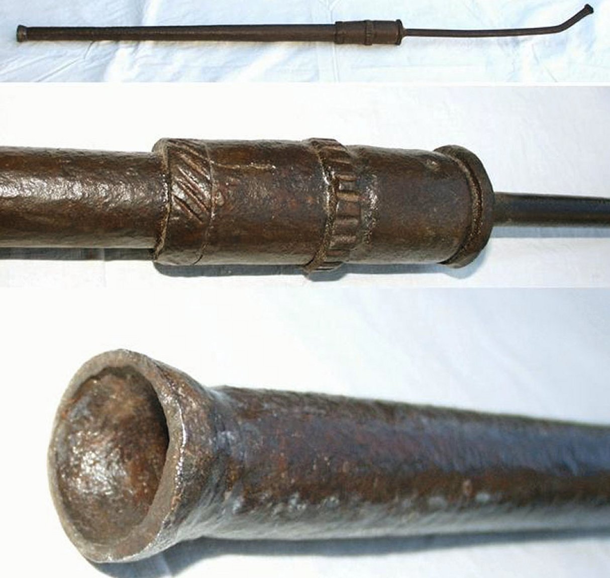

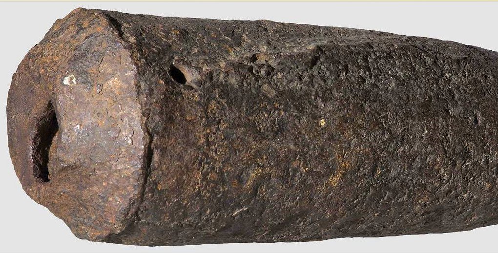

- the Aljubarrota barrel revisited: details of the wound band-iron structure, the touch hole and the small arrowhead mark in front of it
- the little round handcannon of ca. 1400 with reinforcing rings

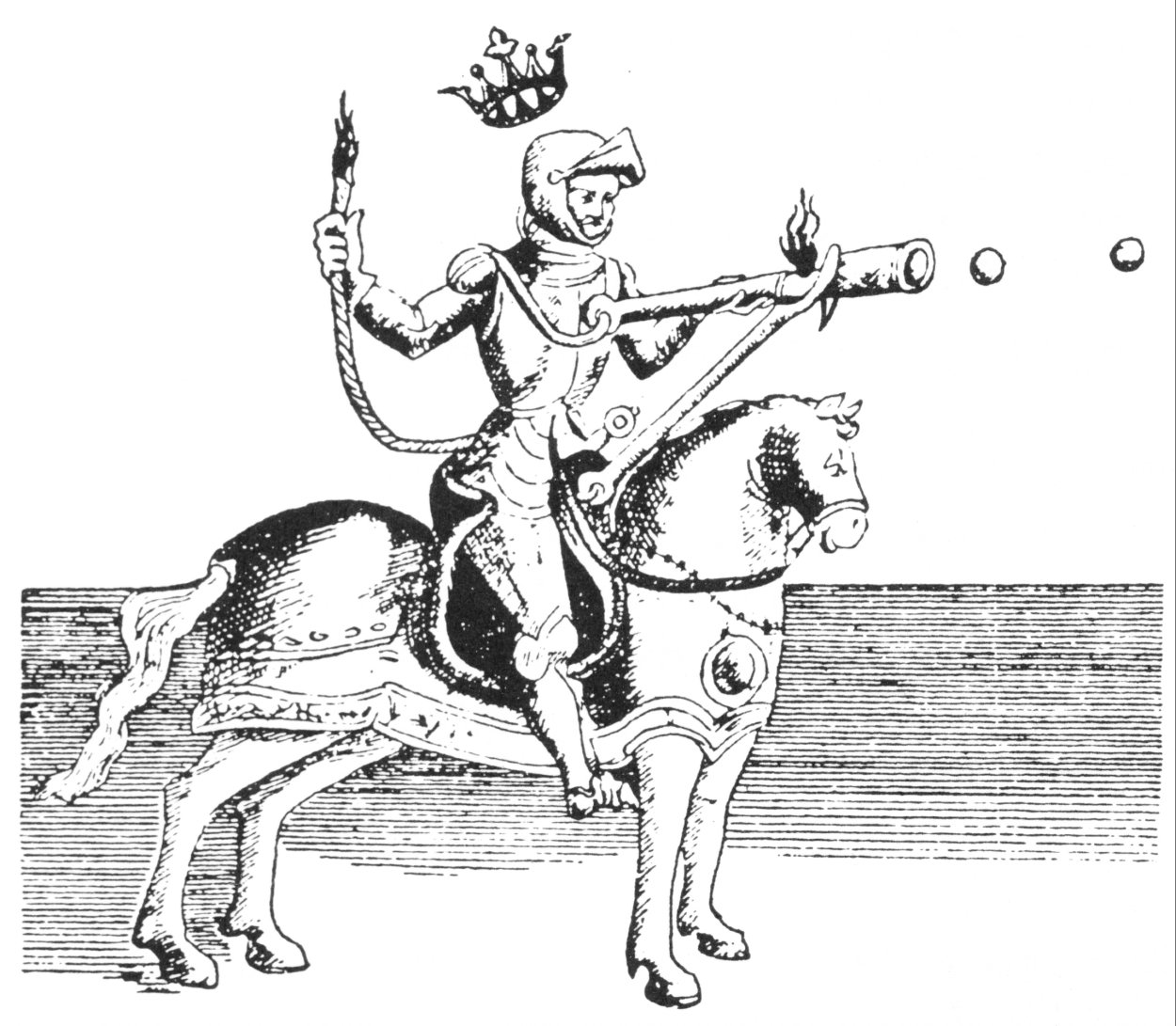

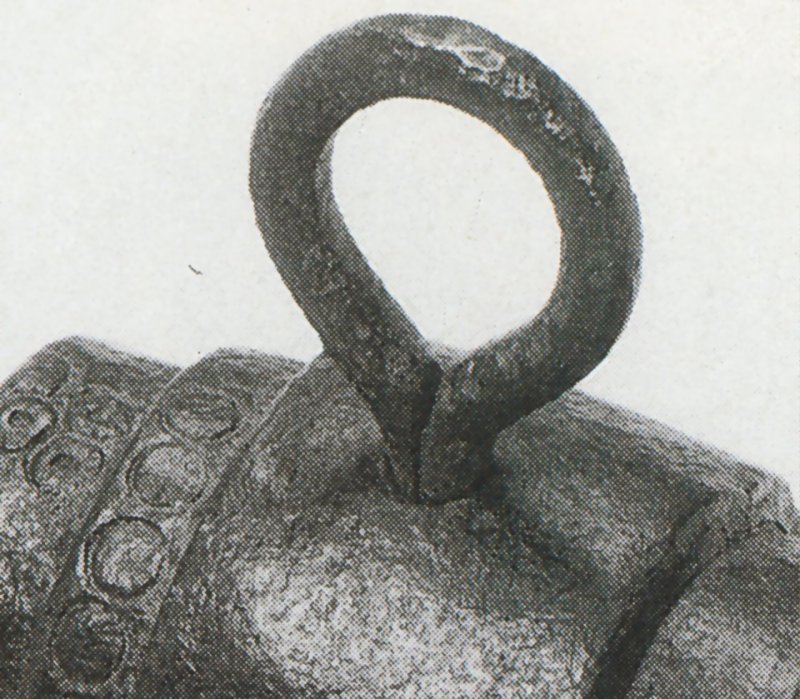

- source of period artwork to that little rond handcannon barrel of ca. 1400: a depiction of a baptismal font, ca. 1400-20, Prague

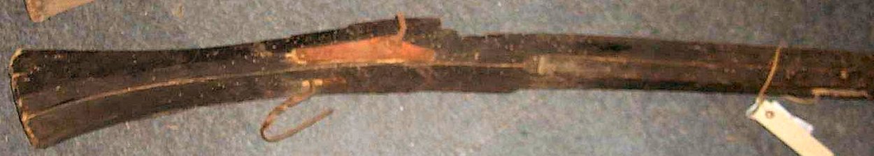

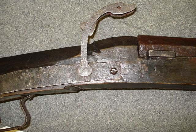

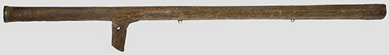

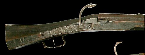

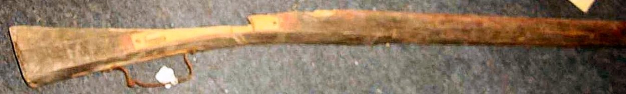

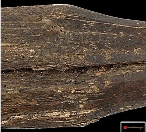

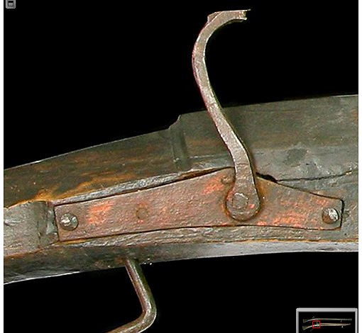

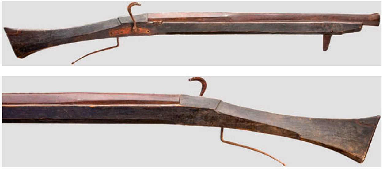

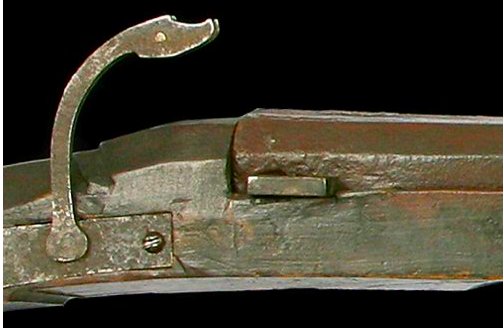

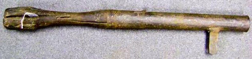

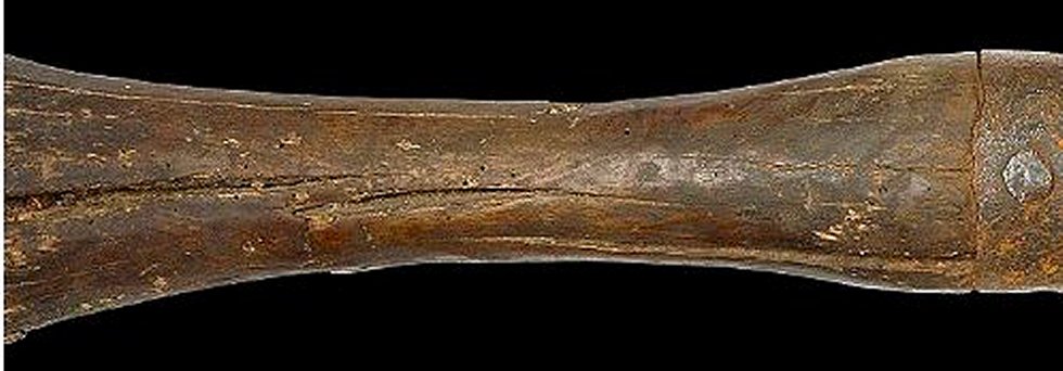

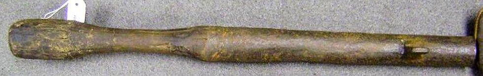

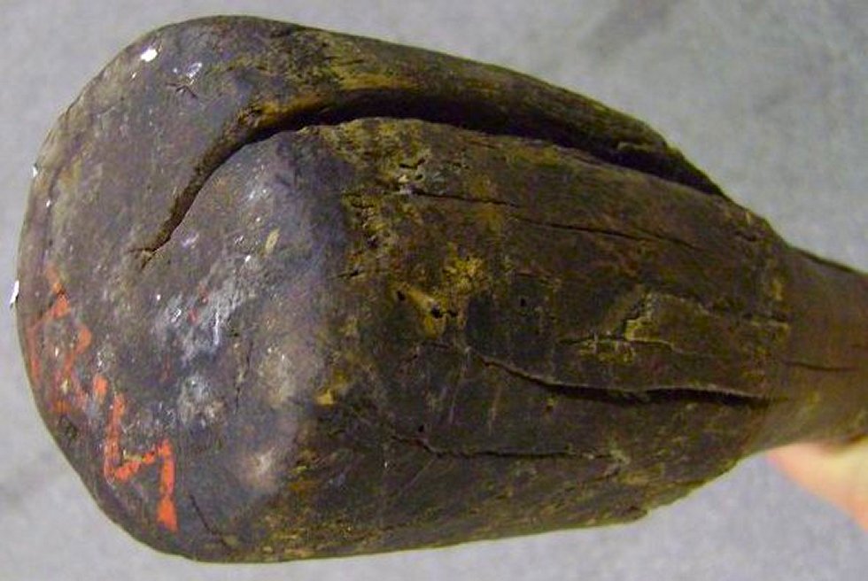

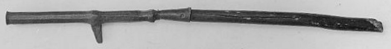

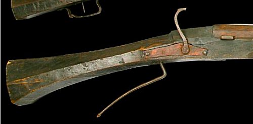

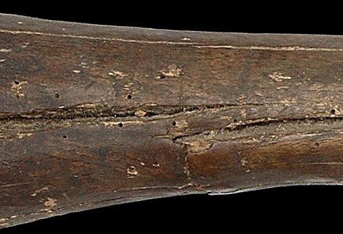

- a singular, highly important piece: the oldest-known complete long gun in the word, ca. 1400-10, a High-Gothic tiller gun with oak stock, socketed hexagonal barrel retaining its original red-lead minium paint, primitive spring-loaded match holder and small slipped-on recoil hook (both working-time additions of ca. 1430):
http://www.vikingsword.com/vb/showth...andgun+1400-10
- exact representation of such a gun dated 1411: Johann Hartlieb: Kriegsbuch, Austrian National Library Vienna, cod.vind. 3039, fol. 38v
- from the same source: the use of superimposed loads! for such guns, fol. 11r

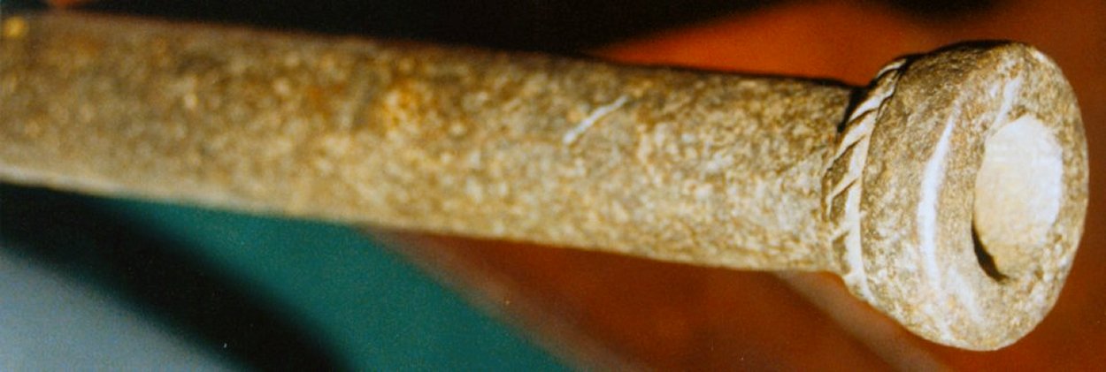

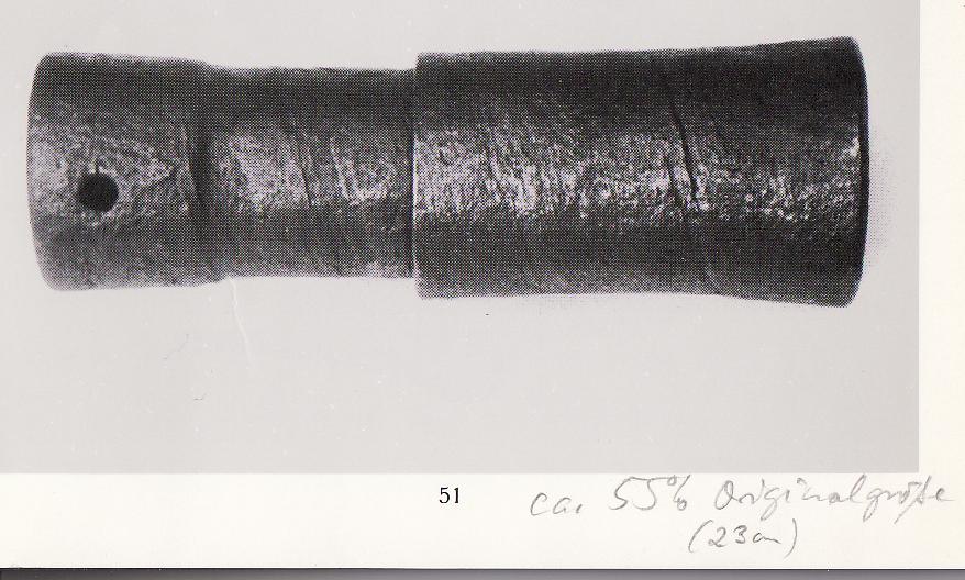

Old 17th January 2014, 04:26 PM   #4

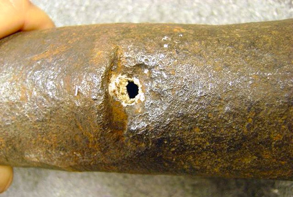

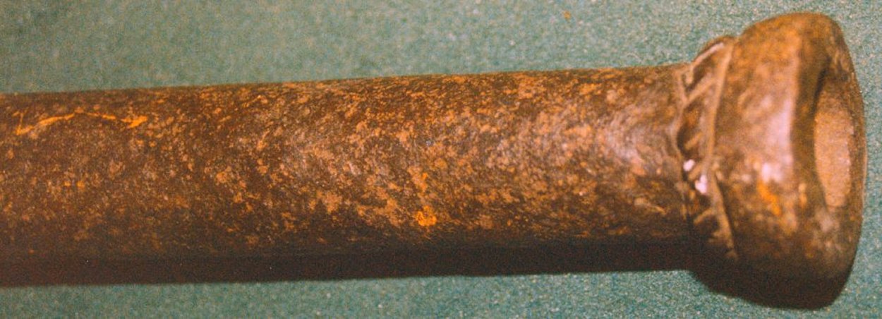

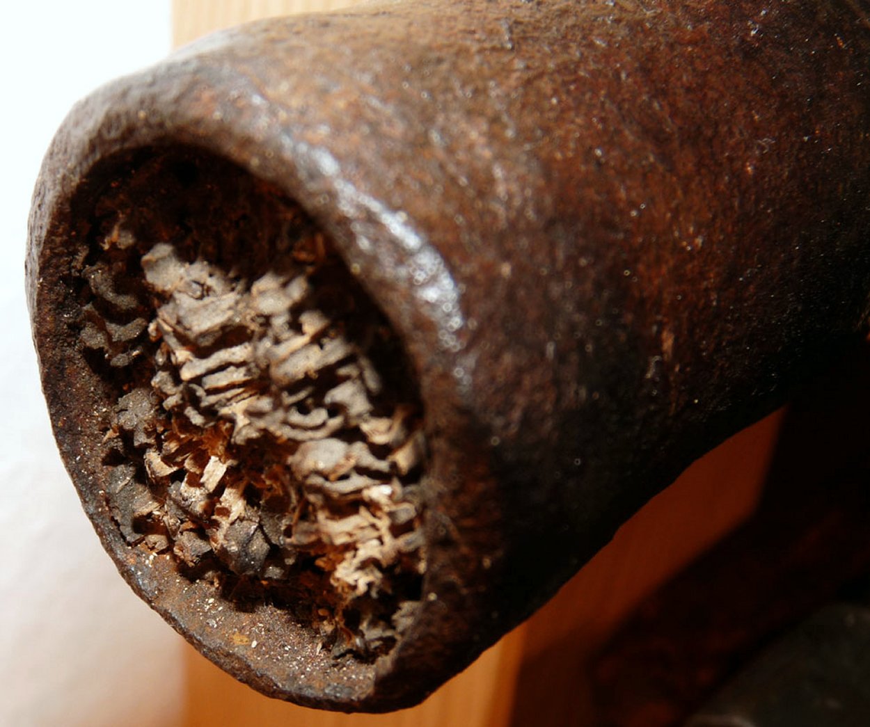

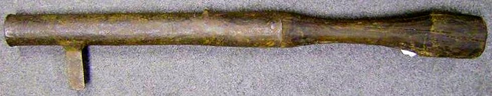

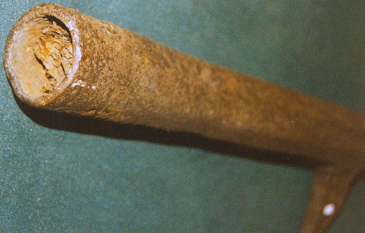

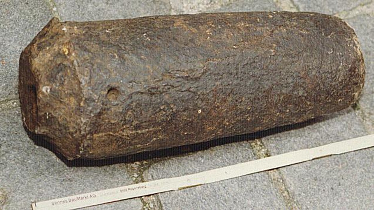

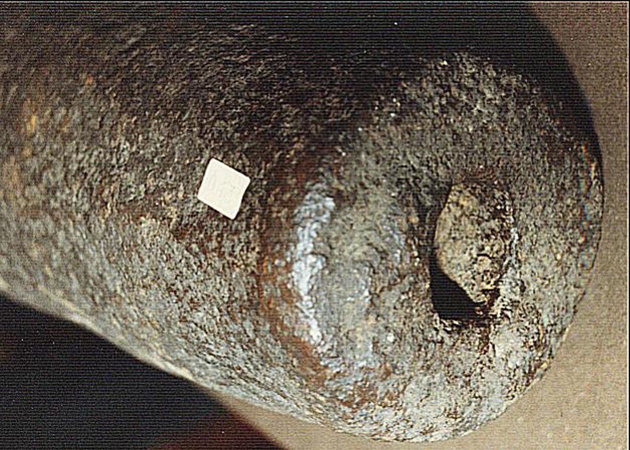

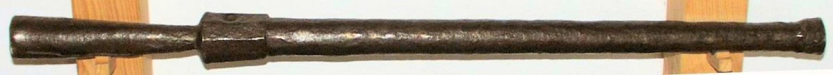

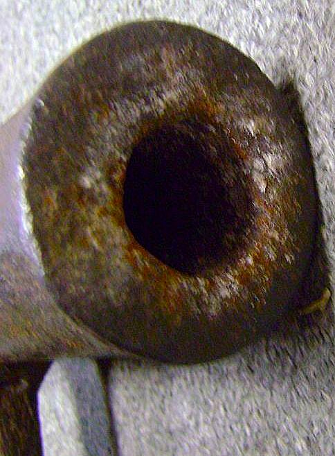

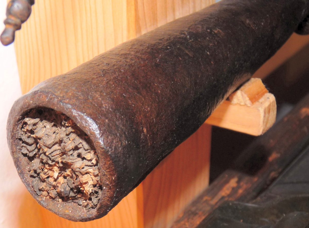

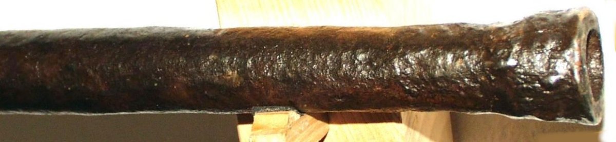

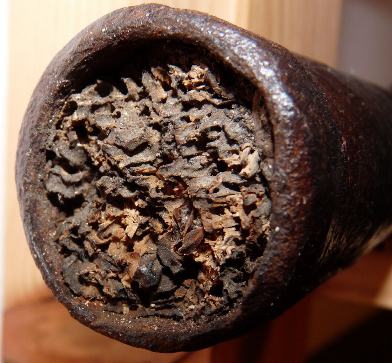

... 'Nando, my dear friend,
could you please check the bore of your barrel whether is has been drilled, if it is also of irregular diameter at the barrel walls, and if the drill has left a pointed mark on the bottom? ...

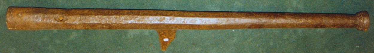

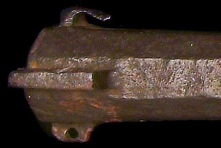

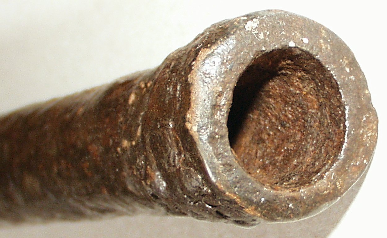

Hi Michl,
I can not be exact in stating whether the walls are irregular in the context; thty don't look smooth, but that can be rust. However definitely there is no drill point mark in the bottom and the circumference at the said bottom looks to me a little irregular .
Difficult to take pictures of a barrel interior, for a non expert like me, with a basic digital camera .
Old 17th January 2014, 04:42 PM   #5
Matchlock
Matchlock's Avatar
Join Date: Sep 2008
Posts: 4,310
Great image, 'Nando, thank you!
It looks as if the bore of your barrel has not been drilled out.
Could you perhaps take its weight?
I added pictures of my barrel with eight alternatingly broad and narrow flats, and retaining one of its originally two iron bands; I will take its weight tomorrow.
Michl

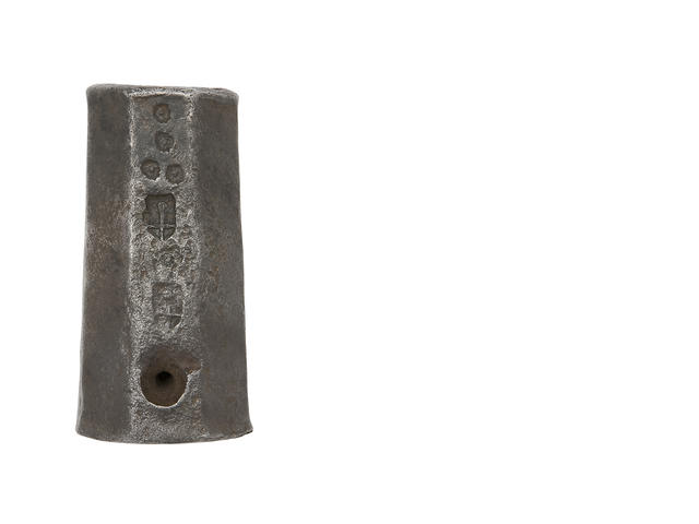

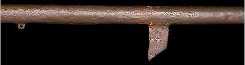

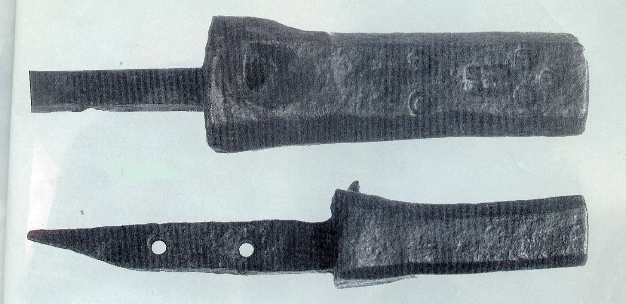

- my three Nuremberg haquebut barrels from the Fortress Oberhaus, Passau, all preserved in pristine condition, retaining their original red-lead minium paint beneath a later coat of black arsenal lacquer;
from top:
- ca. 1460-70

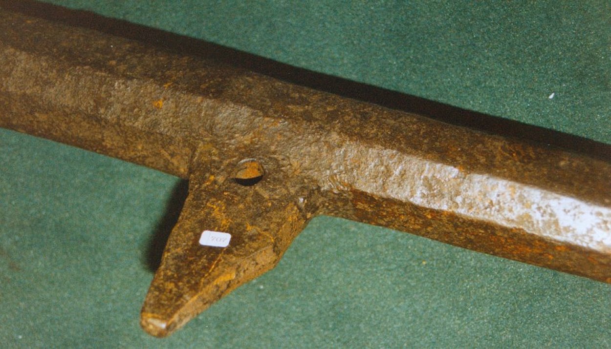

- dated 1481, the world's second oldest dated barrel, struck with the earliest known Munich town mark, the Münchner Kindl (the Munich Kid), according to Erasmus Grasser's design of 1477

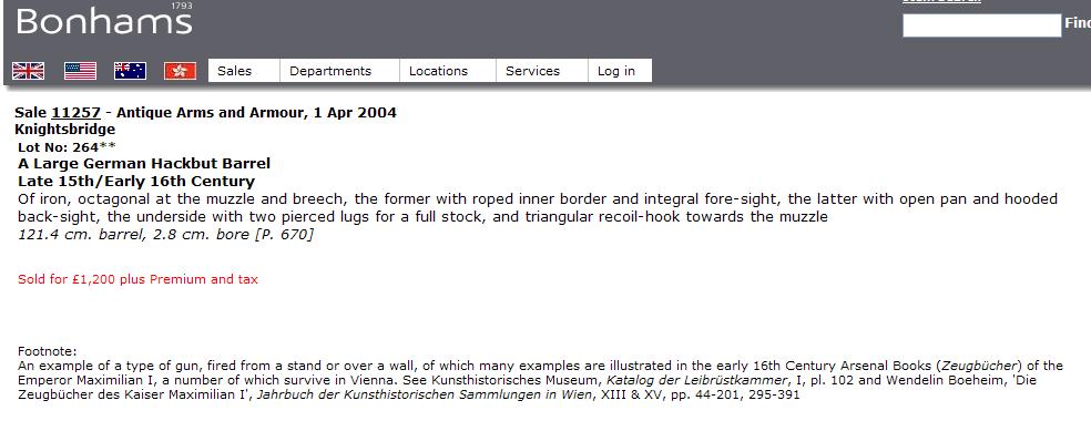

- ca. 1490-1500, from one of the Maximilian Tyrolean arsenals, with huge touch hole and 'Maximilian' style crown's head muzzle section accentutated by a roped frieze; the original rear socket for a tiller stock shortened and prepared for a full stock
- another, from the very same Nuremberg series, retaining its original socket and octagonal oak tiller stock, preserved in the reserve collection of the Gäubodenmuseum Straubing, Lower Bavaria

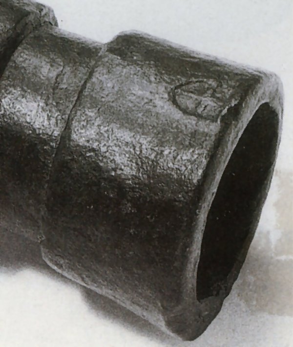

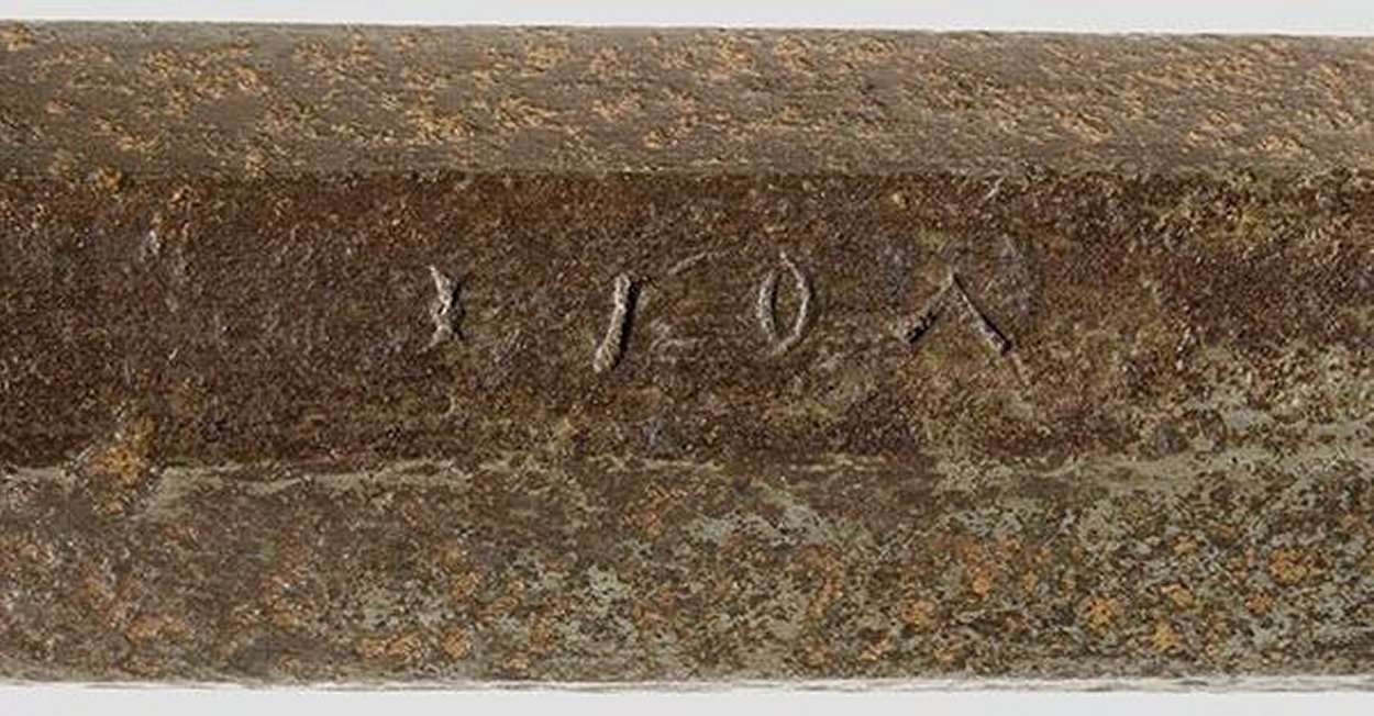

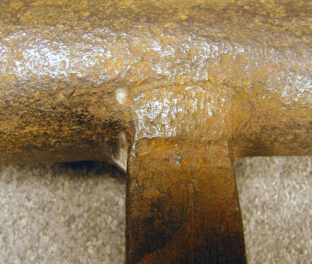

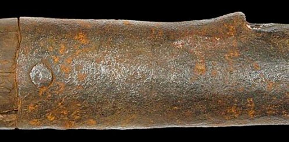

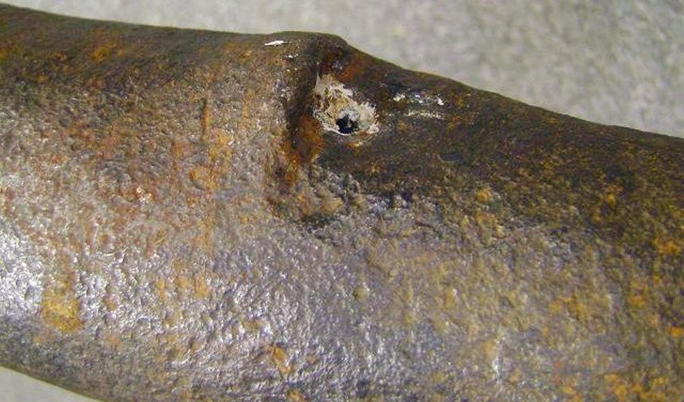

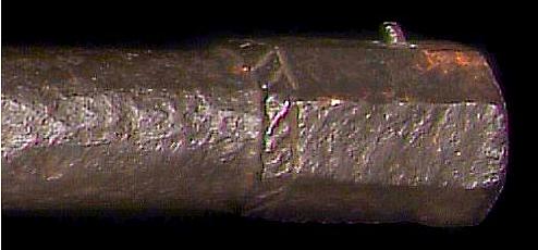

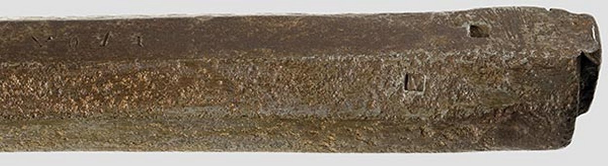

- my highly important historical Passau/Munich barrel dated 1481, with the oldest known fully developed block rear sight, and struck with the earliest known Munich town mark, the Münchner Kindl, according to Erasmus Grasser's design of 1477; underneath a black coat of 17th or 18th c. arsenal lacquer this, like all three of my Passau barrels, retains its original Gothic red lead minium paint! Please note the bell-mouthed muzzle.
http://www.vikingsword.com/vb/showth...highlight=1481
What is most interesting about this and two other historical pieces bearing the same date and still preserved in Passau: together with others (a fourth barrel struck with the date 1481 is preserved in the arsenal of the Fortress Coburg, Northern Bavaria), they were bought by the Passau arsenal in the Fortress Oberhaus, situated high above the city of Passau and never taken, in 1481 when two rivaling candidates, Georg von Hessler and Friedrich Mauerkircher, ran on the Passau prince-archbishopship. In 1482, these haquebuts saw service when parts of the city of Passau lay under heavy fire from the Fortress Oberhaus! And one of them is in my collection 533 years later - imagine!

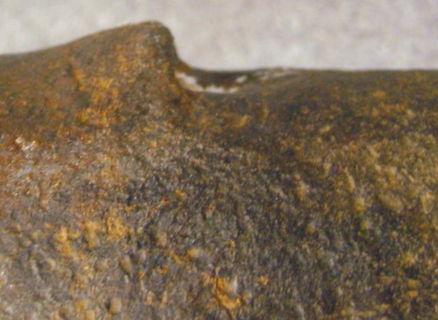

More close-ups of my 1481 barrel.
This dated piece is an important anchor point for dating barrels of the second half of the 15th c.!
Old 17th January 2014, 06:15 PM   #9
... Could you perhaps take its weight? ...
This beast weighs 7,4 Kgs. with its 23cms length and 33 m/m bore.

I was aware that there are hand cannons from such period being connotated with this battle.
So:
I once paged a little book called Prestige de l'armurerie portugaise. La part de Liege and, there it was, in page 42, a hand cannon quoted as having been found on the Aljubarrota battle field.
After reading this, i reached contact with Lt. Colonel of Artillery Nuno Rubim, a person recognized for his expertize in this field by his pairs, who had written an article called (from the portuguese): About the technical possibility of the use of artillery in the battle of Aljubarrota ... ofwhich i will here attach the link for a humble translation ... appologizing for the possible repetition .
The following was his answer to my question:
In the various survey campaigns in the Aljubarrota field never any trace of light fire weapons was found. And there were several (surveys), the last one carried out under the auspices of Professor Gouveia Monteiro, from the University ogf Coimbra whom, about them wrote a work.
In fact neither was referenced any (heavy) artillery fire mouth, which raises lots of doubts about the fact that there may have ever appeared any example there. But i totally believe on what Fernão Lopes (*) wrote... as i let it clear in my article.
On the other hand i only have documental references about the use of light firearms in Portugal by the middle XV century.
(*) Fernão Lopes (1380/90-1460) was the chronicler who mentioned the presence of 16 trons (onomotopaic name for bombards) brought by the Spaniards and even used in the famous battle.
After facing this apparently solid information, i enquired the author of Prestige de lármurerie (Rainer Daehnhardt), asking him how certain he was of any evidence of the use of hand cannons in Aljubarrota. He answered by saying that the evidence was the logic that, portable artillery out to have appeared practically at same time as heavy one, so surely it was present in that battle.
Having said all the above, it is up to us to choose the side to which pend in this story.
Note, Michl:
I am not at all pretending to question this specific topic in the contents of your study : i have once made this little research concerning only the provenance of my own cannons .
Do you also know an other book where the Aljubarrota barrel(s) have been published?
Paddy T. is offline   Reply With Quote
Old 15th February 2018, 05:12 PM   #13
Welcome to the forum Paddy.
The only other quotation on Aljubarrota barrels is that mentioned in post #35 of this thread, which is published in "Memorial das Peças de Artilharia do Museu da Marinha". However as it is assumed by its author, this example, as well as the one published in "Prestige de l'Armurerie", may not be considered factual evidence. I am afraid that the naming of Aljubarrota may only be seen with a symbolic connotation.

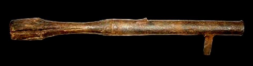

As i like to raise this thread from its depts from now and than, i present this (for me) unknown hand cannon, dated! 1485 (?)
If anyone has better pictures of this piece and its whereabouts i would be greatfull.
Auction description:
A Rare Wrought-Iron Hand-Cannon
Possibly 15th Century
Of waisted cylindrical form reinforced at the muzzle and breech, the former struck with a mark between the date 1485 and inscribed 'INII' above, the latter with recessed touch-hole with remains of lead lining, the mid section inscribed 'Taufers' and numbered '16' (rust patinated overall)
24 cm. high, 4.3 cm. bore
FOOTNOTES
Provenance:
Acquired in Basel, 1960
The inscription presumably refers to Schloss Taufers which is located in the South Tyrol
