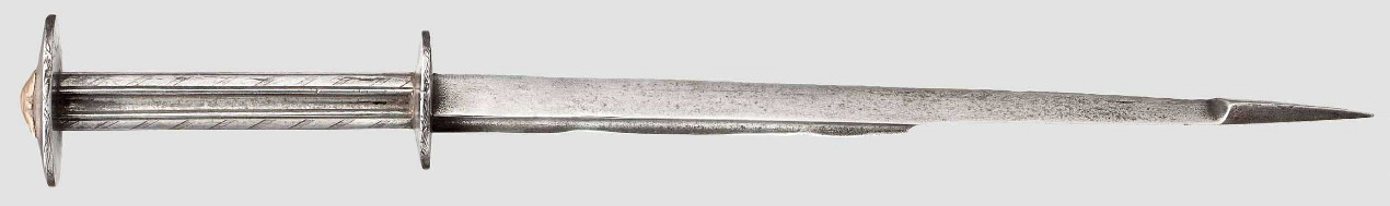

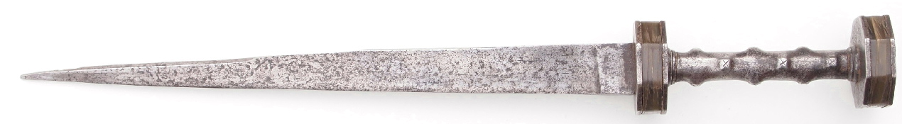

All the following Daggers were sold at Auktion.

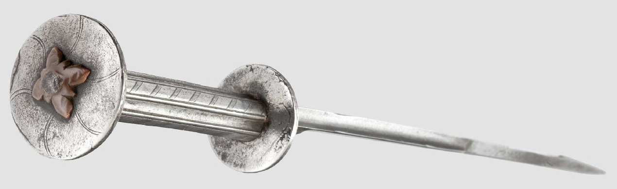

Rondel Daggers, second half of the 15th century.
Sorry, the first is the same as in Matchlocks thread, but my thread was already prepared some weeks ago.
But with the discussions about daggers in the other threads, its now the right time to publish it.

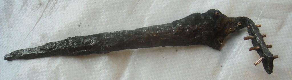

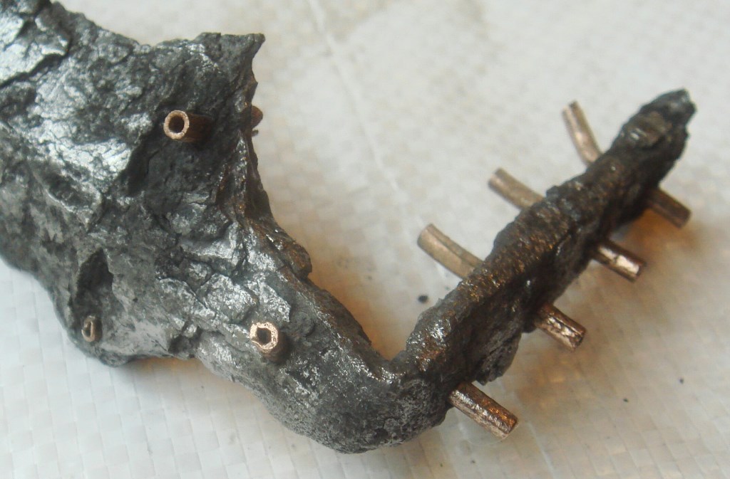

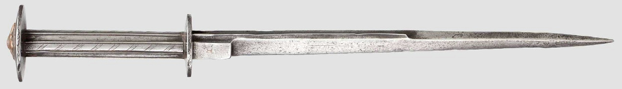

Antenna Dagger c.1400
Unfortunately I have only found an excavated example, but nevertheless interesting.

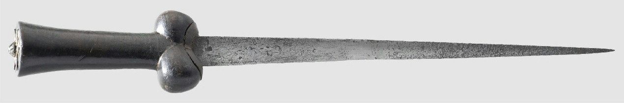

Ballock Dagger c.1500

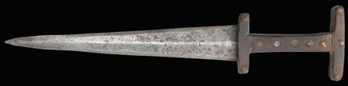

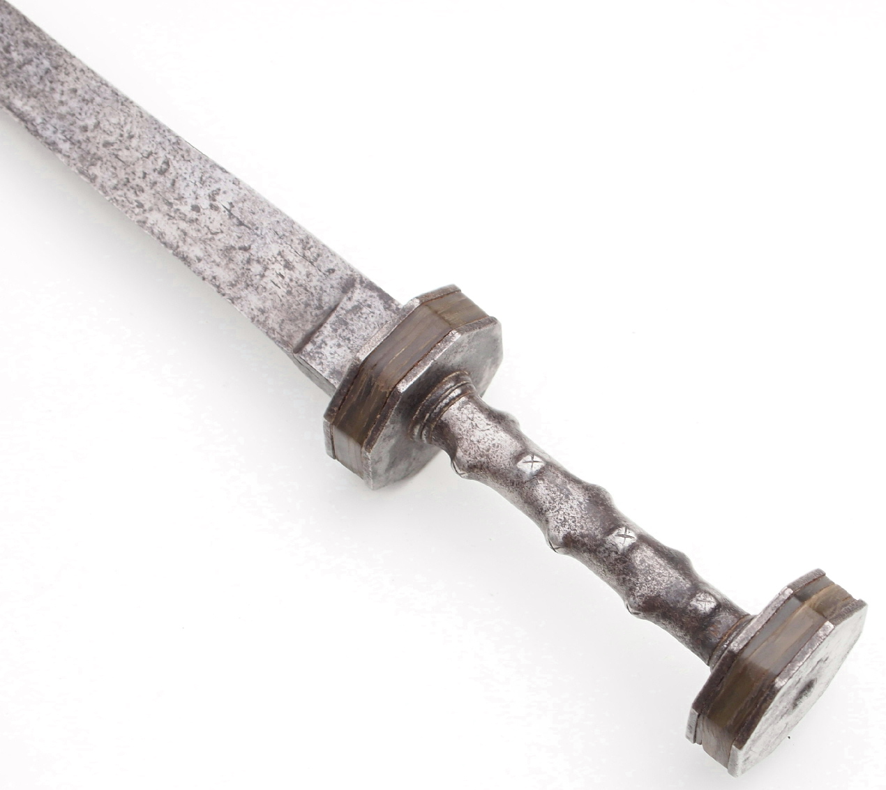

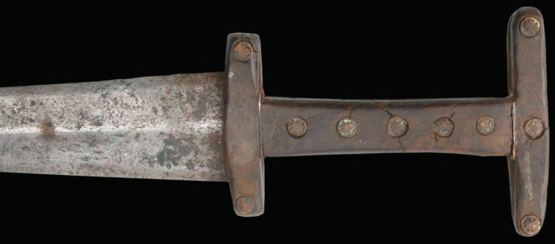

Baselard , North Italy or South Germany,14th century.
The rivets stamped with Maltese Crosses.

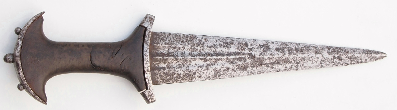

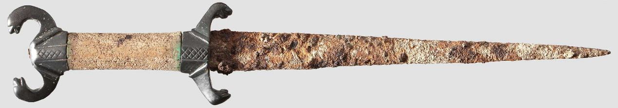

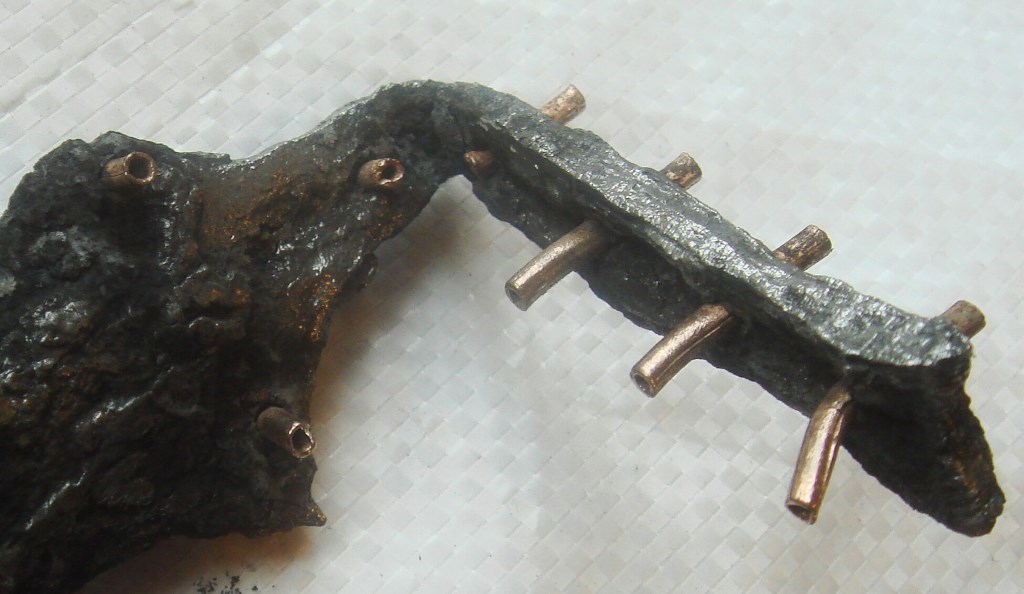

Dagger, South Germany,14th century, wrongly called 'Schweizerdolch'.
Also the two nails, which fix the grip, are most often wrongly called rivets, rivetting is a completely other method of fixing something as with a nail!
