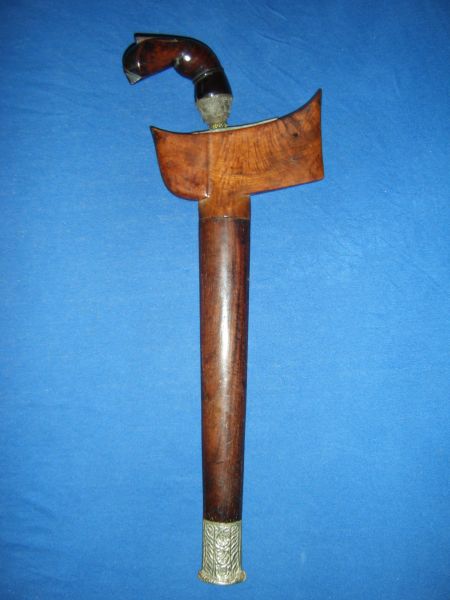

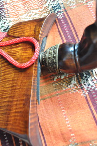

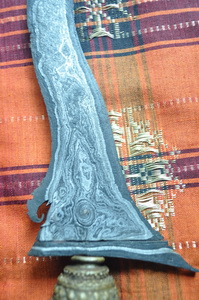

A keris from Sumbawa. The silver fittings with the twisted wire works are typical of the region, but not too gaudy. The hilt too, has motifs quite distinct from the Riau or Sulawesi Bugis. 15-waved blade, which seemed quite common in Sumbawa. Tough blade, with pretty tight adeg like forging lines.

Thanks Kai Wee. A beautiful and elegant keris.
Old 8th June 2009, 01:41 AM   #4
A very nice blade in a good sarung.

Very sophisticated indeed Kai Wee, thanks for showing this one. Does anyone else have examples from this island to show?

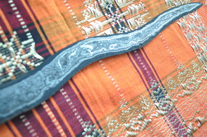

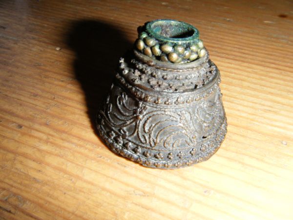

Another Lamba 15 from Sumbawa
Pangulu : Duyung / Sea Ivory
Kili-kili : Silver
Wanua : Kemuning
Pamorro : Ure Tuo

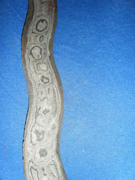

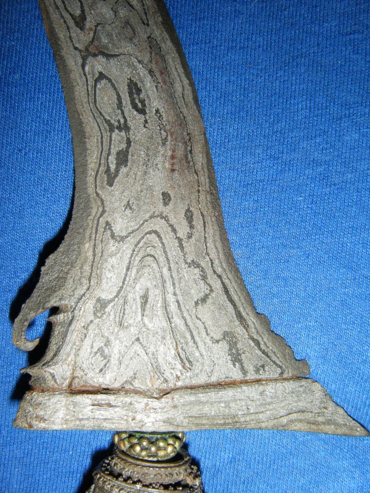

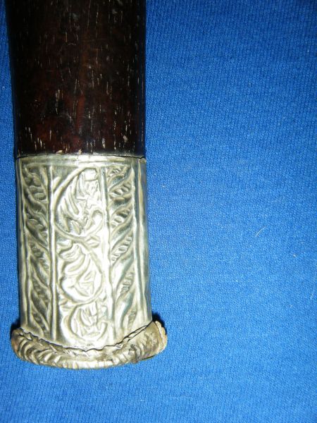

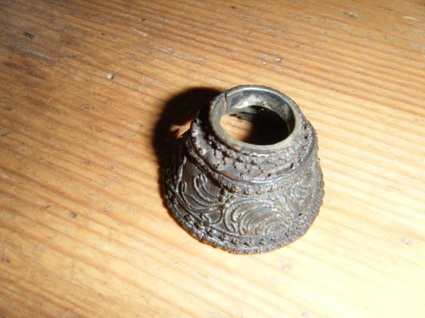

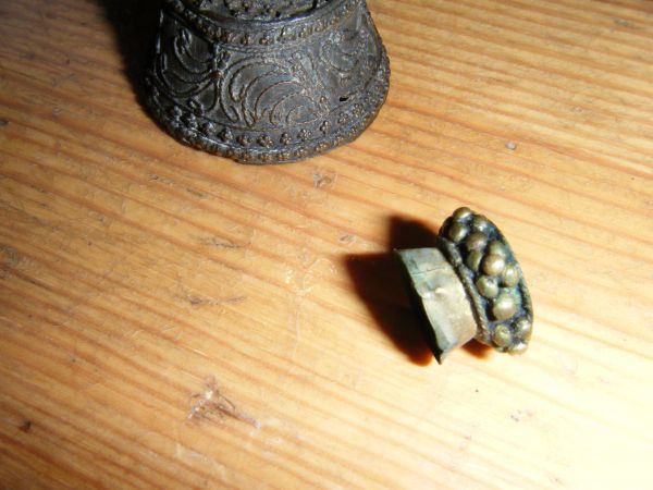

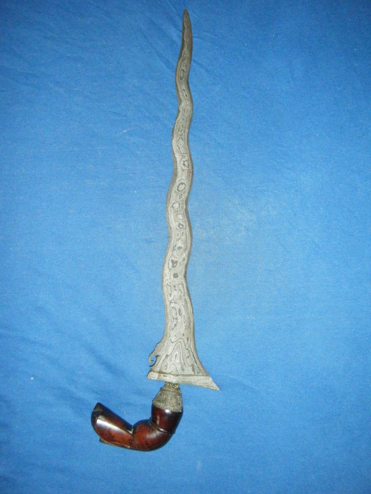

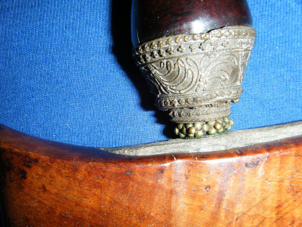

Old 28th September 2009, 09:46 PM   #9
Gustav
Join Date: Jun 2009

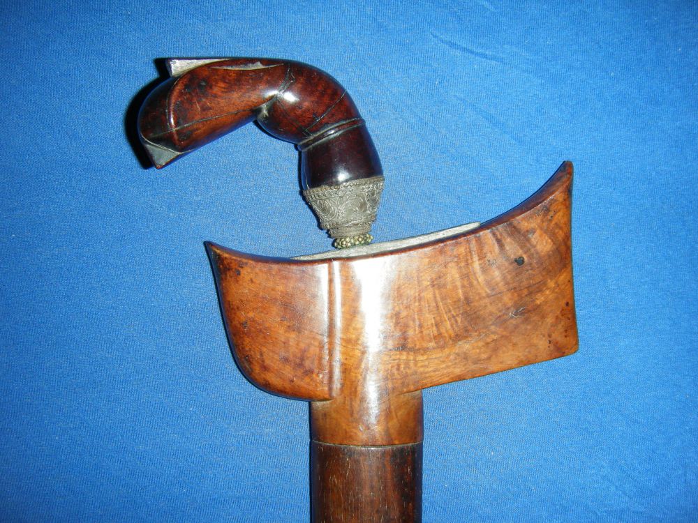

Posts: 1,346
Thank you Sajen.
It is of much less quality then the beautiful keris of Blu Erf and Sipakatuo, but this porous iron is typical for "lower end" Sumbawa keris,
thats why I posted it.
I also apologise for the very poor quality of pictures. The keris is also not stained, so even the low contrast pamor of this blade isn't visible in the pictures.
Some pictures of similar Sumbawa blades. These keris are not mine, so only detail pictures.
