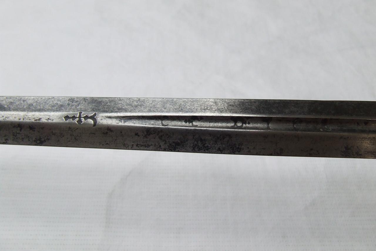

Hi there,
i found some days ago an intresting indian Patasword with an narrow european Blade. at both sides from these blade are tradestamps or makersmarks without an name. have someone an idea from where these blade comes or in with time these blade was made?
unusual for me is that it is an narrow blade , only 25 mm wide.
i never saw before such an narrow blade in an pata sword. but i think that it is an old marriage and only an idiot did sharpened the edges with an grindling machine. i think that the blade wasn´t changed in its shape.
i´m curious about your opinions!

here are some pictures from an other pata sword ..,
these blade is marked with an running wolve and some letters.
i wonder how was these letters read? are these letters only symbols, or religius characters?
also intresting is if the running wolve was in an wrong direction stitched?
i asked in the solingen sword museum in the hope that they could tell me something more about the history from these blade but i received only a short answer that it is an solingen blade from the 17.th.ct. they couldn´t tell me something over the sinn from these letters.
have someone an better idea?
i don´t believe that it is an indian blade with wrong marks, but the indian swordmaking history is full of surprices.
dralin23 is offline   Reply With Quote
Old 24th January 2020, 10:49 AM   #9
The marks on your blade are one of the various misspelled initials of "In Nomine Domini" and would mean " In the name of the Lord (God)", an ancient Catholic expression; actually the title of a Papal Bull in the year 1050. You often find this in European blades; a subject also often discussed here in the forum-
Old 24th January 2020, 02:30 PM   #10
dralin23
Join Date: Dec 2006
Posts: 214
hello fernando,
thank you for these information!
I also thought it that way when I read the letters on the blade. but if i read this combination of letters like this then the running wolf would have been hit the wrong way round in the blade. so he would be lying on his back. the other way around, the letters would make no sense. the running wolf also looks authentically real to me and not like it was hit afterwards. we can only speculate about why and why.
Supposedly when the blade smiths of Solingen put the wolf of Passau on the blades, they put them upside down compared to any text. So the wolf mark on your blade shows it’s made in Solingen. It’s beautiful.
