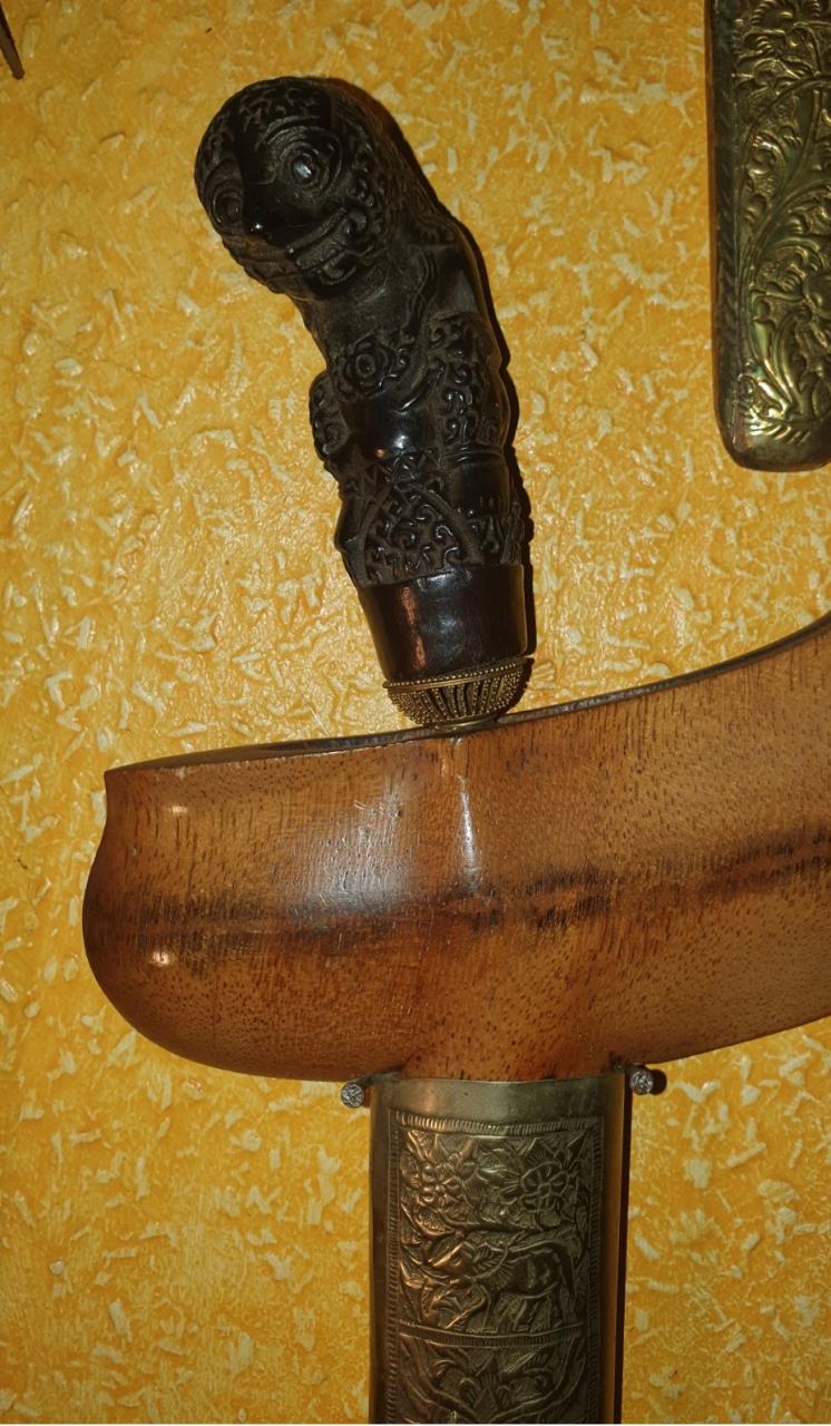

I bought this Keris from a colleague he inherited together with some other Tjikeroe knives and Golok from his deceased father in law who was stationed in Indonesia just before the war. I found this Keris appealing to me despite the relatively thin blade. (Not super thin) I don't know the Dapur and the ganja is in a form I have not seen often. The dress is relatively simple and plain and does not fit very good inside the Warangka but the ganja is of nice proportion with the curled up grening. I guess the mendak is a cage mendak from West Java if I am correct.
Who can share some more info about it. I thi k it has 7 Luk

Yes Martin, i also believe that it os worth preserving some keris even when they are very worn. I look forward to seeing this blade once it is fully cleaned and stained. I believe the wrongko can be restored to some a much nicer level as well, especially if you are skilled with French Polishing.
I find the mendhak rather interesting. Is any familiar with this form? I don't know that i have seen it before.

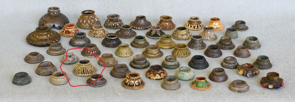

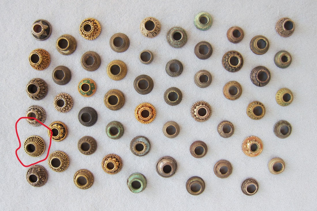

I can't tell you more about this type of mendak, I know that this type is rather rarely seen, Alan has shown once this type in two threads, pics are attached. I also have a keris with this type, last pic.
Alan will be able to tell us more, hopefully.
