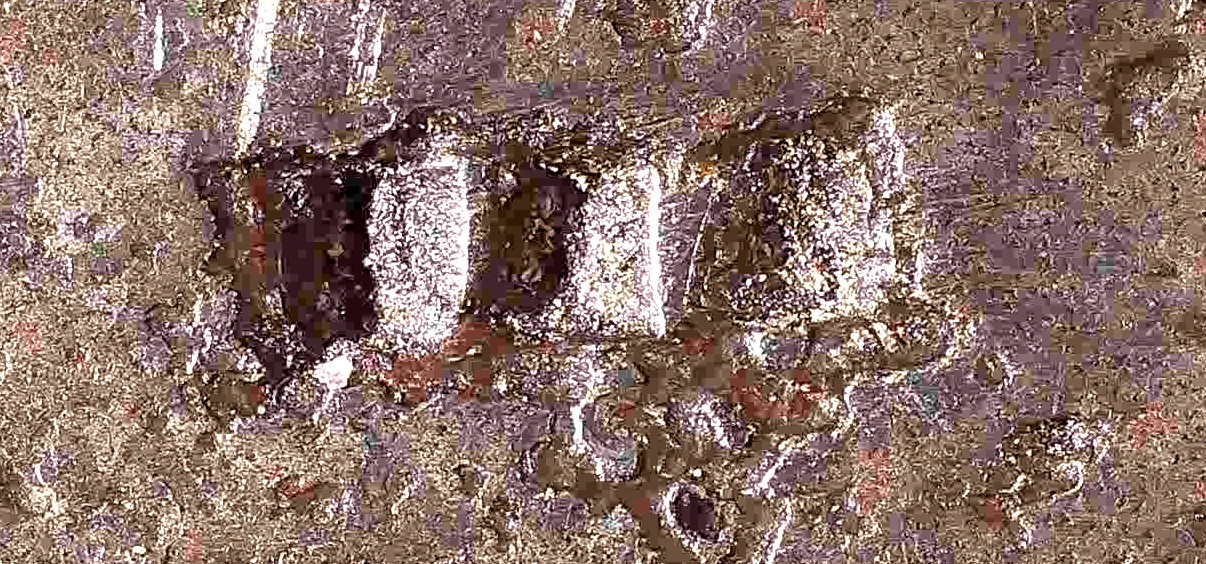

Hi, sorry for the hiatus.
The "square mark" is corrosion, dirt.
But there appears to be 3 letters on the left side of the blade about 5" from the guard ...
It is easier to make out when it is in front of you. I see MMA but it is obscure and boarders on being a Rorschach.

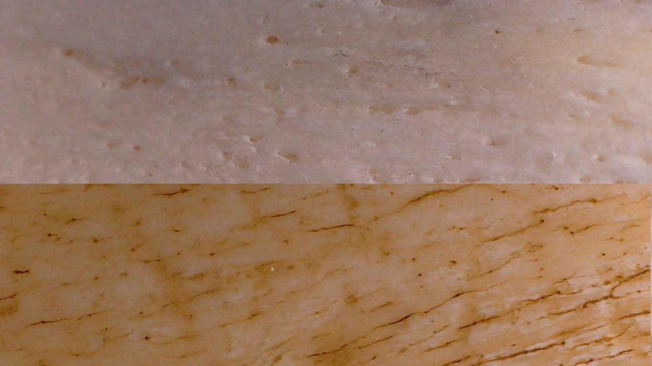

The grip ...
The picture shows bone on top and the grip below.
Bone is covered with holes, ivory has striations.
Vote now!!
Ed is offline   Reply With Quote
Old 1st April 2026, 07:39 PM   #13
M ELEY
Location: NC, U.S.A.
Posts: 2,236

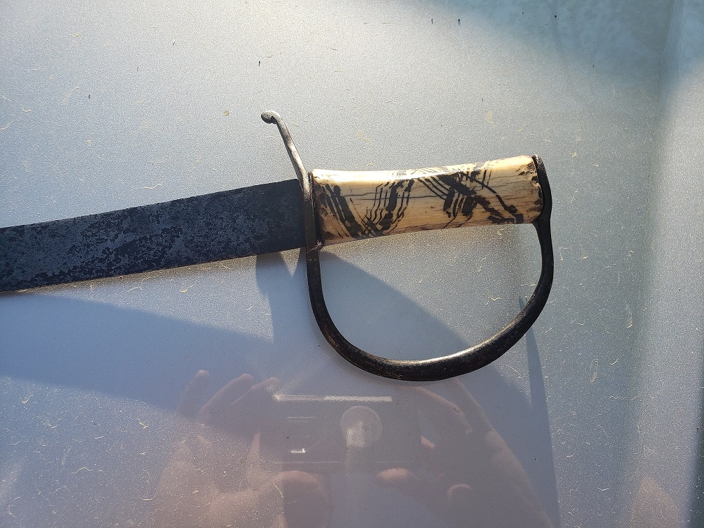

Still lovin' this cutlass. I'll go with bone. While ivory does have striations, yours has the tiny holes and what I perceive to be tiny cracks versus striations. Not to mention that ivory had a tendency to be used on more 'refined' naval pieces, such as midshipman's dirks, officer's grade swords, etc. Bone hilts were the swords for the 'working man', found on numerous cutlasses and hangers. Here's my bone-hilted hanger-
