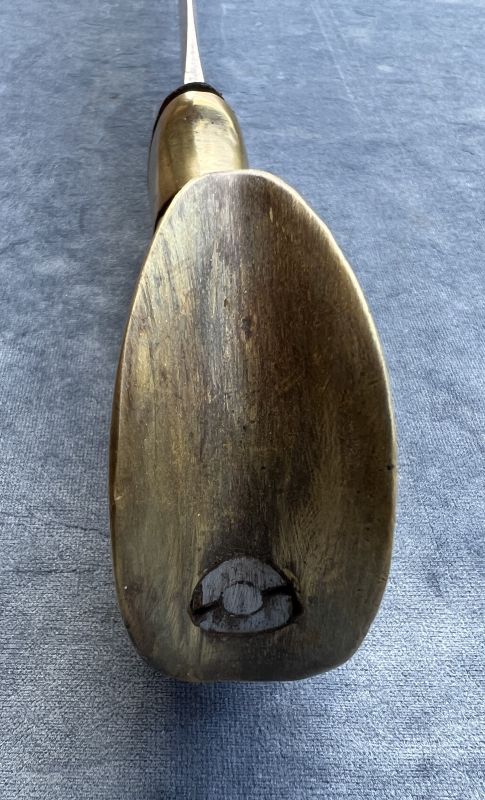

A similar mount is found on Russian shashkas, but the nut is completely screwed into the handle.

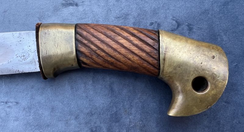

Cavalry shashka for enlisted men and junior officers, M1927
Sincerely,
Yuri

Thanks Pertinax. A very similar nut. Can you tell me the outer diameter of that nut and the diameter of the threaded tang?
Regards, Ian.
Old 30th November 2025, 12:56 PM   #10
Pertinax
Pertinax's Avatar
Join Date: Dec 2023
Location: City by the Black Sea
Posts: 351
Regards, Ian.
Nut - 12 mm diameter, 5-6 mm shank
Glad to help.
Yuri
