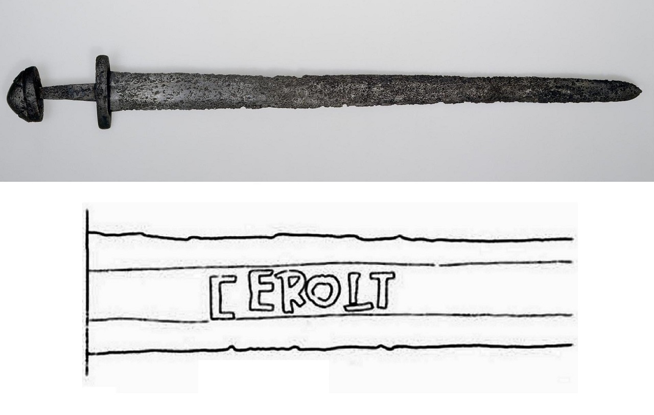

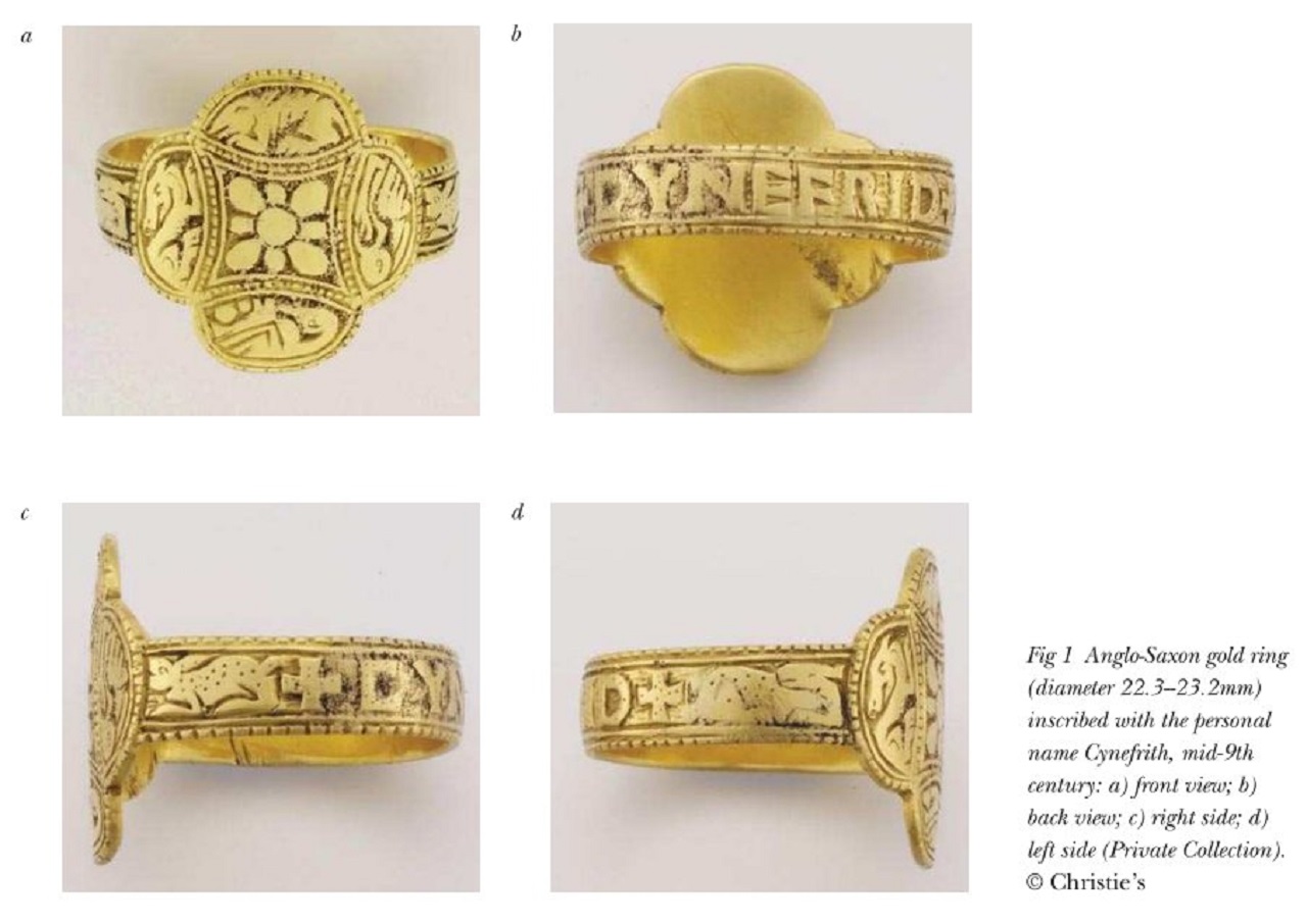

Name:  Hermitage, 700_456 - Zaozere, SE Ladoga.jpg
I think comparing sword inscriptions with epigraphs on other objects is likely the most fruitful approach. I have found Elisabeth Okasha's work on Anglo-Saxon inscriptions useful. Some similar trends can be observed here. Many inscriptions begin with a single cross, particularly but not universally, makers' inscriptions with me fecit. Some swords do follow this template. The identity of the "maker" is always somewhat ambiguous, but scholarly consensus is that it most often refers to the artisan himself. There are cases where it conclusively refers to the commisioner, e.g. an abbot who "made" a new facade for his church. Some artisans, like bellfounders, were typically monks themselves, but maker's inscriptions appear on a wide variety of artifacts whose production was not inherently linked to church authority.
It is interesting that beginning early with VLFBERHT, sword inscriptions mostly follow a standard of two crosses, at beginning and end, which is relatively rare on other kinds of objects (but not unknown, as shown by ring above). I think symmetry may have had a strong appeal in this setting, as evidenced by the number of palindromes that later appear on sword blades, the best-known being SOS and OSO. The standard geometric design on the reverse of VLFBERHT blades is also a symmetric one, as are many other early inscriptions composed of bars, circles, crosses, and other signs. Symmetry can be recognized by all, literate or otherwise, and could enhance the visual impression of the inscription, which might translate to greater mystical or magical power.

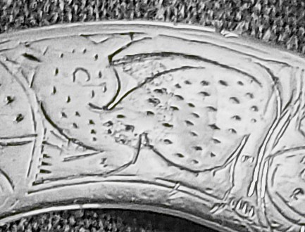

Entirely peripheral to this discussion, I especially enjoyed the small beast on the ring at the start of the name as it so reminds me of similar figures on Scottish annular brooches so many centuries later. I wonder what these were intended to represent.
Thanks Lee!
I see on the ring a rabbit, and on the brooch... a squirrel? Not so impressive as Jim's wolves!
