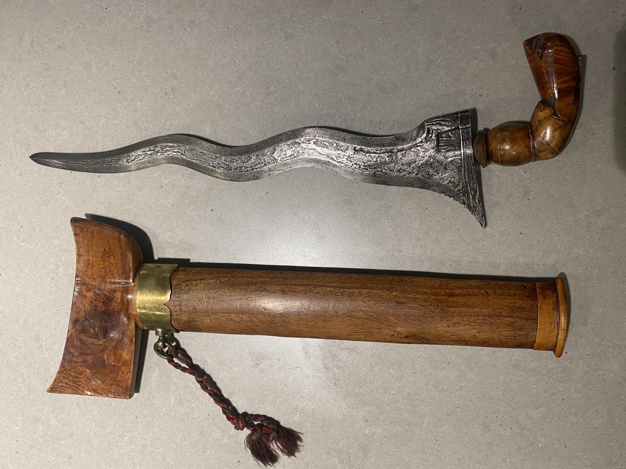

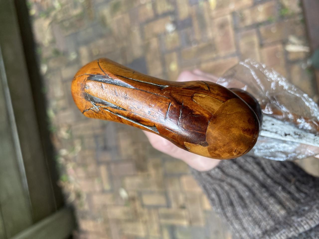

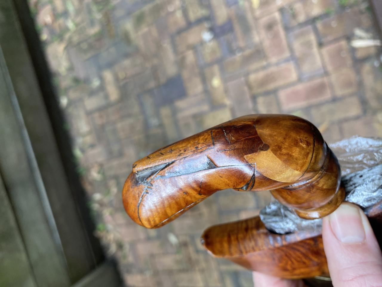

Hello everyone.
A Bugis/Bugis-Makasar keris, collected somewhere in Indonesia in 1920; from an old Swiss collection.
The hilt cup is carved from wood - has anyone seen that before in an antique Bugis keris?
The hilt, I hope it is clear from the photo, also seems to be comprised of at least two different types of wood that were glued together prior to shaping - has anyone seen that before?
Any insight appreciated.
cheers

Old 8th July 2025, 05:23 AM   #2
Posts: 7,228
Adam, I doubt that the hilt cup is original.
I cannot see a glue joint, where is it?

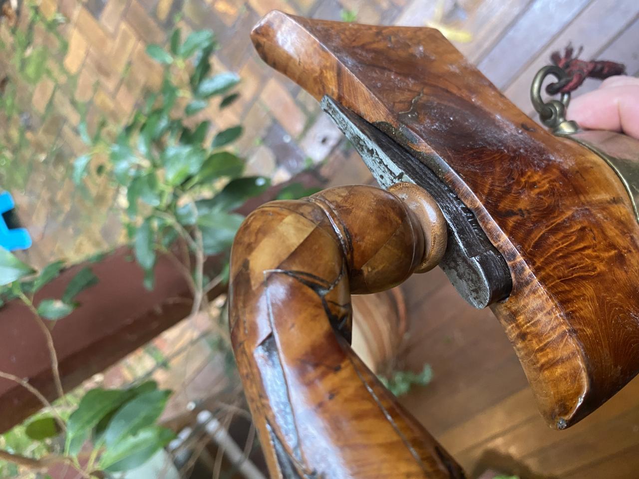

Thanks Alan; yes, if the hilt cup is a recent job I will consider replacing it with an original, but I'm keen to know if anyone has ever come across a wooden hilt cup that can be reasonably regarded as antique/authentic.

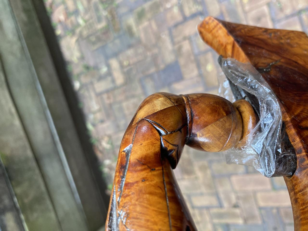

Hopefully the joints in the hilt are clearer in these shots Alan.
adamb is offline   Reply With Quote
Old 9th July 2025, 01:50 AM   #4
Posts: 7,228
Thanks Adam.
Yes, I can see all the little patches, I can also see a spot of some sort of filling agent. That fill is most likely to be a fill where somebody has drilled the tang hole too deep & the drill bit has gone through the wood, sometimes when this happens the drill bit takes a lot more of the wood than just the little penetration hole.
What normally happens with any sort of damage to a hilt is that in-culture, the hilt will be replaced.
The keris is an item of dress, and nobody wants to be seen with his sarung or shirt patched, nor his keris dress patched, repairs to keris dress, especially large repairs & where a repair will be seen, are an earmark of somebody on hard times. Nobody wants that. So it is replace, not repair.

Thanks Alan, I'm not sure it's a repair job since there is a separate area of the same lighter coloured wood on the hilt well below the part that would be damaged if they drilled the hole for the pesi too deep; this other piece of lighter coloured wood is oriented in the same direction as the first, which seems intentional. This should be visible in the very last photo I posted in my last post.
It looks to me more like someone glued some different pieces of wood together and then carved the handle from that composite block of wood - suggesting the banding is a deliberate design feature.
Regarding the hilt cup, now that I look at it, the hilt cup seems to be carved from the same lighter coloured wood that has been incorporated into the hilt, suggesting it is original rather than a recent/non-cultural replacement.
Old 9th July 2025, 05:03 AM   #6
Posts: 7,228
Adam, I did not suggest that this was a repair of damage caused by the over drilling of a tang hole, I am merely relating what I have seen in the past.
Something I have never seen is a hilt that has been made by gluing pieces of wood together & then carving those pieces of wood. Moreover, parts of the hilt appear to be genuinely old, other parts of it do not.
What I believe I can see is that we have a hilt with some sections of very high contrast material, the lines of demarcation between these contrasting zones are very crisp & well defined, however, in some places it does appear that the grain of the wood continues across the lines of demarcation.
There is something else that is also apparent, sections of the wood have quite high chatoyance.
Further, the crest of the hilt appears to have been replaced, and although this would be the most simple of repairs, it has been very clumsily done, so perhaps we are looking at a couple of different people working on this hilt.
The wooden fitting between the hilt & blade does not bear any resemblance at all to the usual metal fitting, additionally, the hilt sits on top of this wooden fitting not within it.
Something about the sarung also seems a little strange to me, & that is that the metal collar that covers the joint between the top part of the sarung & the bottom part of the sarung is of a style that I have never seen, either in the hand, or in a photo.
Now, let me put this upfront:- my knowledge of Bugis & Peninsula keris is only slight, but I have handled quite a lot of this style of keris over the years, going back into the 1950's there were many more of this type of keris available for purchase in Australia than there were Javanese & Balinese keris.
The various variations in the norm that I believe I can see in this keris all have the appearance work done by a collector from a society other than the originating society.
This opinion could well be incorrect, and if it can be demonstrated that it is incorrect then I will willingly withdraw it.
If I had this hilt myself, I would carry out a detailed examination under magnification & I would not neglect an internal examination of the tang hole.

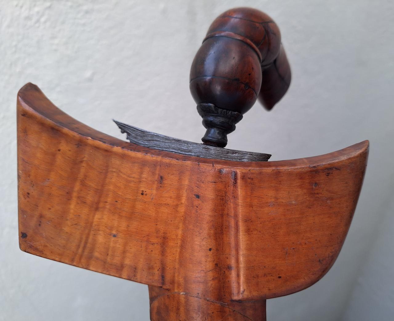

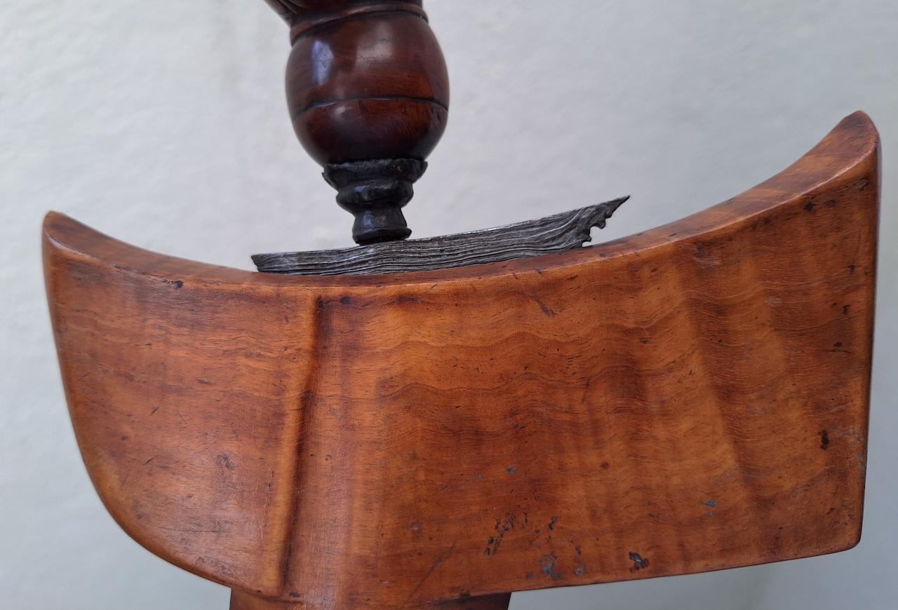

I have a Sumatran Keris, which has an older wooden Pendokok-like object between blade and hilt. They have been together for some time, it is too small yet it embraces the Bungkul of hilt well, but that object likely is an emergency solution. As the blade has a very special Pamor and is well done for a Sumatran Bugis style blade, the original Pendokok may have had some value by itself.
Old 9th July 2025, 11:28 PM   #8
Posts: 7,228
I've seen that form in metal Gustav, one of the ones that I have seen, originally had a little cup & the turned stem had the same form as your wooden one, but that little cup had a big piece missing.
The next time I visited the owner of that keris he had filed the metal cup down, so that only the stem & a tiny cup was left --- very similar to what you have shown in wood.
I've also seen wooden mendaks on Javanese keris, & wooden wewer on Balinese keris, not all that uncommon & usually from an ebony.
Seen the same thing in ivory.
So the hilt ring can exist in wood & materials other than metal, but Adam's is the first wooden cup-form I've seen on a Bugis style keris, and the form of Adam's wooden hilt ring does not really echo any Bugis form that I can recall having seen.
This, of course, does not mean other fittings like Adam's do not exist, it just means that I have yet to see another.

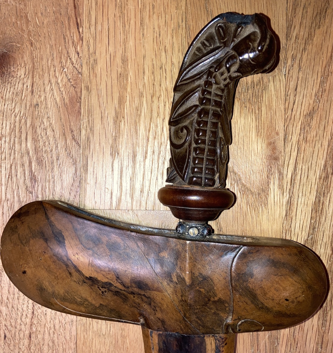

On the other matter: has anyone seen a composite wooden hilt before like the one in this Bugis keris in my original post(s)?
And, as Alan points out, the brass collar with the swivel? Is this an unusual feature of Bugis keris?
I've seen broadly similar kinds of metal attachments (sometimes with swivels) on the sheaths of badiks of various kinds from South Sulawesi; typically, these seem to be anchor points to which woven cords used to keep the blade securely housed in the sheath are attached.
cheers
Adam

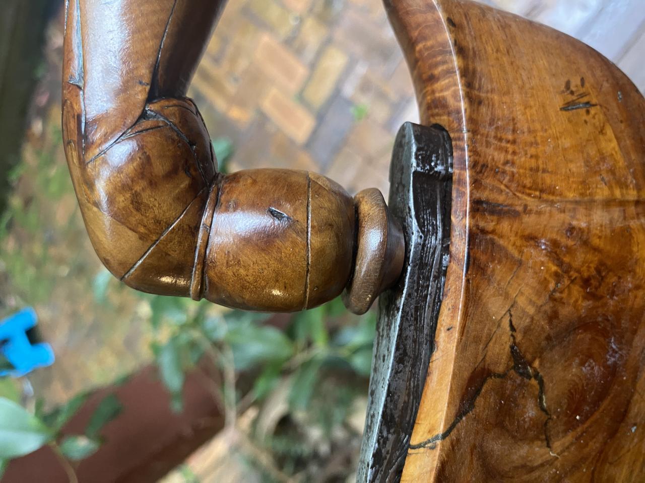

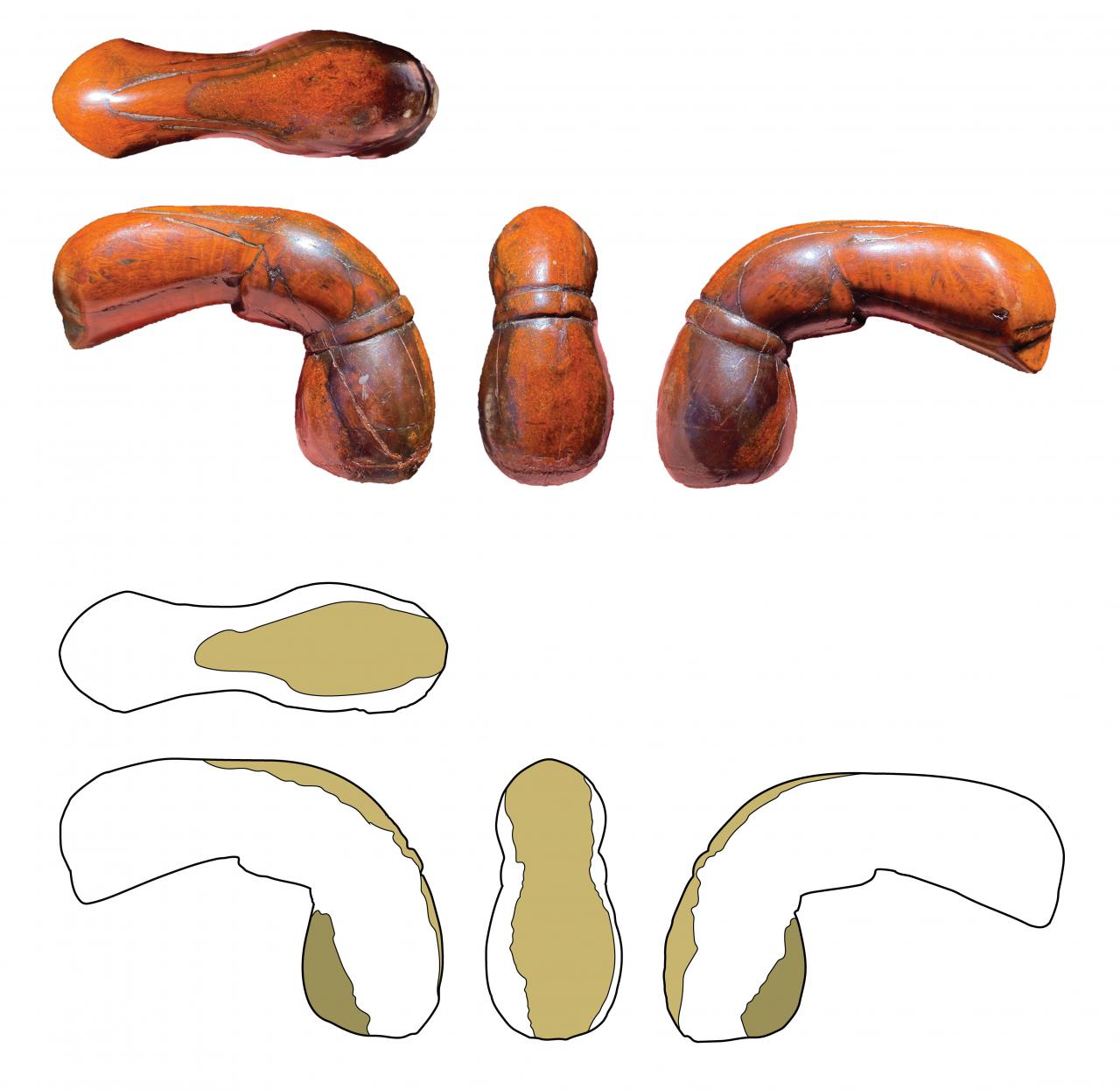

For anyone interested in this matter: I removed the hilt from the tang to inspect it closer. The hilt definitely seems to be comprised of at least two distinct kinds of materials: 1) a dark wood with a lustrous, rich grain; 2) smaller elements comprised of what I previously interpreted as a lighter-coloured wood, one with no distinct grain. The two parts have been joined together with glue in an intricate pattern. The hilt cup had been glued to the hilt with some sort of fibrous white adhesive. I scraped away the remnants of the adhesive on both. This revealed that the hilt cup is comprised entirely of some sort of whitish-coloured material that has been coated with what seems to be a dark-coloured lacquer/shellac. The same material is also visible in the composite hilt, suggesting hilt and hilt cup are contemporaneous. I don't know what this whitish material is: I tested it with a red hot needle; the needle went in and the smell I interpret as being earthy/woody. By contrast, I did the same test on an two resin-cast keris hilts: both gave off a strong plastic smell that was distinct from the earthy/woody smell. I also did the needle test on the bone hilt of a mandau, and on a deer antler: in both cases, the hot needle could hardly be pushed in, and the resultant smells were again distinct from the earthy/woody smell. So perhaps it is some kind of soft(ish), light-coloured wood (but if so, I can't see any grain).

Adam, what I believe I can see at the bottom end of that hilt is a fairly common repair for a cracked hilt, the hilt hole is enlarged, the hilt is compressed to close the cracks, the insert is put in place with a strong adhesive. In the case of your hilt, it appears that the insert has been run through the wooden cup as well.
If a the upper part of a hilt is also badly cracked, or there is a hole through it, usually caused by careless drilling of the tang hole, that insert will be run all the way through the hilt and reshaped into correct form. I suspect something like this could have been done with your hilt.
I note that you are wearing an armour glove. I am aware that some people do wear these when using sharp tools, however, I personally find that I have much better control of power tools & much better feel of traditional manual tools without the glove. Going back to when I was doing a lot of custom knife work there was a bit of a craze for makers to wear these gloves, & at the time it seemed like a good idea, so I gave it a try. I slipped up so many times when using even a single glove that I finally dumped those expensive gloves in the rubbish bin.

Sorry Alan, I hope this image is a bit clearer now; the coloured areas in the schematic illustration show the parts of the keris hilt that seem to be comprised of different materials to the richly grained wood (left blank in the schematic). Seems like an extraordinary amount of effort to patch up a damaged hilt.
Regarding the glove (actually very cheap from Bunnings), until I develop a higher level of skill in the use of the very sharp knife I used to scrape away the tough glue, I prefer to keep all my fingers intact! But I appreciate the advice, thank you.

Thanks for those pics Adam, yes, the various materials used are now quite clear, and you're dead right, it would have been a lot of work, but if one is a skilled worker in wood, such a job would not be at all difficult. For example, my own father was expert in the art of marquetry, and for him, a job like this would be no effort at all. On the other hand, for me it would be very difficult.
If a new hilt is not able to be obtained, the repair of the old hilt is necessary, but in my experience, such a repair would never be done in the areas of SE Asia with which I am familiar.
My opinion is that this hilt was repaired outside the culture of origin of the keris.

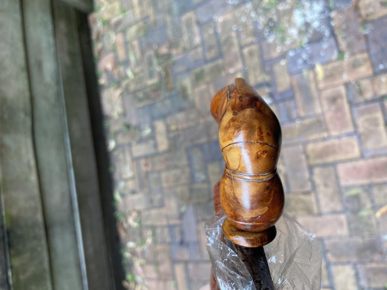

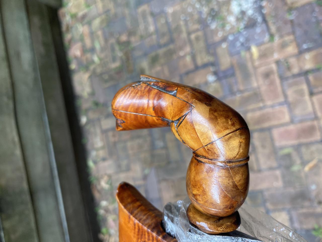

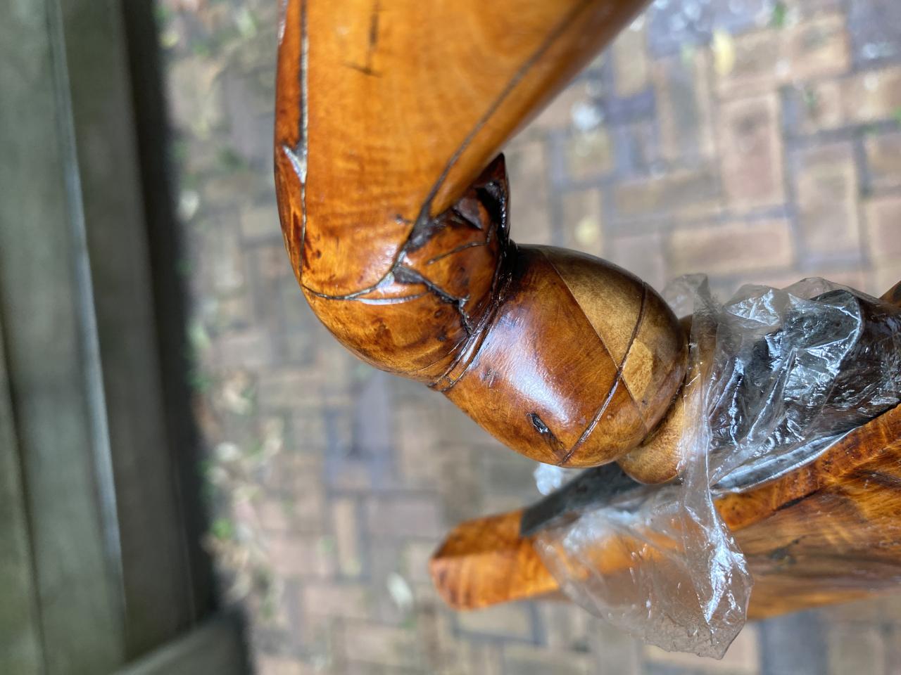

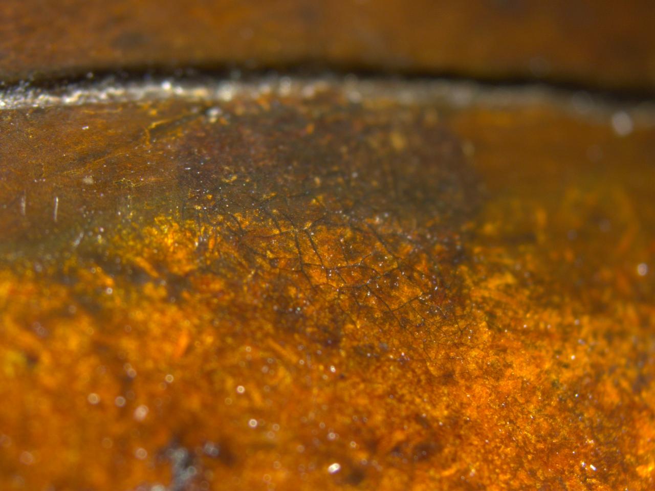

I've just noticed that the wooden hilt of another of my old Bugis keris has two patches of different-looking material (shaded areas in this schematic illustration) in more or less the same places as the other one I posted above, with lacquer over both the patches and the original wood - but this time, the repair work, if that is what it is, seems to have been much less expertly done.
Has anyone else seen this with Bugis keris hilts before?

I'm pretty sure what you see on this second hilt is just a variation in the colour of the wood.

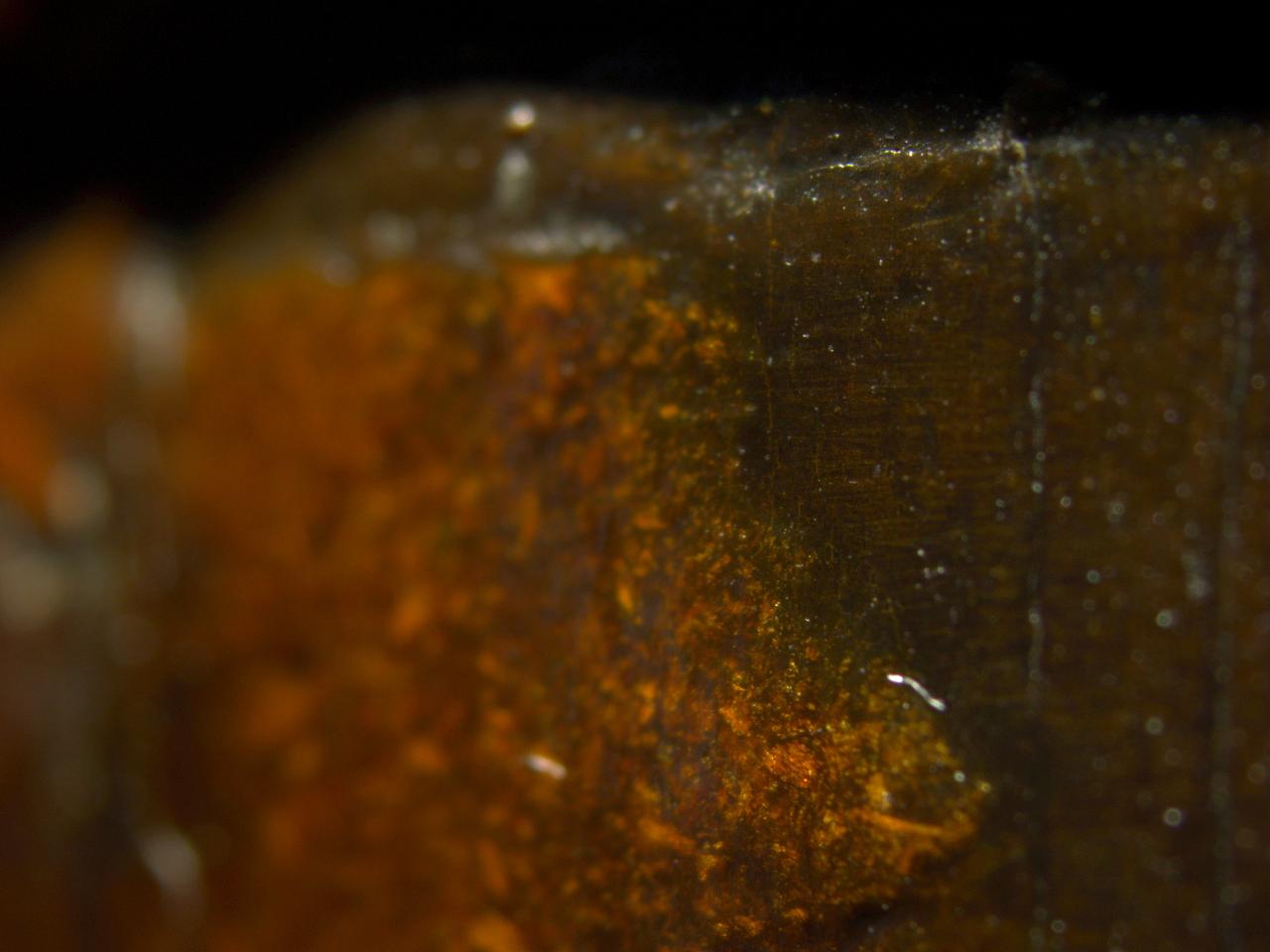

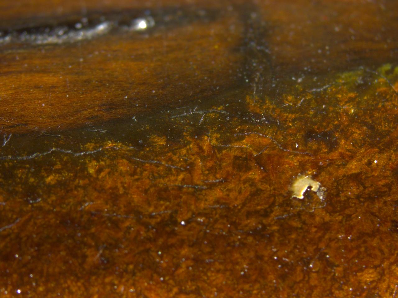

"I'm pretty sure what you see on this second hilt is just a variation in the colour of the wood."
David, it is not a variation in the colour of the wood or some sort of natural inclusion within the wood prior to carving the hilt.
The attached photos at x1.2 magnification clearly show that this material overlies the wood of the hilt and that it comprises some kind of orangey-coloured resin that has been carefully moulded to match the form of the hilt, and then both resin and wood have been coated in lacquer.
One of the photographs I've attached here shows where the resin has cracked.
To me it looks like a carefully done repair job, as per Alan's suggestion for the other Bugis keris handle.
If so, the question is: why would someone go to so much trouble to patch up a damaged hilt when it would probably have been easier to get a new one.
