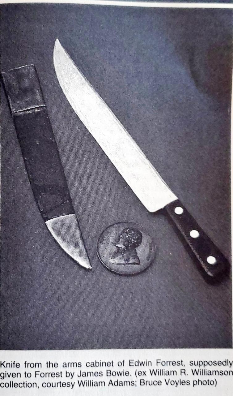

His fame traveled fast, and some time later while recovering, he met a well known stage celebrity known for his theatrics, loud public quarrels, large custom made weapons often oversize for his performances...Edwin Forrest (1806-1872).
Bowie sent him a knife, which Bowie said in a letter accompanying that THIS was the notorious knife the newspapers were so excited about, and thought he might like to add it to his collection. According to Bernard Levine, in his "Knives and Their Values, 4th Ed." 1985, p,320, he notes this knife does not seem professionally made, and suggests he is satisfied with its authenticity.
While this goes to the 'Sandbar' knife, the fabled knife from the Alamo is yet another mystery!!
In the pics note the 'butcher knife' like knife said to have been Bowies at the Sandbar fight. Then look at the Gilliam/Noble version early Bowie, no guard.

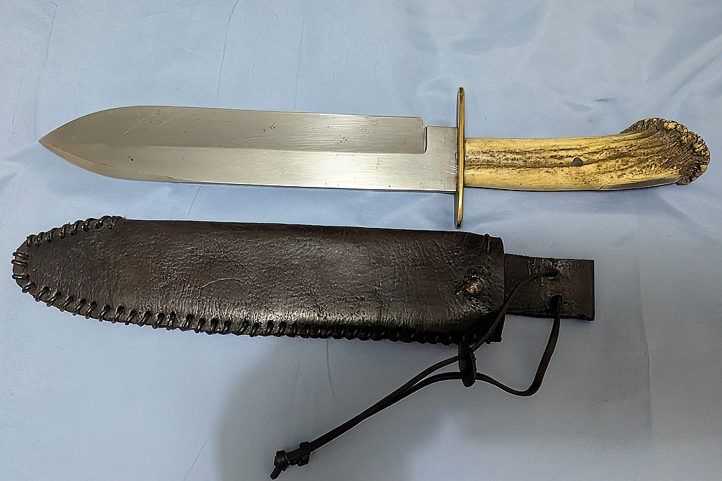

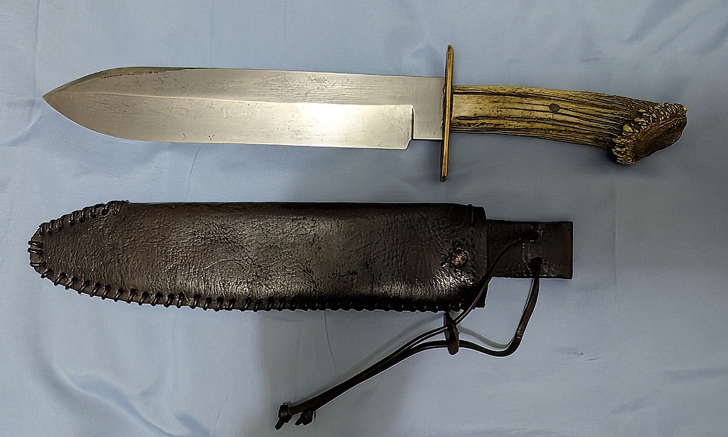

Just aquired a spearpoint Bowie.
16 in.LOA.
5.75 in. stag crown grip, one brass pin. Looks old & has wear.
2 in. wide razor sharp blade just ahead of the set back ricasso. 3.5 in. wide oval guard.
Spine has a 4 in. unsharpened false edge.
.25 in. thick at the ricasso, distal tapering down to about .125 in. near the tip.
weight: 1.19 lb.
No markings.
I'll let y'all convert that to metric if you want.
Any idea on its origin and/or age wold be appreciated. Thanks.

Old 1st August 2025, 04:42 PM   #6
Posts: 9,762
16 in.LOA.
weight: 1.19 lb.
No markings.
Hello Wayne,
Very nice knife! Looks like a late 19th century or early 20th century Bowie to my eyes. I guess it's from England.
Sajen is online now   Reply With Quote
Old 3rd August 2025, 06:02 PM   #7
Posts: 4,285
Sajen, I concurr.

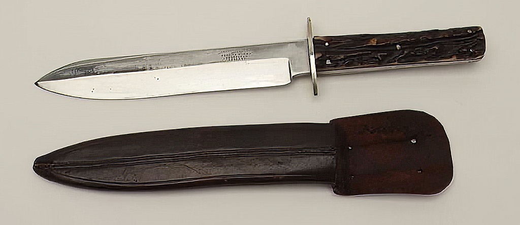

Did some googling. Looks a lot like a spear point bowie by George Butler, Sheffield - probably late 19c. The std. ones he made are marked on the side of the blade, but his standard models were only up to 8 in. blades. I also found he made custom blanks for others to haft. And he'd make unmarked customs as requested by customers & was known for making non-standard ones. Appears he normally used a full tang/slab sides with 5 pins for stag grips, but not for larger crown stag grips.
I contacted the vendor of mine, & they said they thought it was German.late 19c-early 20th.
p.s. - Ijust noted i'd forgot to list the blade length on mine it's 10.25 in. - i.e. non-standard.
Picture is of one I found at a past auction, marked as Butler, 1860. note the false edge and recessed Picasso - dead ringer for my new bowie. Found a couple more of his std. spearpoints like this, just in worse condition.
Old 4th August 2025, 07:10 AM   #8
Posts: 9,762
Equally if it's English or German, it's a very nice bowie!

To reiterate my earlier post, the knife pictured is the one said to have been given to actor Edwin Forrest by Jim Bowie according to descendants of Bowie,
There is so much hyperbole surrounding the Bowie knife by writers from later in 19th through 1940s when Thorpe wrote "The Iron Mistress" and the Alan Ladd movie; then the Alamo movies that fact and fiction are hopelessly entwined.
