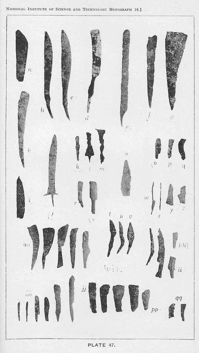

I would beg to differ on the "amateurs approach." There are some of us who work within the academe, and who would only make statements grounded in fact or formal theory.
1. To note, there exists pre-1800 documentation of krises encountered in the PH in terms of local and foreign sources (Spanish friars, Dutch accounts, plus that captain who visited PH pre-1700s, I'll have to re-check my references).
2. There's also a book, with APA entry [SOLHEIM II, W. G. (1960). The Philippine Iron Age. The University of Arizona] which has a kris artifact found in Bohol area I think, dated 12th-15th century, I'm attaching the plate. Of course, we don't have any clue as to how it was dressed, if it was PH-origin; but the fact that it was found in PH soil points that kris was already being circulated in that time period.
3. Then there are also Moro elders' accounts, oral traditions, even myths and legends which trace krises back to pre-colonial times. These are valid sources under formal anthropological framework.
To summarize: there's no doubt that krises were already circulating in the Philippines pre-1800, pre-1700, even pre-colonial. In documentation it's clear that these were found in Southern (Moro) areas; in archaeological evidence at least, one is found in Visayas area (Bohol), which is not too far from Moro areas.
