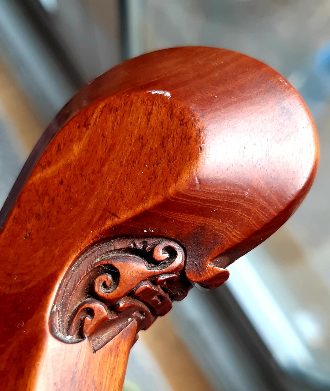

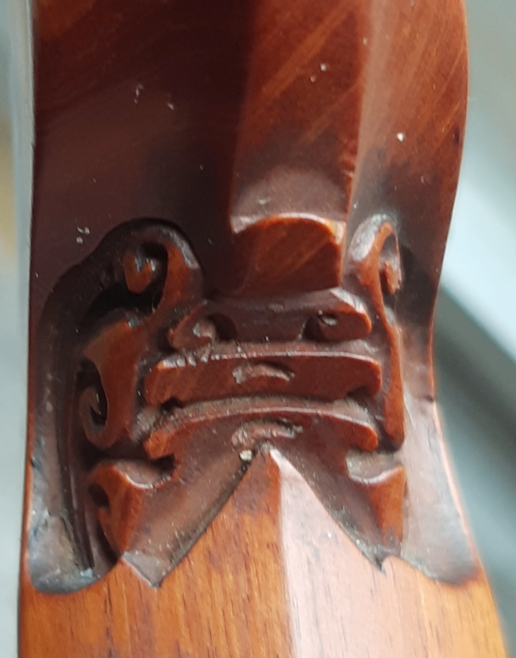

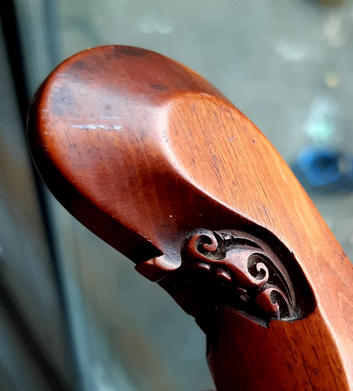

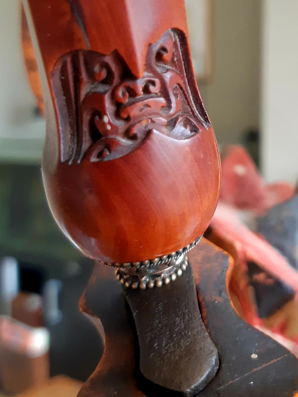

Thanks Sid. It is a very nice hilt IMHO. If the carvings are symmetric, this is not not something we encounter too often. Most hilts are village quality. I think this one is not.

Hi Rasdan
Thanks. Ive had a look at some other keris I have and they all have similar symmetrical faces on the hilts. I dont know what to make of this.

Hi Sid, It depends on the level of symmetry, the flow of the curves and the cleanliness of the carving. The photo you provide does not give that view, but I think it is nice enough to be above average.
Now I don't know what real high level kraton carving should like, this is my impression what is nice. Below are 3 cecekan. 1 is new, common and OK and one is village quality, the one with selut is a nicer one - to my eyes. Of course we need to see the hilt as a whole too, but this is just regarding the cecekan carving.
