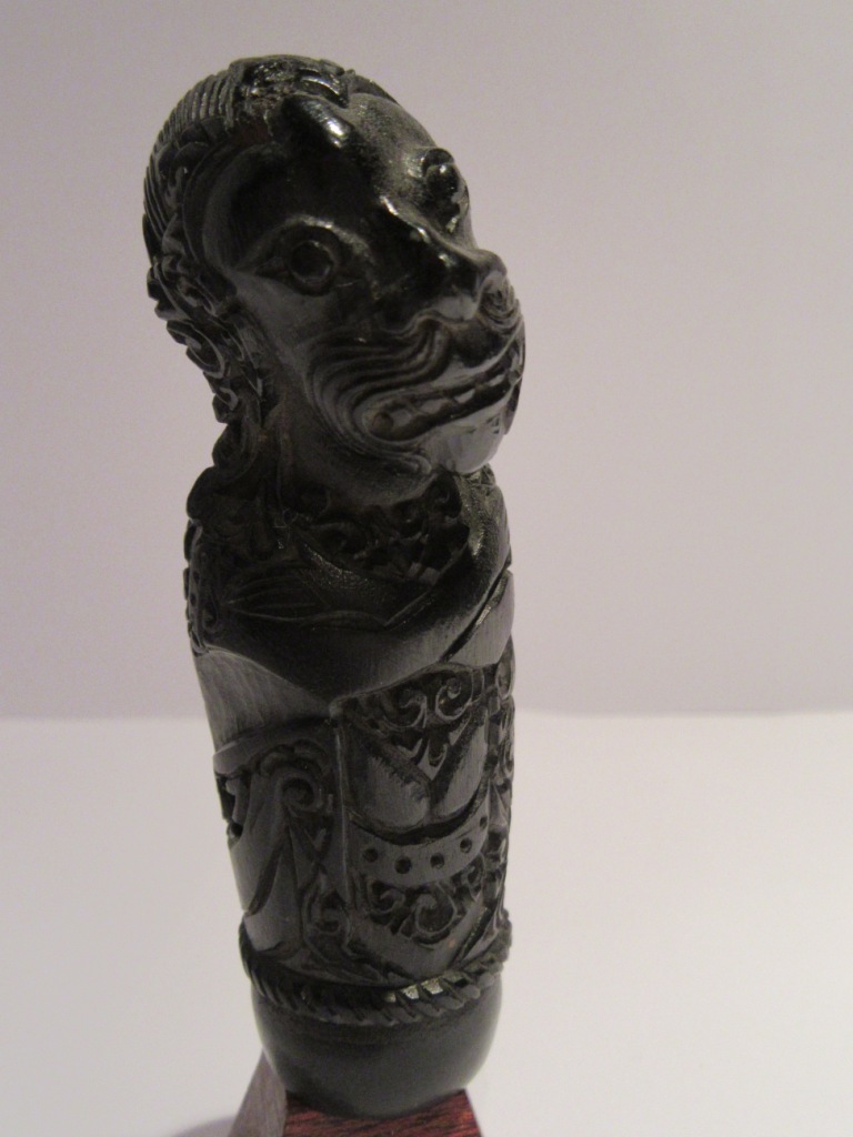

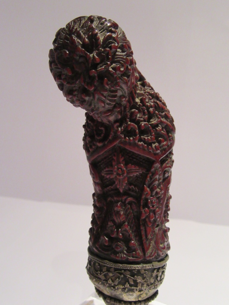

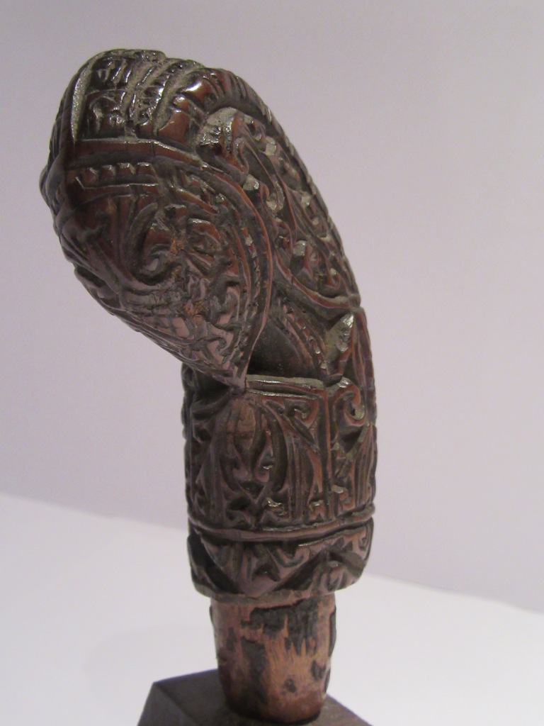

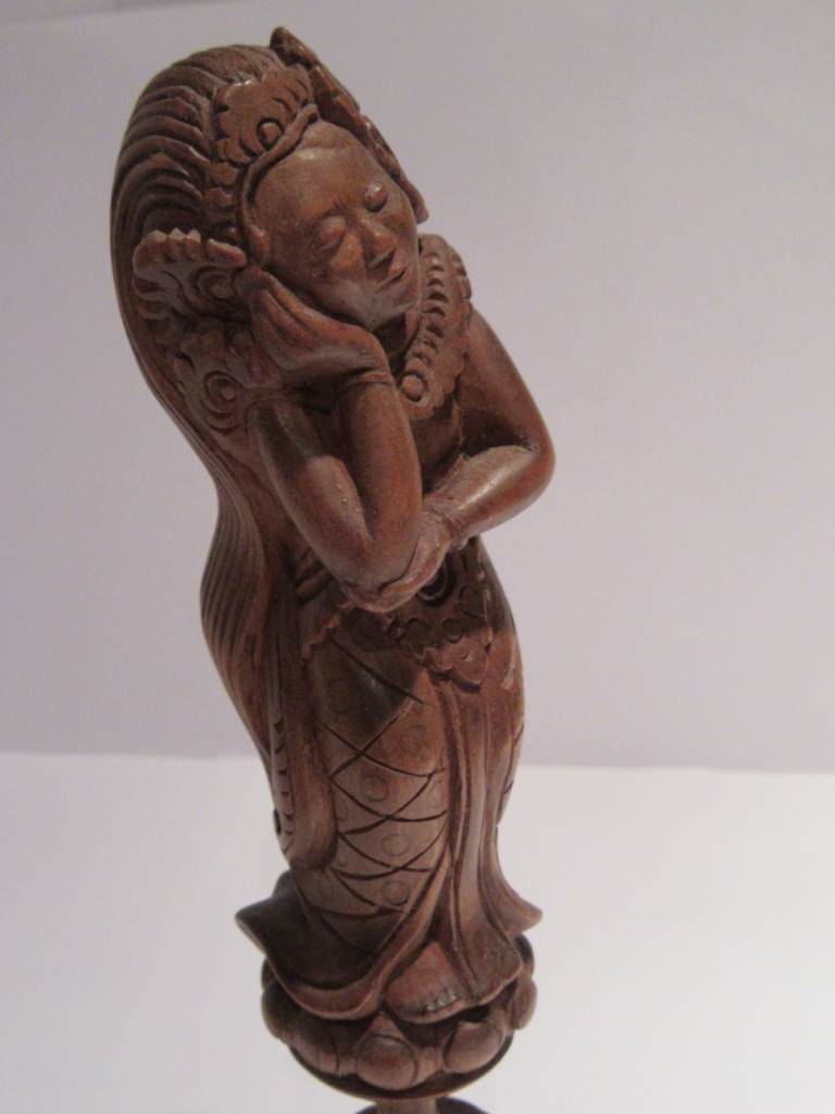

As it's been a while since any hilts have been posted - and as this is such a lovely thread - I thought I'd share my humble collection. They're certainly not all old or as impressive as some of the previously posted hilts, but nevertheless I hope you'll enjoy seeing them.
Bjorn is offline   Reply With Quote

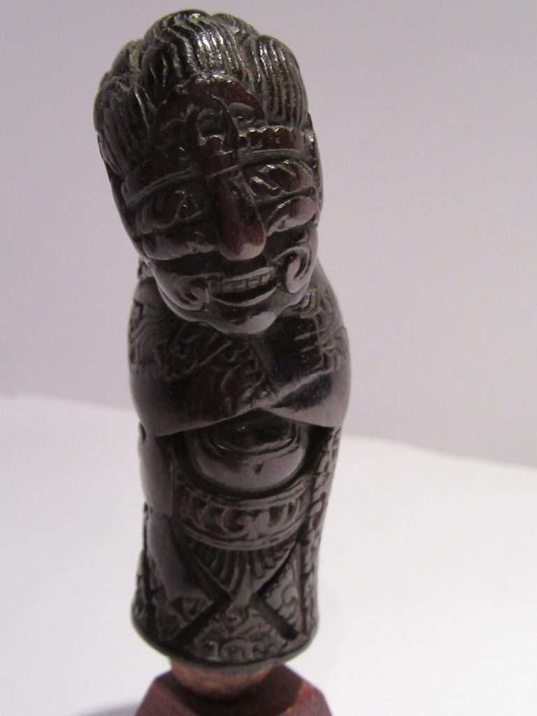

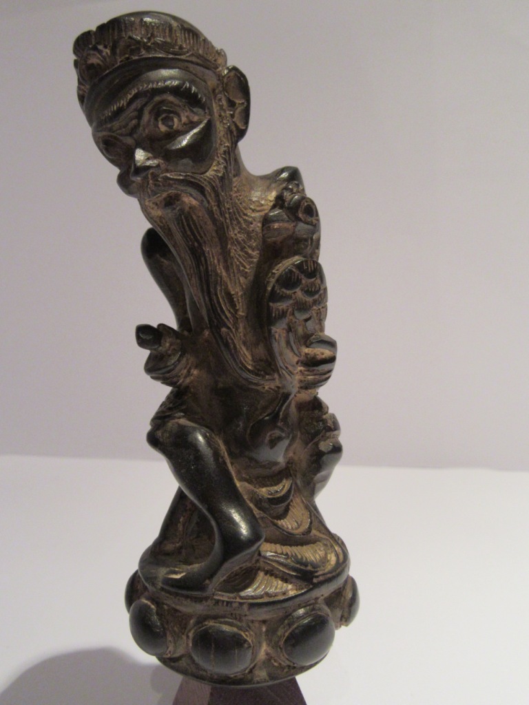

Old 29th January 2018, 09:28 PM   #155
Bjorn
Join Date: Jan 2013
Location: Netherlands
Posts: 188

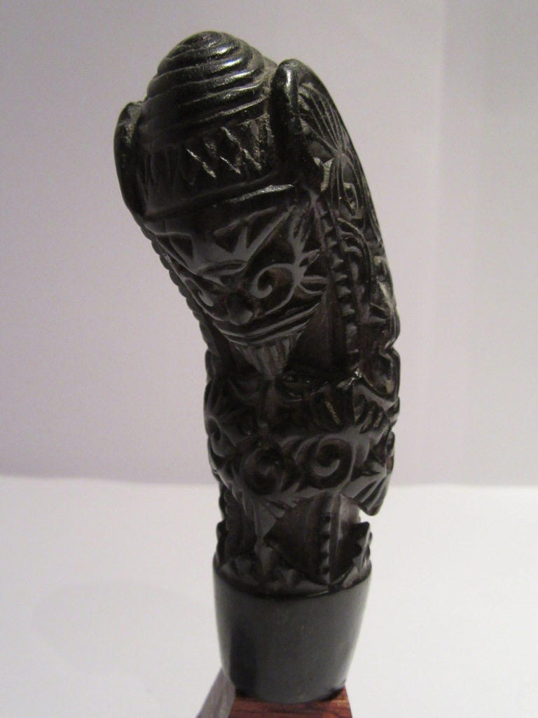

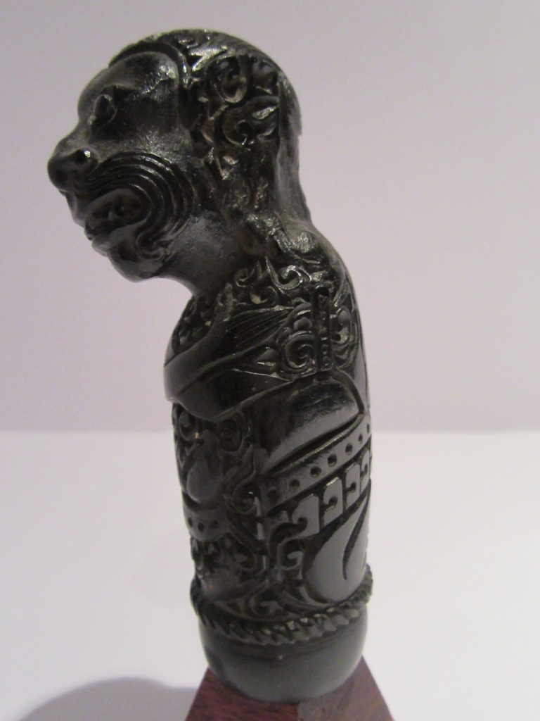

Second batch

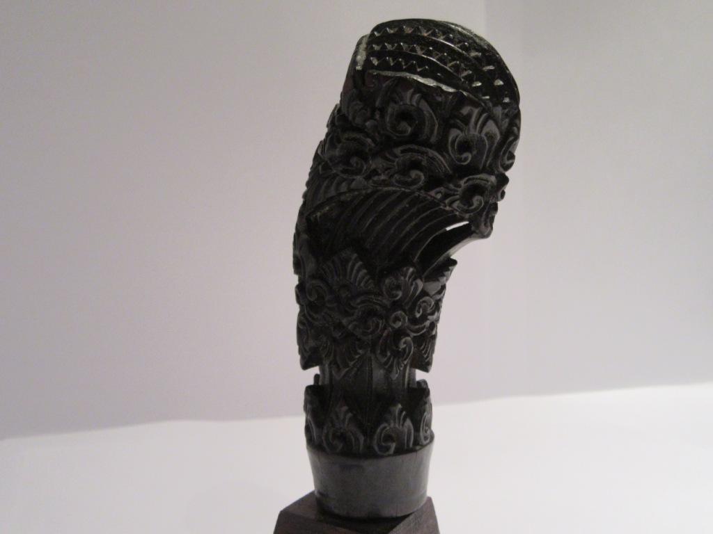

Old 29th January 2018, 09:30 PM   #156
Bjorn
Join Date: Jan 2013
Posts: 188

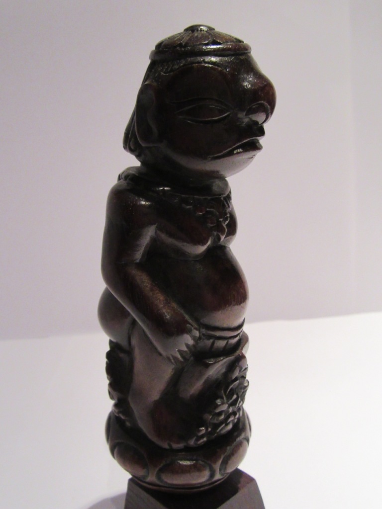

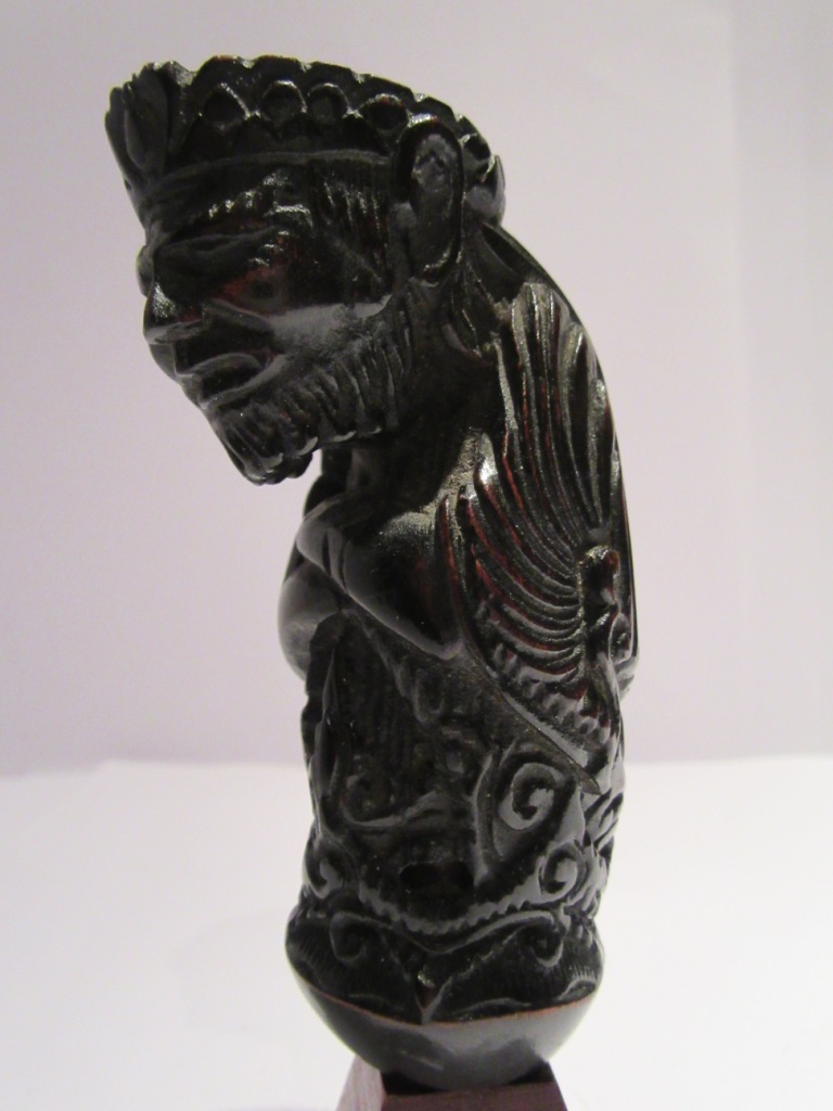

Third

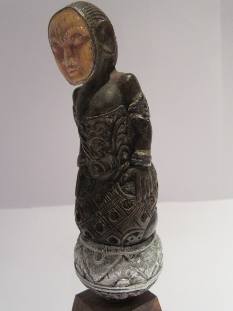

Old 29th January 2018, 09:30 PM   #157
Bjorn
Join Date: Jan 2013
Posts: 188

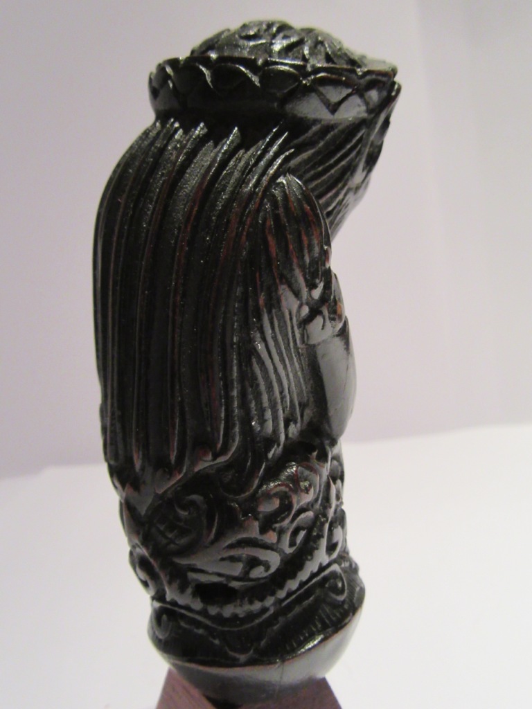

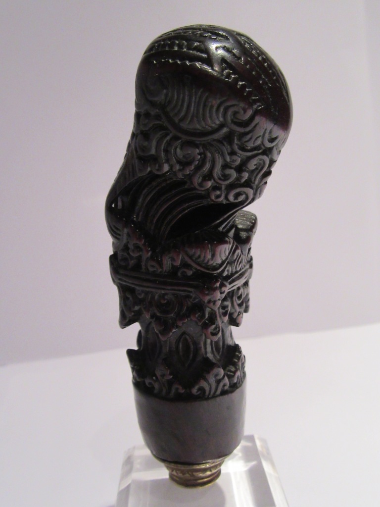

And final.
Old 29th January 2018, 09:43 PM   #158
Posts: 7,303
Thanks for posting Bjorn. Even if they are not all particularly old they are nonetheless interesting additions to our gallery.

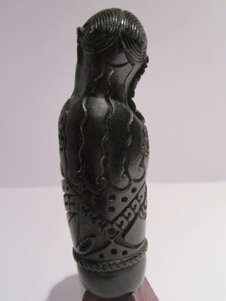

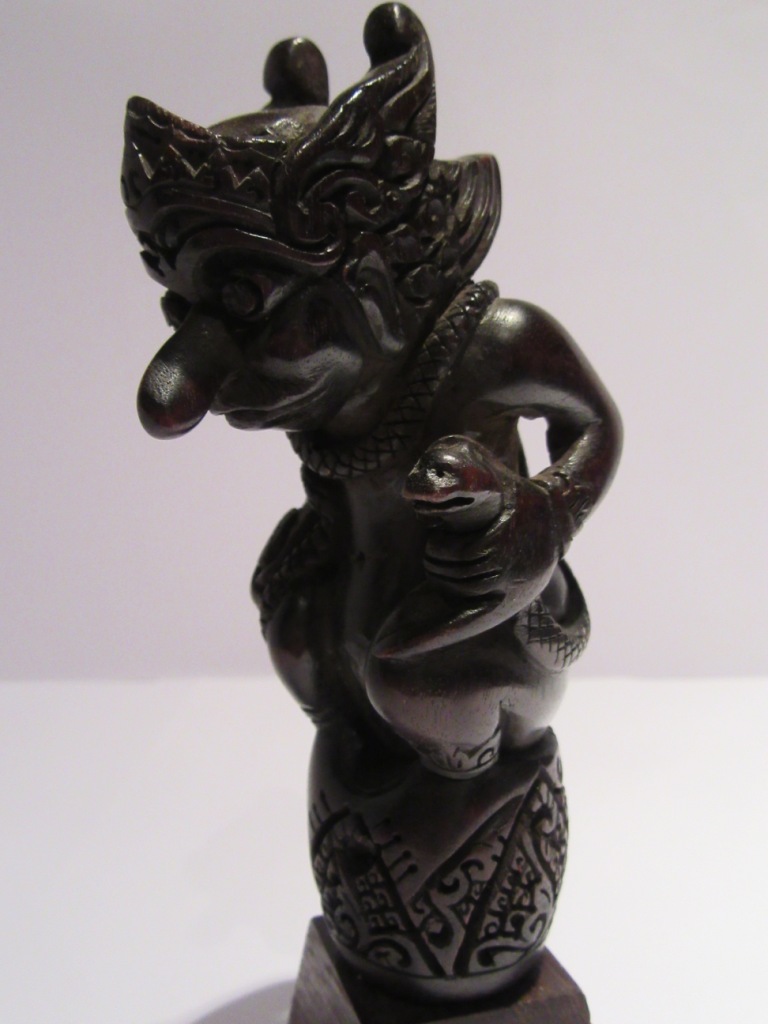

Old 16th October 2019, 11:15 PM   #159
Athanase
Athanase's Avatar
Join Date: Mar 2016
Location: Paris (France)
Posts: 432

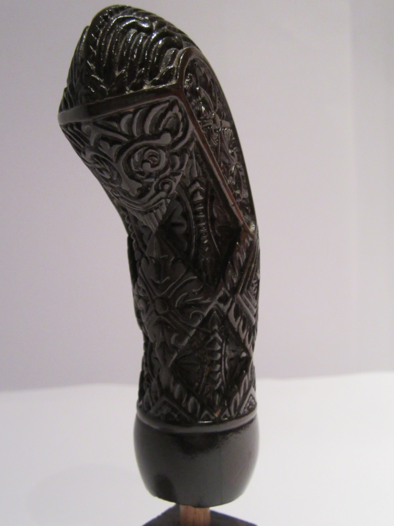

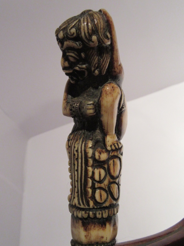

I'm not sure of the geographical origin of this Javanese hilt (East Java?)
But I'm pretty sure it represents Bhima: position of the hands, the belt with its buckle, the bun, etc. ... it's very close to Balinese hilts representing this deity.
Old 19th October 2019, 11:53 PM   #160
Hello Séverin,
Another very finely carved hilt! If you ever decide to let it go...
IMVHO this is a somewhat later example based on the early type representing a demonic being (I believe I also can make out fangs with your example) apparently belonging to the Kastrya echelon. Based on carving style and wear/patina, I'd guess your's is really old and certainly antique though.
The additional wooden "bead" below the hilt is weird. I've seen a few of these but no idea where this idea came from?
This keris seems worth a dedicated discussion - maybe you could post the blade and its fittings in a separate thread?
BTW, I'd posit that with many/most Balinese hilts the original attribution (intended by the carver and/or sponsor) is not possible to prove. Same-o for figural hilts of other regions, I guess. Thus, it might be safer to qualify any interpretations.
Old 20th October 2019, 01:20 AM   #161
Posts: 7,255
Yes Kai, affixing names of specific Balinese deities or folk figures can be pretty difficult sometimes. Moreover, sometimes the people in Bali whom one would think might have a good idea of what specific personage is represented by a totogan, will have no idea at all, or else, be demonstrably wrong.
But sometimes an attribution will be included in the carving that might be sufficient clue to venture a guess on. With Bhima it is usually an overlong thumb nail and/or rather massive genitals.
In respect of hairstyle, I'd be looking for a crab-claw hairstyle on a Bhima representation. The simple knot of hair is normally associated with a low level personage, maybe a punakawan, or servant, or common man.
Edit
I've referred to "hair style" above. Ideally, this crab claw (supit urang) would have been a hair style, but in reality it was probably mostly a head-dress, its symbolism is that it identifies a hero.
Old 20th October 2019, 08:00 AM   #162
Post
Hello Alan,
Thanks for your thoughts!
Regarding the genitals we can only guess, this type seems to always maintain decorum...
It is also always carved with 4 fingers with apparently the thumb hidden from view. (If it were meant to represent Bhima, I'd expect the thumb(nail) not to be hidden from view though.)
While the bun may appear simple, this type always comes with quite elaborate hairdo with very neatly arranged hair, several successive rows of curls in the bun and often additional curls below - pretty much nessitating a hairdresser (not a DIY thing, I believe).
This type also always come with lots of status wear: A huge central diadem which is kinda mirrored at the back of the head, too. Around the ears there seems to be a sumping ron (slightly smaller than usual?) and possibly an eloborate ring dangling down from the earlobe (if not part of the sumping ron). Then we have a massive and heavily decorated breast plate followed by a very broad belt with central plate/buckle and, again, heavy decor. The upper arms, wrists and ankles are also carrying elaborate bangles. Definitely a member of the upper echelons and not a common man is represented here!
Old 20th October 2019, 12:22 PM   #163
Posts: 7,255
If you say so Kai.
So give us a name.
Or maybe point us at a known monumental representation or a wayang figure?
Kai, my comment was this:-
"The simple knot of hair is normally associated with a low level personage, maybe a punakawan, or servant, or common man."
If you understood this remark to be an indication of an opinion on who or what this hilt could be, I apologise for my failure to be clear. This remark on the "simple knot of hair" was a general comment in respect of symbolism, it was not an inference of identity in respect of this specific hilt. For example, Bagong is often shown with a simple knot of hair, but this is not to suggest that the character that this hilt represents is Bagong.
In fact the protuberance on the head of this figure might not be a knot of hair at all. Prabu Ratmaja is usually depicted with a head dress that looks somewhat like the ornament on the head of this figure. I have several examples of Prabu Ratmaja, and you can find more scattered through some of the well known references, like "Keris Bali", and "Understanding Balinese Keris", in most of my examples of Prabu Ratmaja the hair finishes in curls at the rim of the protuberance.
Prabu Ratmaja was a Raksasa King, and my examples all have the requisite fangs. I cannot see fangs on this hilt, but they could be there somewhere. He is a reasonably common figure on Balinese totogan hilts because he is regarded as having extraordinarily strong protective powers, he is also reasonably common on Javanese figural hilts.
This hilt could be intended to be Prabu Ratmaja, but really, I am reluctant to put this idea forward with any conviction. Naming hilt figures is a recipe for argument, and the only person who could sometimes tell you exactly who a figure is would be the carver and original owner.
Old 20th October 2019, 03:05 PM   #164
Athanase
Athanase's Avatar
Join Date: Mar 2016
Posts: 432
Thank you both for all this information.
I admit that if I thought of Bhima it is because of numerous similar identification seen on internet on Balinese handles (very close to those generally attributed to Bayu but without the miroir).
But you are right apparently, after some research after reading you I realize that it isn't because a thing is very often repeated and taken everywhere that it is true ...
Here is an overview of Kriss, no sheath unfortunately and a simple blade.
For the "wooden ball" under the handle, I think it's a fairly "new" to compensate the absence of the mendak and a pesi too long.

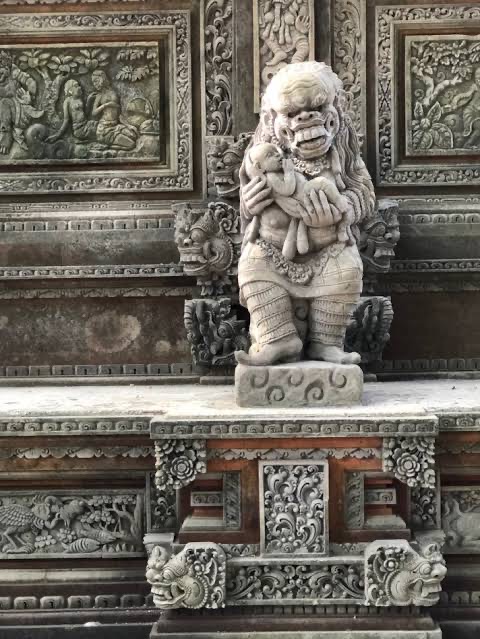

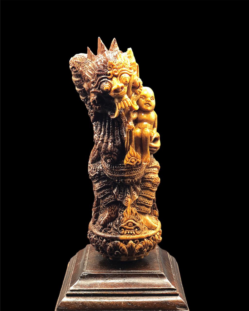

Old 17th February 2023, 11:19 PM   #169

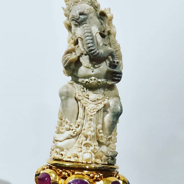

JustYS
Join Date: Apr 2019
Posts: 157

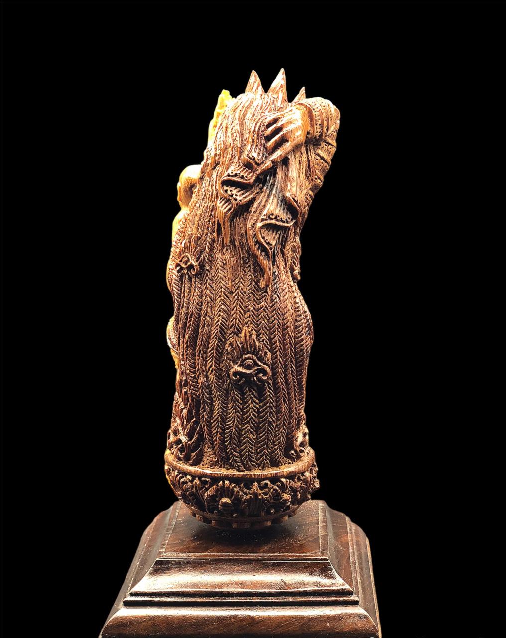

Post them up !

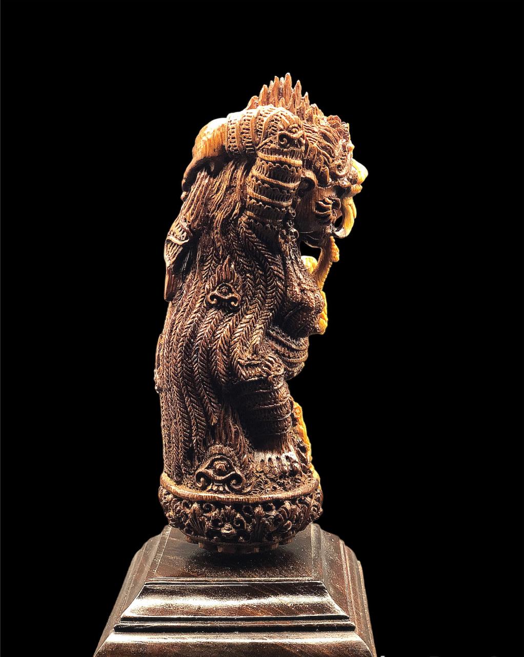

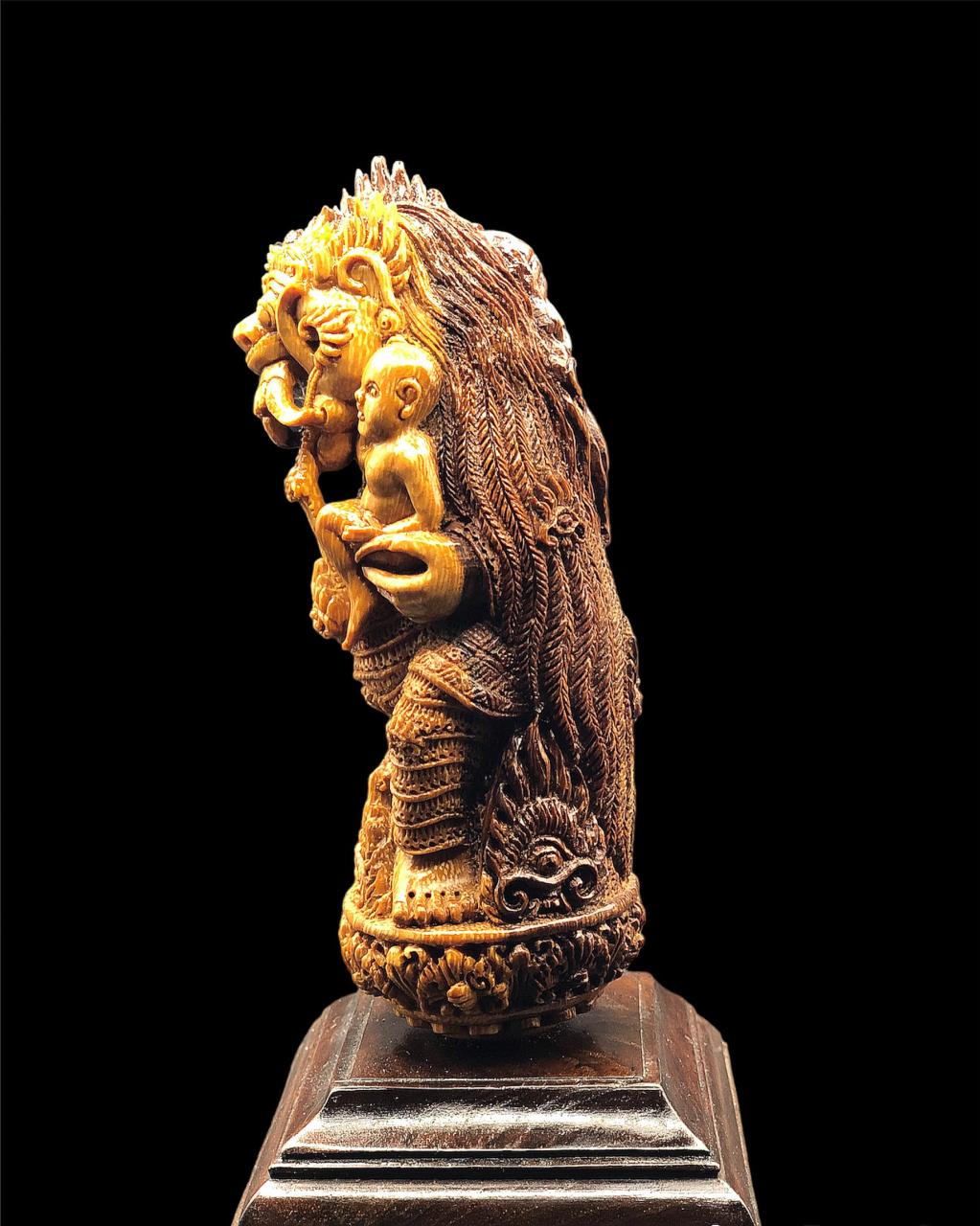

My contribution to this wonderful thread: Rangda(?)
JustYS is offline   Reply With Quote
Old 17th February 2023, 11:56 PM   #170
Posts: 6,441
That is a lovely piece of work, do you have any idea what the material is that it is carved from?
Bamboo root perhaps?
Old 18th February 2023, 12:20 AM   #171
JustYS
Join Date: Apr 2019
Posts: 157
Thank you Rick.
Material is wood but what kind of wood I am not sure, maybe tri kancu?
Old 18th February 2023, 12:38 AM   #172
Posts: 6,441
I also like the juxtaposition of the colors; light next to dark brings to mind the Poleng pattern seen in fabrics of the culture.
Old 18th February 2023, 01:08 AM   #173
JustYS
Join Date: Apr 2019
Posts: 157
This juxtaposition of light and dark colours in Keris hilts is called Sonten Dalu (Night and Day) if I’m not mistaken
Old 18th February 2023, 05:51 PM   #174
Posts: 7,303
That is a remarkable bit of carving right there.
I would think Rangda is a fair attribution...in which case i would image the little baby is toast!

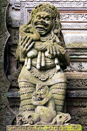

Old 21st February 2023, 02:16 AM   #175
jagabuwana
jagabuwana's Avatar
Join Date: Jan 2018
Location: Sydney, Australia
Posts: 295
I'm familiar with the baby-eating associations of Rangda, but is it common to depict her with a baby like this? It seems kinda vulgar, but then again I'm not too familiar.
jagabuwana is offline   Reply With Quote

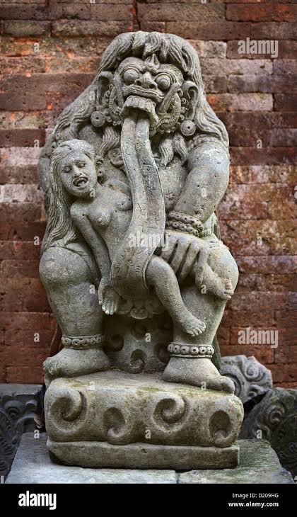

Old 21st February 2023, 10:33 AM   #176
JustYS
Join Date: Apr 2019
Posts: 157
Thank you David.
Hi Jagabuwana,
I think it is not as common as Rangda without baby/little child, but courtesy to google I’ve found the following:
Old 21st February 2023, 12:57 PM   #177
werecow
werecow's Avatar
Join Date: Sep 2021
Location: Leiden, NL
Posts: 688
That second one is the first baby I've ever seen with breasts.
werecow is online now   Reply With Quote
