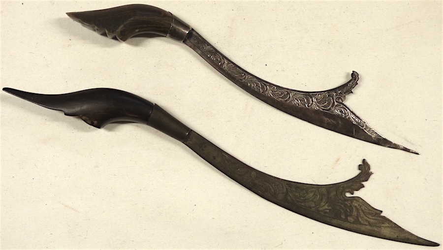

Until today I would quite happily have called the top one a Malay kelewang and the bottom one a parang ginah. These are terms I can find in Stone's Glossary ...
However, I'm going through Gardner's Keris and Other Malay Weapons today and see that he has these two shown in Figure 53, p. 60, where he identifies the top one as golok jambu and the lower one as parang jengkok. Now I don't want to start a "name game" about which is right or wrong (BTW, Stone is often wrong with his names), but can our Indonesian experts tell me what the consensus is with regard to naming these two weapons?
Thanks guys.
Ian.

both are not Indonesian but Malay in origin. In "Spirit Of Wood" is the top one described as "Kelewang" and the one in down is either a "Parang Kelantan" or a "Anak Wali" from Pattani, I am not able to see the different, see attached picture.
Both blades will be laminated, so a polish and etch would be a good idea. Both weapons are rather rare and seldom seen.

Ian,
it will be like so many times, it could be that a sword get called in one village different as in the next village.
I would be happy with the term kelewang for the upper one and with parang ginah or parang jengkok for the bottom one, a term I've heard and read before, most probable by Gardener. But like you see when you search more there arise the next name, in Spirit Of Wood it's called anak wali (children custodian/free translation).
I agree with the anak wali / parang ginah notion. Based on the recurved tip of the blade, it might be Pattani - however, there seems to be quite some overlap/variability and I believe we need to be cautious with our working hypotheses.
The klewang is not from the northern Malay regions. The cross-section of the blade is not triangular, isn't it?
I'd suggest that it originates from the Straits region or neighbouring Malay communities. The hilt seems to be based on one of the common sewar hilt types. (It might be a later replacement though...)
AFAIK, jambu/jambul merely refers to a protrusion/spike - it's just a description, not a proper name.

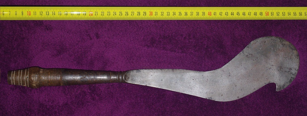

What part of the blade is sharpened in your example - only the larger concave area?
It looks pretty much like a billhook and similar blades are widely utilized as tools. It will be tough to link this to a specific origin, I guess...

The sharpest part and the meter side and all the rounded part of the blade.
