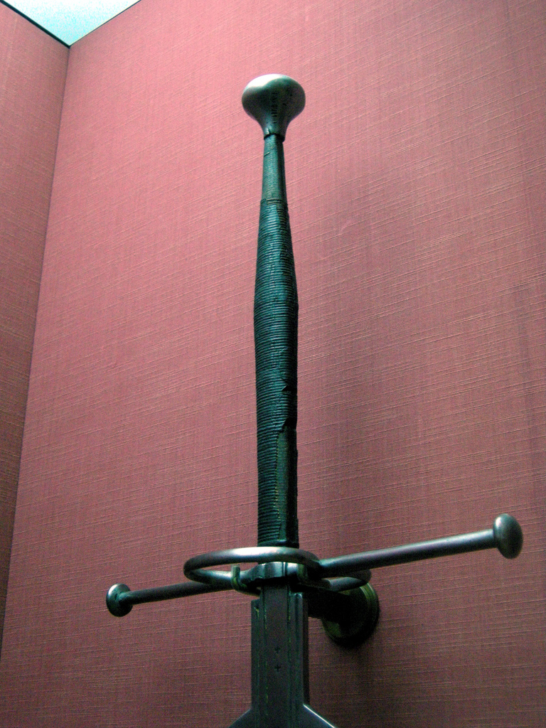

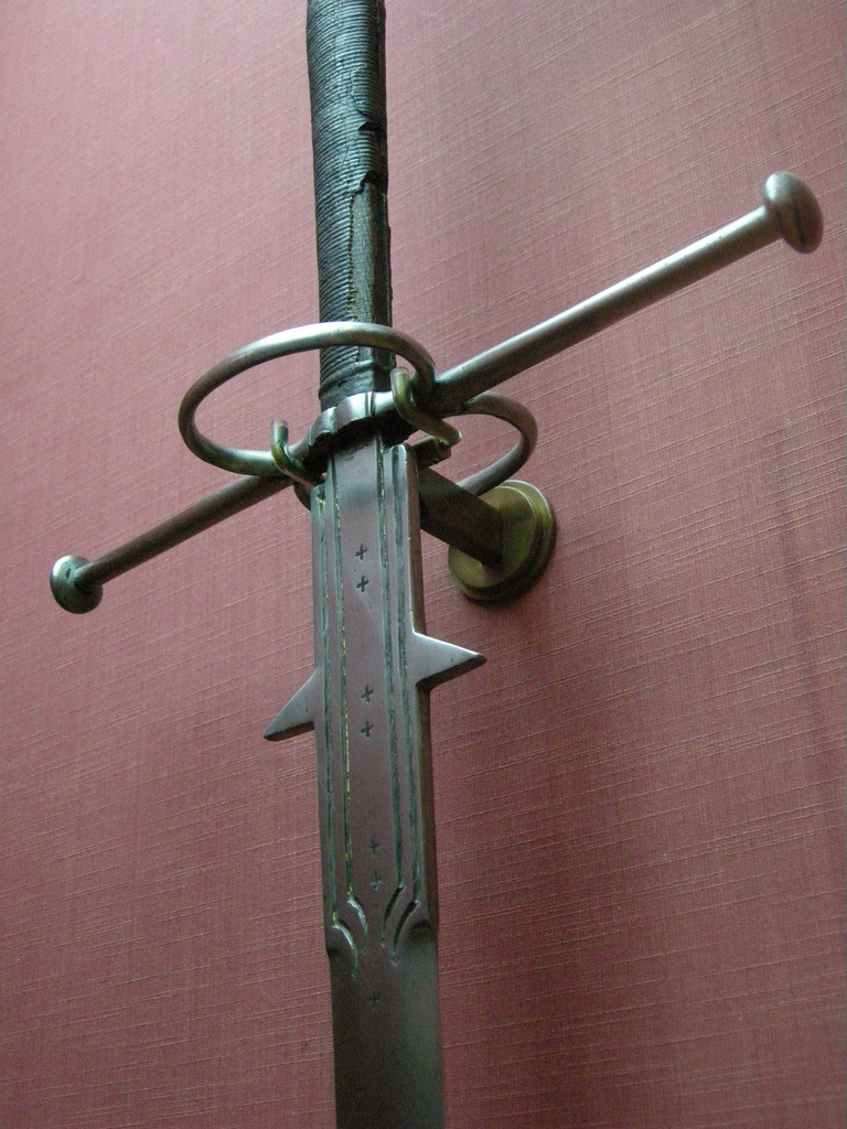

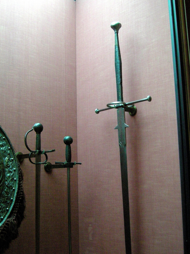

Two handed swords (Montantes) are often mentioned in chronicles of the Portuguese discoveries period, for one.
They were used by nobles, those educated to train with such weapons.
Not many around presently, though ... or they are well kept in private collections.
A couple examples can be seen in Lisbon Military Museum; including those having apparently belonged to notable fiugures; Henry the Navigator and Vasco da Gama

Thank you very much, Fernando. These swords are beautiful!
My understanding is that a montante lays somewhere in between a longsword and a great sword in length and weight. A longsword would be around 120-130cm in length and 1200-1800gm in weight. A great sword is 3-3.5kg and up to 170cm in length. A montante is somewhere in the middle? What are the measurements of the known montantes, such as the ones shown above?
batjka is offline   Reply With Quote
Old 21st March 2015, 05:06 PM   #4
One is 157 cms and another one 175 cms.
