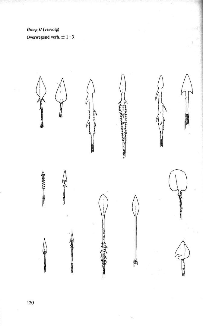

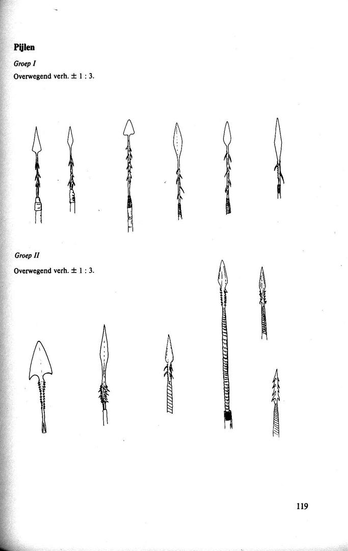

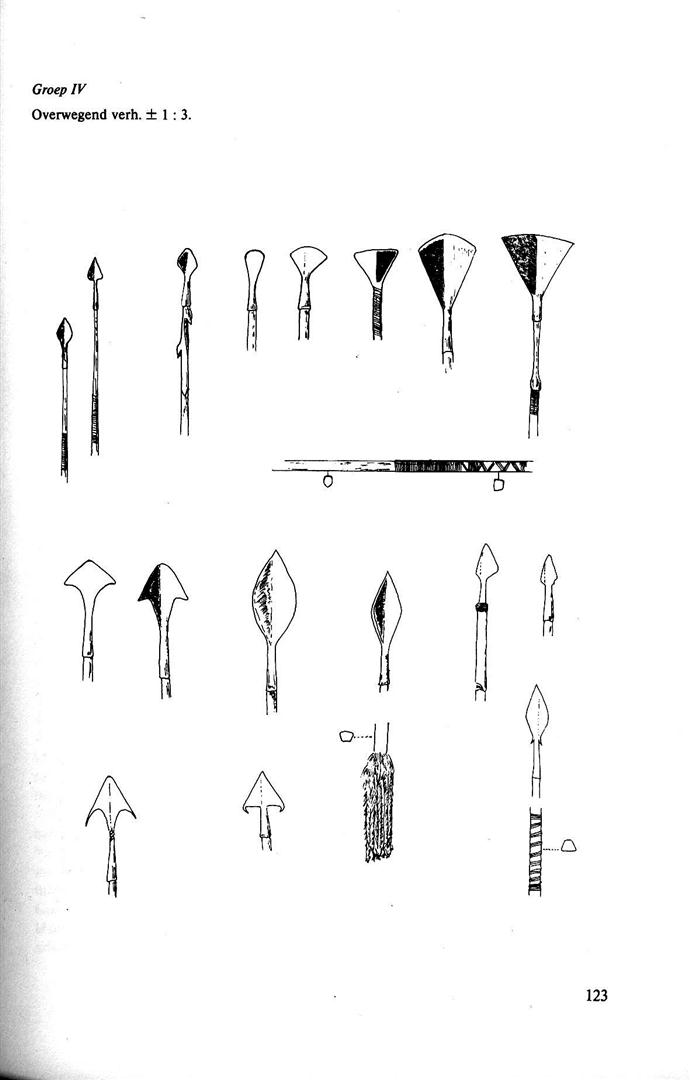

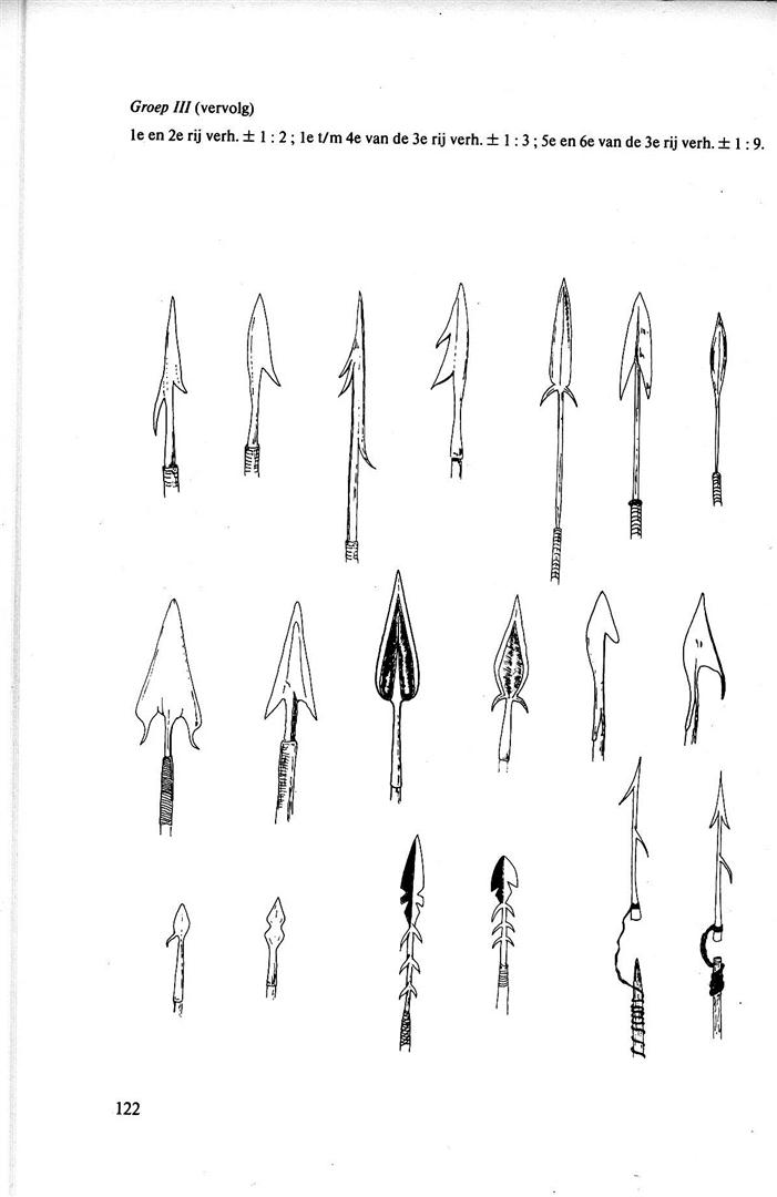

Here a scan of the pages of "Ijzerwerk van Centraal-Afrika" about arrows.

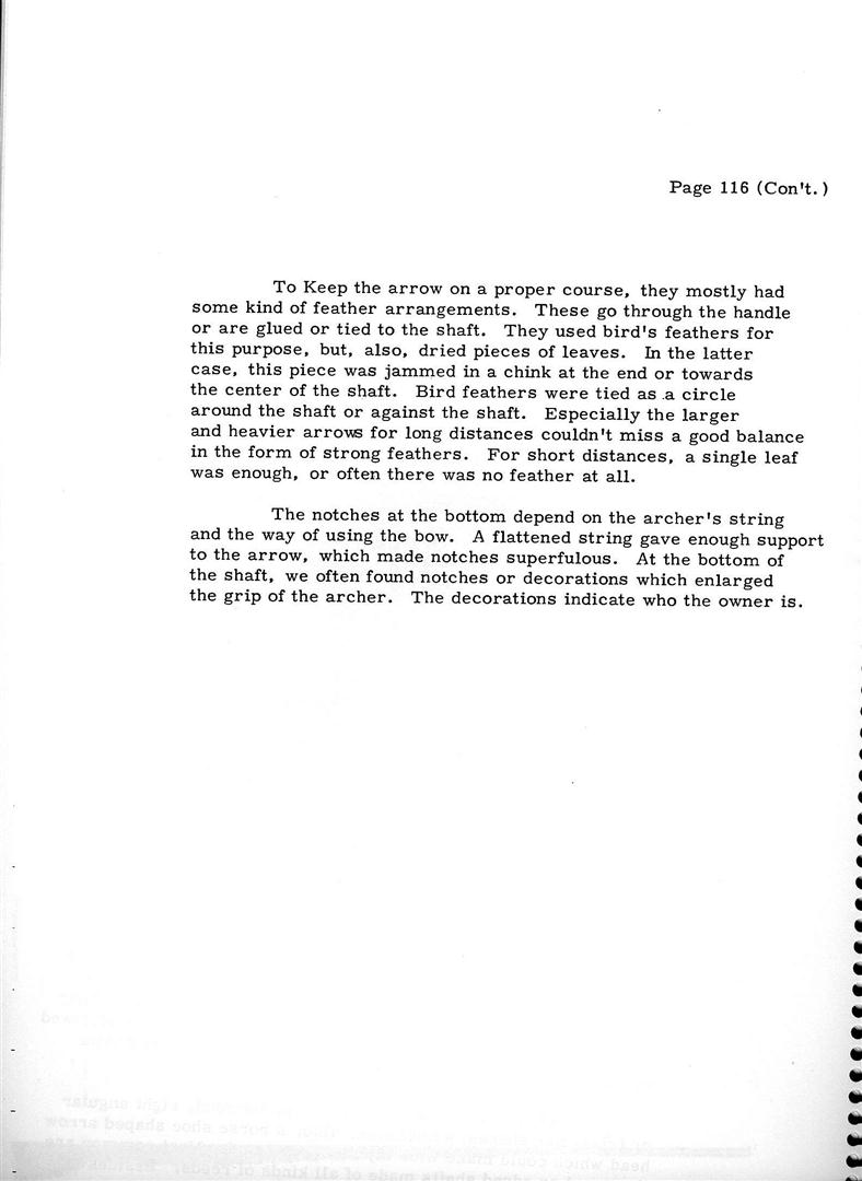

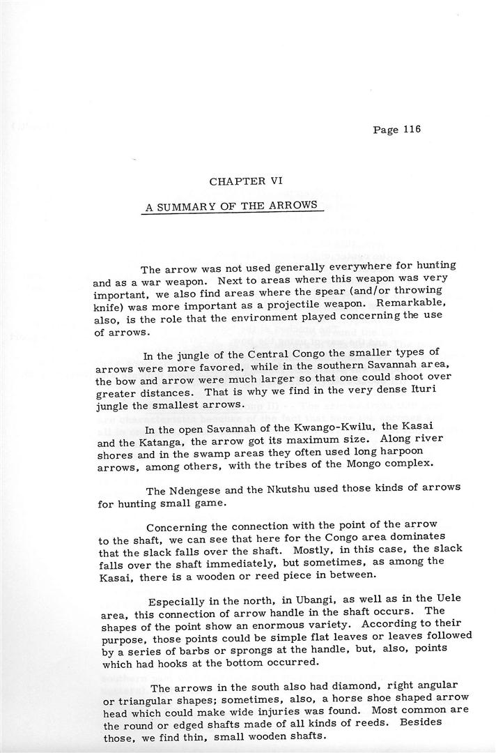

and the chapter about arrows...

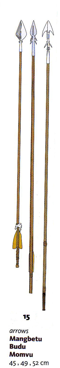

I think your arrow looks like a Mangbetu one, but it's not easy to determine.
