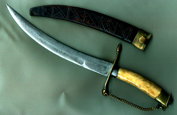

I freely have to admit to having egg on my face over this one (and Justin's too, for that matter ) as I have one nearly identical to Ian's swap item, complete with scabbard only with a simple bone hilt and was told years ago that these were called "kirpans", used by the Sikhs of India.
On the other hand, I've had several with nearly identical hilts that had fullered, damascus blades and, occasionally, reinforced, armor piercing tips and were told that THESE were the ones made for export or take-homes by colonialists, leaving me as confused as embaressed.
In truth, these two are the first that I've seen with the combination of the chain guard and the inlaid MOP hilts.
My next question, I guess, is to ask is anyone else has heard of a "Kirpan" and if there is any validity to the claim that it is a style of knife associated with the Sikhs?
