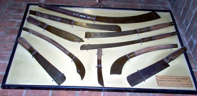

Default Some pre-1889 working dhas from Burma
In case anyone is interested. Not terribly high quality photo, I'm afraid; unfamiliar camera, dark museum, and they were mounted on a wall overhead in a stairway.
These are in the Pitt-Rivers Museum in Oxford. The label reads "Varieties of the Burmese da for various uses. Pres[ente]d by Capt. R.C. Temple R.E., 1889."
I have some shots of Naga daos and spears and some other Asian miscellany from the same museum, if anyone is interested.

nice pic, and interesting. Thanks. That one looks really panabassy, don't it?

Dennee:
Please do post more pictures.
Like many museum collections, mislabeling is quite common. In the photo you show from the Pitt-Rivers, the bottom one on the right is a form of tool, similar to a heavy knife still used for splitting coconuts. The bottom one on the right is also a heavy utility knife.
The second from bottom on the left is a pisau raut (rattan knife), used for splitting rattan into strips. This style is common today in northern Thailand/Cambodia -- the long hilt is rested against the chest and the blade lies on a flat surface, with the rattan being drawn along the cutting edge towards the cutter who is seated. The second from bottom on the left appears to be a heavier bladed variant of the same.
The rest are knives and short swords, some of which are probably Burmese, but a couple of the longer hilted ones could be Thai. Hard to make out the detail of the hilts. Interesting collection of blades.
Thanks for showing these.
Ian.

Excellent points Tom and Andrew, actually the photo that Dennee supplied illustrates this discussion extremely well. As Ian has already correctly identified these I'll talk about the terms in the Thai language used to identify these blades. "meed" is the term used to identify cutting blades in Thai while it can be translated as knife "cutting blade" is more accurate in actual usage. "meed darb" or shortened to just "darb" specifically refers to swords as does the term dha I believe unless modified by a second word.
The rattan knifes in Dennees picture are also called "meed wai", the coconut knifes are called "meed phraa" (chopping blade) now these terms may vary slightly according to region as may the shapes but they all carry the same connotation, that of a utility blade. They were made with a single usage in mind.
