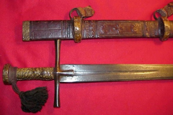

Quite an ordinary kaskara really...
...except for a partially legible stamp near the point - what appears to be "CLMD". Roman numerals? 1650. So not a date then. And why in such an odd place on the blade? The scabbard has Arabic characters. As always, your theories and opinions welcome...

Unusual - I've never seen a mark near the tip of a kaskara blade like that. The only thing I can think of is that the blade is made from a piece of scrap European iron that was originally from a different, much larger object. CLMD is probably just a European manufacturer's or factory mark.

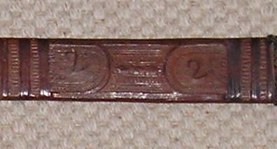

...sorry Dom, by "characters" I meant "letters". Between the suspension rings there are two embossed Arabic letters. They look like the number "2".

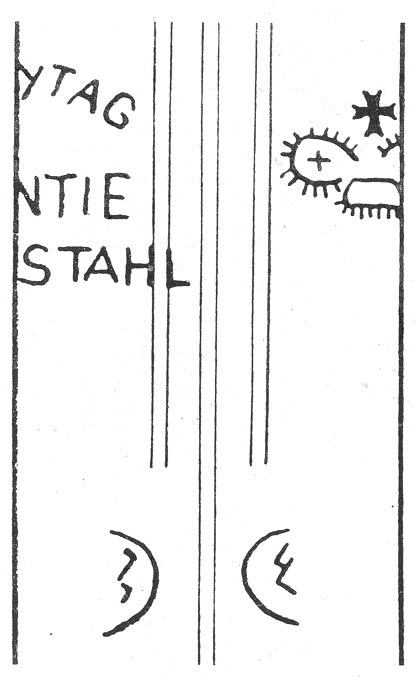

Prof. Briggs (plate XXI b) illustrates (from the literature) a blade with markings that I suspect originated as stampings on European sheet steel later cut and shaped to be a blade. Does your blade appear to be fully forged, or is it, like some kaskara I have, likely due to stock removal.
Hi Stefen
if ... IF they are "letters" they aren't from arabic alphabet

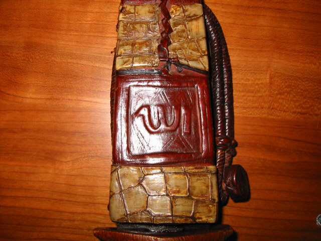

Originally Posted by stephen wood
...oh dear! What could they be? I assumed they were letters as I'd seen similar scabbard decorations posted here...
but here is wrote "ALLAH" ﺍﷲ
on the other ... nothing .. unreadable

... but I've seen the marks that look like 2 on scabbards before - has anyone else seen them? Isn't it H'aa? Like 2 upside down?
