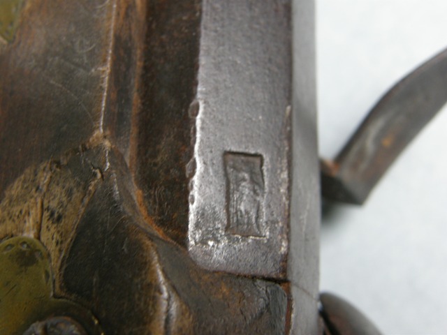

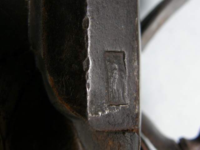

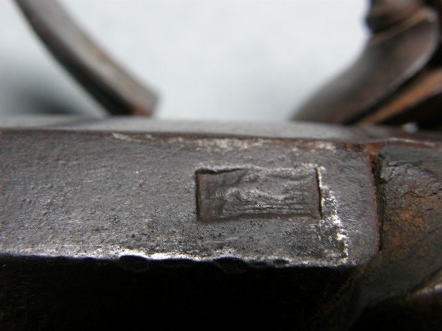

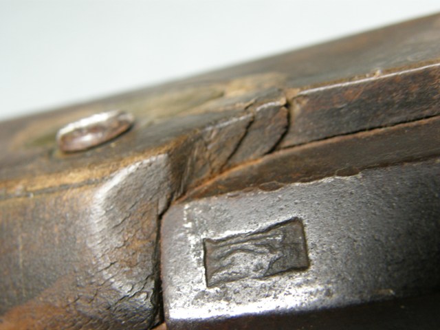

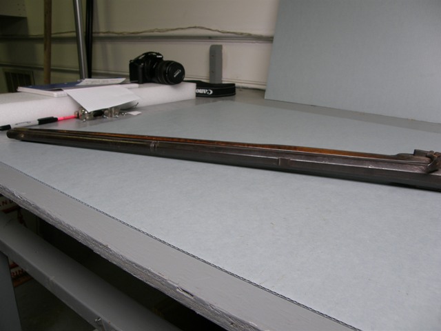

Managed to get some photos of the relic in question. The camera made manifest some details that were impossible to see my first time with it...it does look as if there is a head of some sort on the shaft. Similar to but not exactly like the Kalthoff marks shown above...
The barrel is has a tapering octagonal breech section that terminates in a ring that is 17 1/2 inches from the breech. At present it only has about 12 1/4 more inches to the muzzle. There is a seat for a rear sight about 9 1/2 inches from the breech - whether it is original to it I cannot say, but many earlier 18th century fowlers do have rear sights on them.
Barrel is 1 3/16 (about 3cm) wide at the breech...bore seems to be right at .62. Even where it is cut off the tube is very thin, about a millimeter wall thickness.
Some question was made about the small bore of these "fowlers" - while it is true that a 12 bore throws a much better shot pattern, the lightness of the ammunition and the lightness of the gun made these smaller bores very popular, at least with the natives of this country. Just as the 19th century Northwest guns were about 24 bore, @ 58 caliber - most of the archaeologically recovered guns found in native sites here measure something from .54 to .62

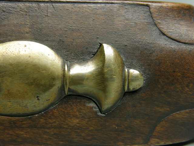

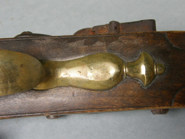

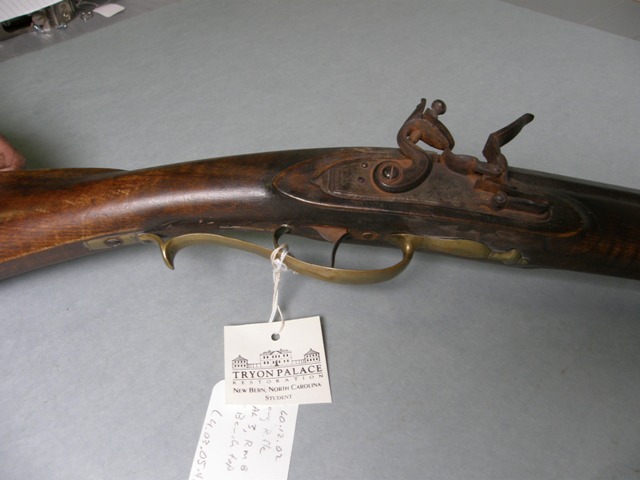

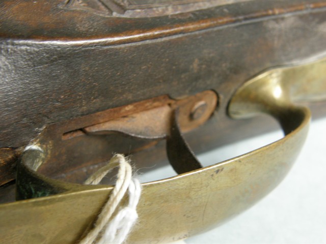

Now for a few of the guard. It has been artfully altered to "rifle style" by being sawn apart and added to. Part of the front finial is gone, I think, and the rear one totally so. But apparent is the thin "neck" at the front of the guard, and the early mid eighteenth century shape still left on the front tang...I think the guard is probably the same age as the barrel...
fahnenschmied is offline   Reply With Quote

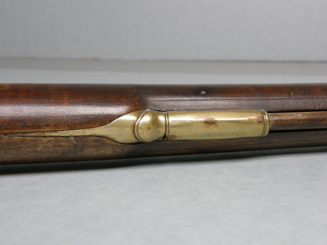

And a parting shot...the entry pipe could also be an original part. It has been filed slightly octagonal...when...hard to say, but I would think that was a later alteration. The one rammer pipe is also similarly shaped.

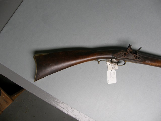

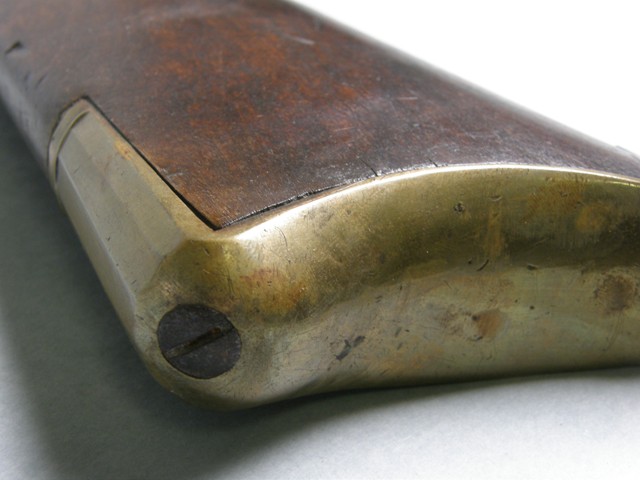

Also a shot of the buttplate, rifle shaped but with odd screw placement, and also a crappy profile, showing the rifle-like lines it got when restocked.

Top of barrel. Not clear but you can see the rings where it goes from octagonal to round. There is a brass based front sight near the muzzle...

Think you need (if possible) to get a look at the underneath of the barrel. The style looks very British to me, but the mark you show says something else. The proof marks (if any) will tell the story.
Regards Stuart
Old 30th September 2009, 07:31 AM   #20
cornelistromp
cornelistromp's Avatar
Join Date: Mar 2009
Posts: 1,071
the Barrel is from the second half of the 17th C and shortened.
(probably made by Matthias Kalthoff Copenhagen, Denmark.)
The lock the all mounts (also the tricker guard) and stock are later from around 1800, also the rounded top shape of the butt points me to northern Europe.
regards from Holland

Yes, thanks again for all the help! I'll see if sometime I can get the conservator to let me take the barrel off and just see what, if anything, is under the stock. I have only handled one presumably Kalthoff weapon, a magazine breechloader type, but I don't remember any barrel markings at all. It was some twenty years ago tho...
Here is a link to a fowler that has a guard much like what is (was, before modification) on our Kalthoff barreled piece. This is just what I thought our gun might have looked like - till I found out the barrel is a bit earlier. Maybe its been on three guns, not two...
http://www.aaawt.com/html/firearms/f398.html
