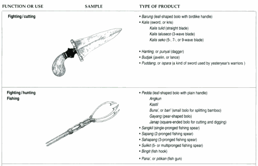

For the first installment below, the mystery blade is the puddang.
A friend told me that it refers to swords and blades generically, and I believe him.
On the other hand, could it also be possible that it refers to the pedang of Sulu's neighbors further down south?
Would anybody be kind enough to post pictures of a pedang here?
Thanks in advance!

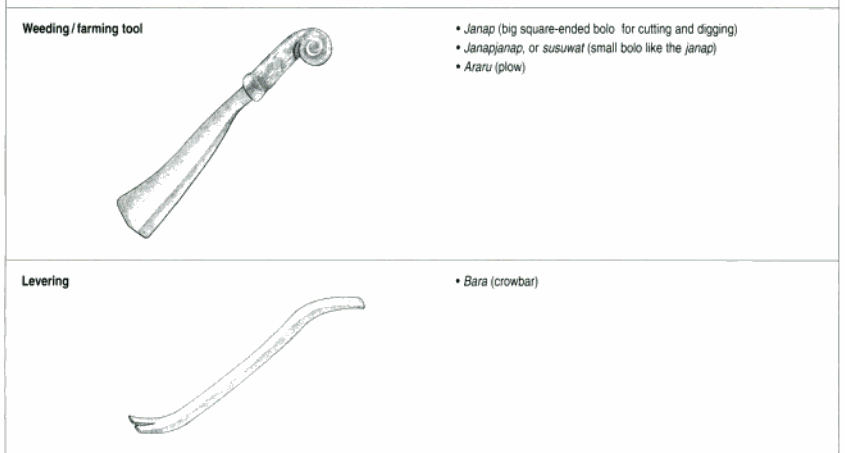

JANAP: noun. A (short working) bolo (having a blunt end which is sharpened to facilitate weeding or digging). Marayaw hipagsuwat in janap ini. This bolo is good for weeding. Cf. utak, lahut.

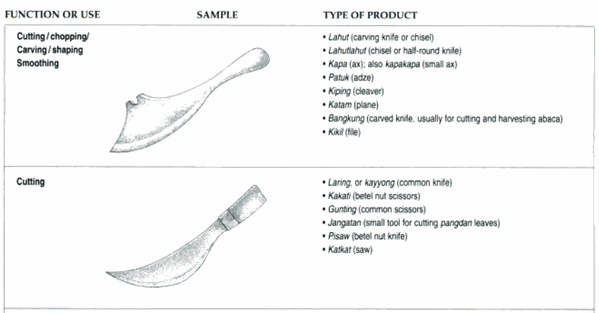

The internet has almost no record of puddang, the sword.
One of the few occurrences would be in the Ukkil book by Ligaya Fernandez-Amilbangsa (2005), per illustrations below --
