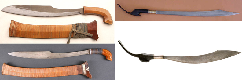

Here are pictures of Piras I've found:
(they're not mine, just ones I found while surfing the web)
Do they they look similar? Yes.
But do they look like the same blade? No.
Two types of Pira?
Now I can understand that locally many varying lengths and sizes of the same blade type can be found, but Piras, Yakan's favored blade I'm told, consistently come in TWO forms... the one with the hump (which I've handled and used before) and the klewang-like one. One has a lobe at the tip's end, not unlike the Chinese Ox-tail saber or the Turkish Kilij in practice. However the other (usually larger and more sword-like) Pira has a look very similar to klewang from Sumba, Timor, etc. See below:
Now, I've heard different stories. Some folks say the Pira was down-sized and the arm guard removed to make it better for solely utility purposes. But the lobe/hump? Why two distinctly different forms of the same weapon? Some Garab/talibon were better choppers, and others had a long point for thrusting, but all can be identified by the same type of handles and blade shapes. The two different Piras look to have two different roles... sword and short-sword/machete.
So Why two?
I can see two possibilities for why the hump-back Pira was developed. Please help me out if I am incorrect here...
[1] If the hump-back Pira only began to appeared when klewang-Piras were in decline, we can see it as when the Moros were being disarmed or giving up the sword for the assault rifle. Thus what was previous a sword that was also good for hacking through vegetation became a "machete"-type blade, for bushwhacking and butchery, maybe even a side-arm for the insurgent.
[2] Perhaps they were two closely linked blades but there were and has always been two distinct types of Yakan blades - hump-back Pira for work, klewang-Pira for war. That is a possibility.

I'm not seeing a great similarity in the tips you have illustrated .
I'd be willing to bet that the Pira you have shown in the lower right of your four examples is probably the oldest form .
The example you show above it seems to be mid 20thC; it certainly has a pira hilt but the blade seems a bit generic .
Two styles sharing the same name but very different forms ?
Old 17th August 2009, 04:35 PM   #3
Posts: 7,416
I agree with Rick, the upper left is the newest form that came from the oldest form, the lower right.

Ok, so the shorter hump-back Pira comes after the sword-like Pira?
Why the new form? is it because of reasons I guessed at earlier (shift in weaponry, disarming, utility vs. war), or ones I had not considered?

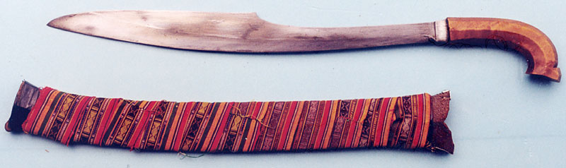

Smile No answers, just another data point and some speculation
This pira was purchased in the market in Zamboanga City in the mid 1970s. I recall that the stall had a number of what I remember as huge kris-like blades with silver wire inlay (tourist versus real I cannot say now), but this was the one thing that caught my novice eye (I recall the brass in the stall was pretty touristy). The scabbard has been wrapped with black plastic electrical tape - so much like what I would have done in that time - but in this case it came to me like that, loosely over-wrapped with the strip of cloth. It did not strike me as being really old, maybe about a decade (though it now looks much the same after I have had it nearly 35 years!), but it did have some evidence of use and work staining and light bleaching of the handle and scabbard. It was and remains incredibly sharp. I have always regarded it first as a tool, but clearly it could very effectively serve as a weapon. So, I'll speculate that this is a utilitarian tool. To me, it is a distinct type, as opposed to being evolved from the somewhat more flamboyant weapon.

I believe that you are correct and that the "humpback" version is the modern predecessor of the more elegant old style.

Possibly we are looking at the de-evolution of a pure weapon to an agricultural tool .
Notice the less pronounced belly in the blade of the newer examples; better for brush than very curved for human targets .I think that if you take the upper side of the point of the oldest example and carry that line closer to the hilt you wind up with the agricultural form .

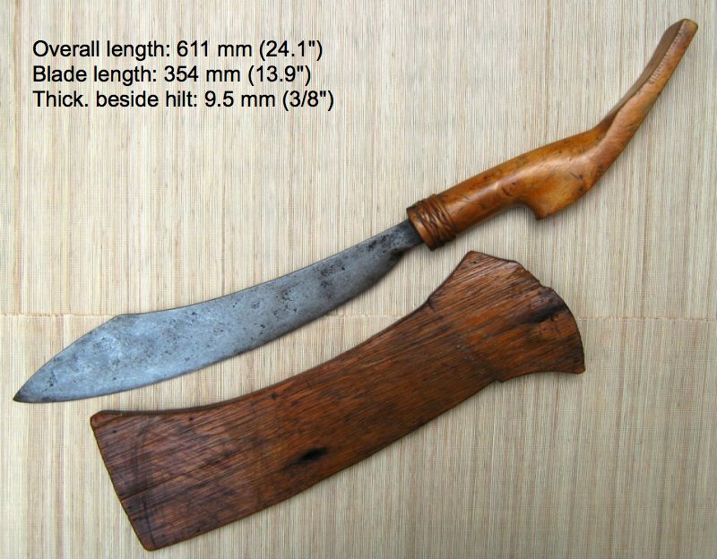

Here's the oldest pira I have, which is my pride and joy
