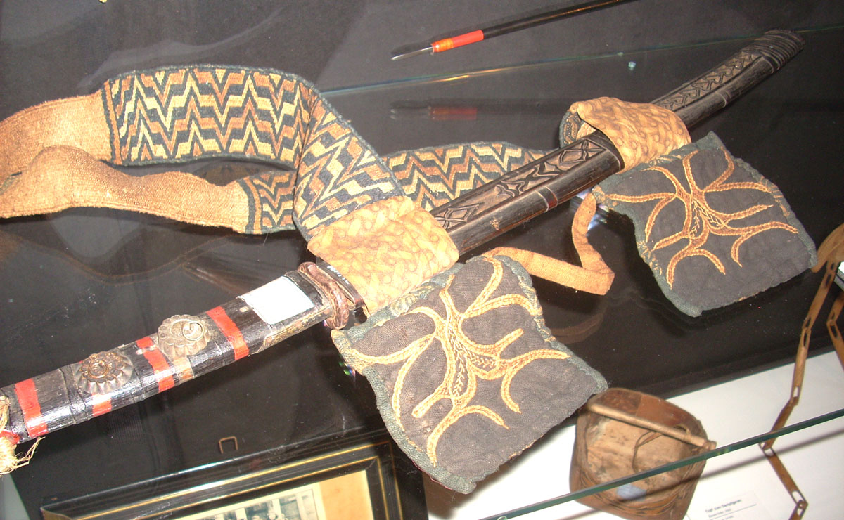

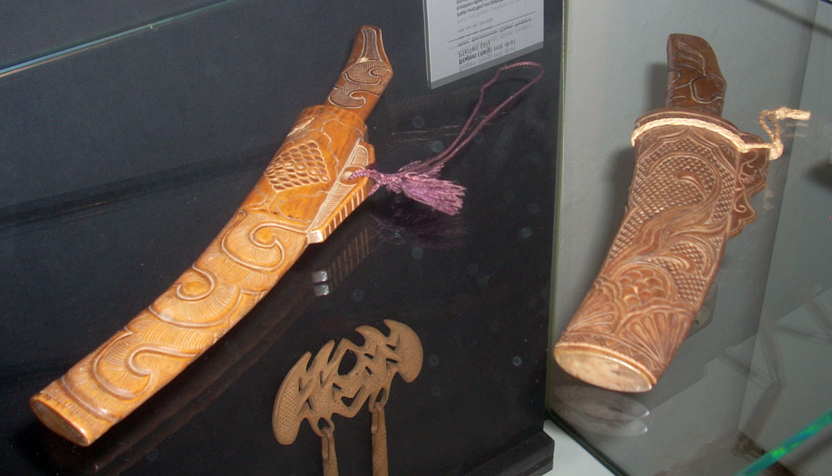

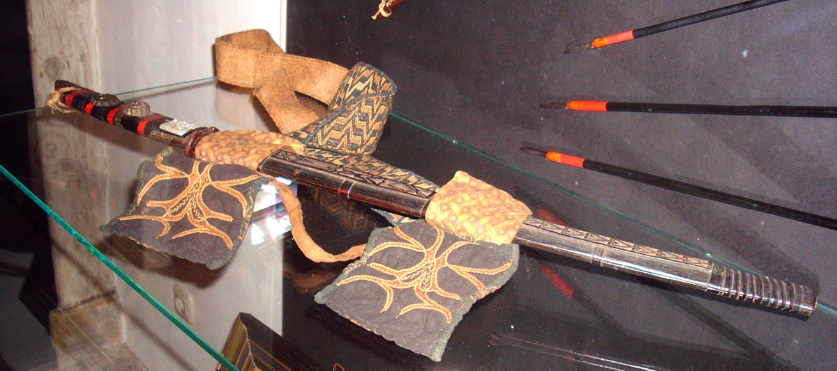

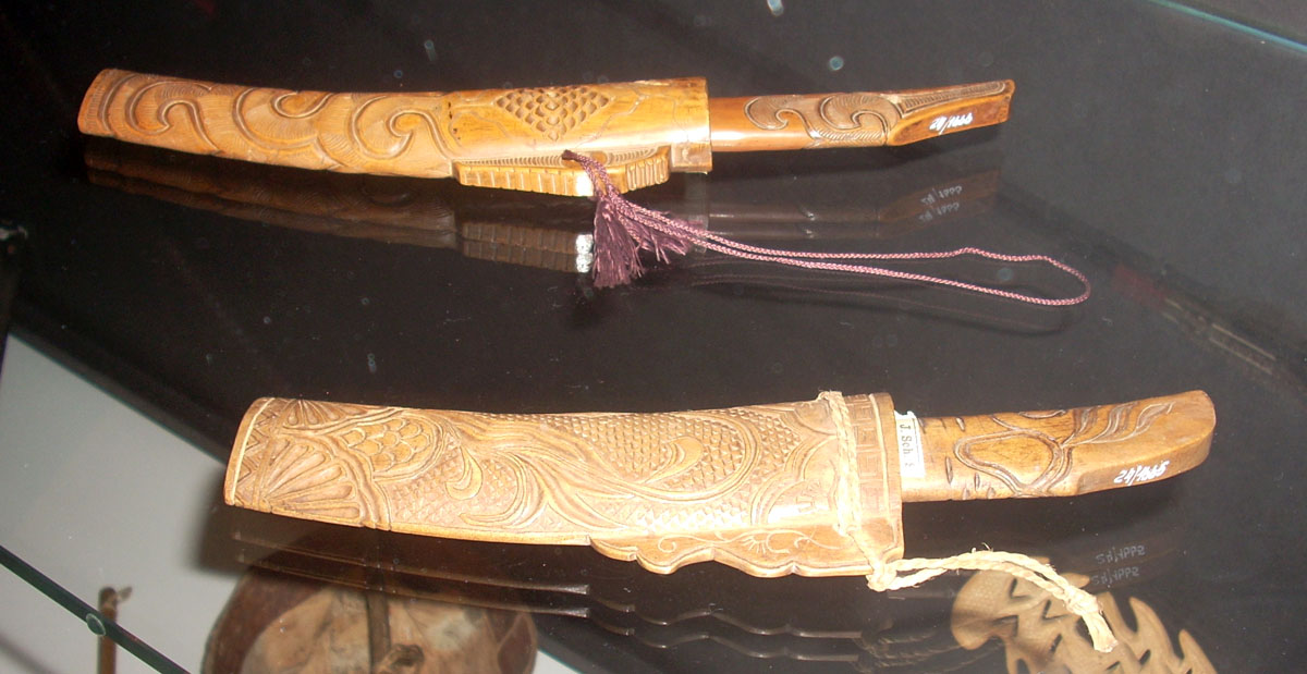

I have taken once a couple of pictures of Aynu knifes and sword during the temporary exhibition held in Bamberg (it was dedicated to one old German private collection of Asian Art). It was told also that they normally have Japanese blades, but no blade was visible. Maybe it will help…

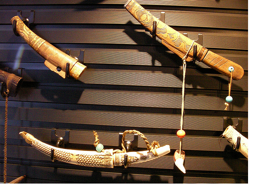

I spend some time googling and found a photo of an Ainu exebition wher they displayed a knife what has a lot in common with my example.
Here it is pasted into paint etc..:

What stays however is that the knife below wich has the same handle as my example ( on the pics Willem listed )is on display in an Ainu museum on Hokkaido. ( Nibutani Ainu cultural museum ,Hokkaido)
