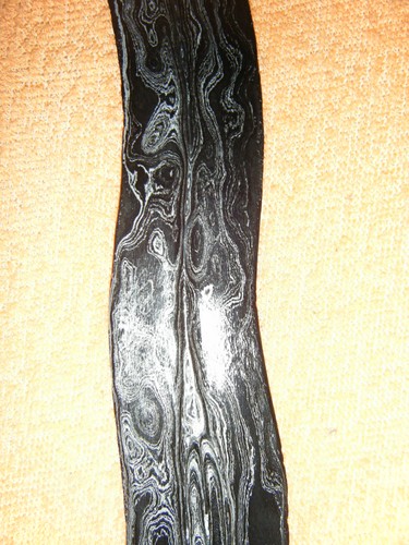

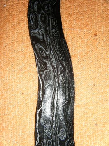

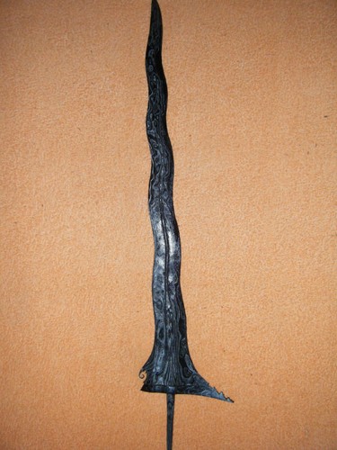

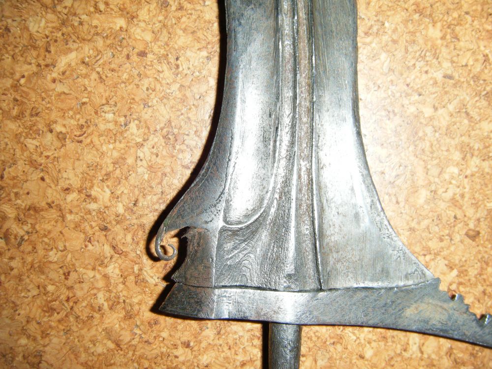

I buy this keris blade from e-bay because I like the shape of the blade.
All informations and inputs are welcome. The blade is 16,75 in / 42,55 cm.

From what I can see it looks nicely executed .
I like the ada ada and the strongly defined work in the sorsoran .
Any ideas yourself, Ferry ?
E. Jawa ?

Thank you Rick for comment. Yes, my guess is also East Java. The long ada ada I also like. Any ideas which dapur this can be?

Ferry,
Regarding the ricikan (details) of your keris, that has a sekar kacang, tikel alis, two sogokan (front and rear), sraweyan, greneng and mainly with ada-ada (a little bit gigir lembu) -- then it has characteristics of keris of dhapur "panimbal". The problem is, panimbal usually has two lambe gajah. But yours has only one...
GANJAWULUNG

In my opinion, not a Javanese blade.
That is not a Javanese ada-ada, the ron dha is abysmal, but the overall garap is Bali --- and the length:- 16"? Jawa? Nggak.
I reckon this is a Lombok blade --- they seem to like those funny sticky up ada - ada.

This is looks like an unfinished keris for me. you can see there are so many areas with clumsy tool mark. the sraweyan is not smooth(need more work on this), the pijetan/blumbangan, the gandik, the sirah cecak, another hours of smoothing job would make it beautifull.
FERRYLAKI

Its finished Ferry --- according to the man who made it.
Its just not finished to a high standard. Don't forget that very often a lowly keris will be made with very limited tools. The final finishing was often done with pieces of stone or terra cotta, and the final polish with ground terra cotta and water, or ground coral and water.

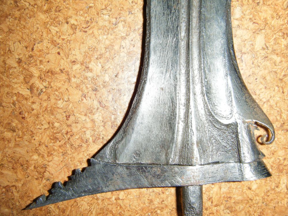

I think it is difficult to see it clearly on the pictures from the seller, it is an old blade and what we see is maybe only corrosion. The blade have had maybe harder corrosion and is repolished and this not smooth?
I will try to make better pics when I hold it in my hands.
sajen

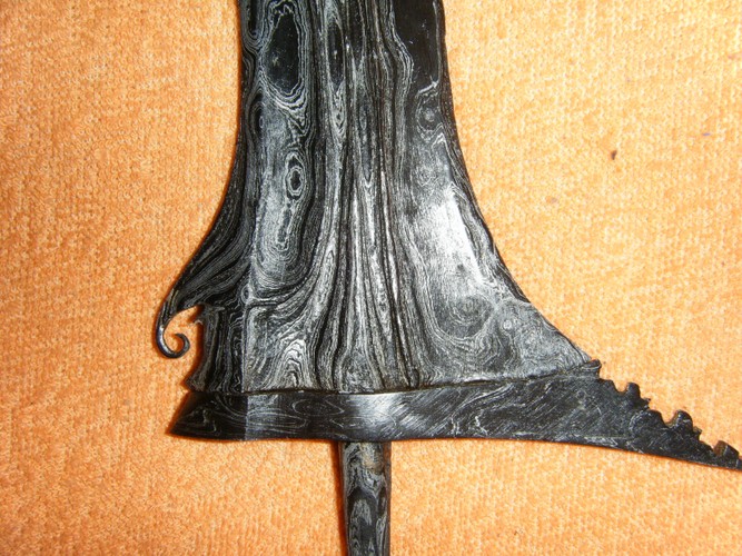

received the blade and it seems to my eyes that the not smooth finish of the blade is a mixture between a really not smooth finish of the blade and maybe a grit blasting and cleaning with crude tools to remove corrosion from a former owner of the blade. You can see many cratches from a file at the blade and unevennesses at the complete blade what let me think that the blade is cleaned by grit/sand blasting one time. It's a shame!
sajen

A few hours with wet & dry paper, a light re-etch, and you'll have something pretty OK.
When we buy keris from outside the culture it is not at all unusual to expect to have to do a bit of work to bring them to where they should be.

It looks better in your photograph. look at the pijetan and blumbangan. it still untouched and shows us that it is an old keris. the sogokan loks very fine, the kembang kacang is strong. good luck with the sanding process. you'll find this keris more attractive and beautiful. what style of sarong would you like? 16 inch keris is a little bit longer for a javanese keris, I agree with Alan. or maybe you've already have a warangka for this keris?

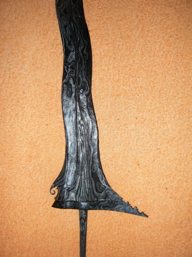

After all the time also this blade has get a new stain and the blade shows a fine pamor. Still don't have a sarung for this blade but like you see I don't forget my blades also when it need some time!
Do you think that this blade is it worth to get a proper sarung?
Old 17th July 2011, 05:22 PM   #20
Posts: 7,303
Detlef, another fine job bringing an old blade back to life. I certainly thing it deserves some good dressing and would recommend something in a Bali form since i believe Alan was probably right about this being a Lombok blade.
Old 17th July 2011, 05:38 PM   #21

agree with you and Alan that it is a Lombok blade. Let us see what I will be able to manage the next years!

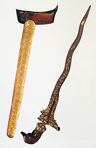

Thks David for your opinion....and to certain extent I agree... but pls take a look at this pic

Thanks Penangsang. I have taken a good look at the keris you have posted and don't understand how it relates to what i have said. Could you explain?
