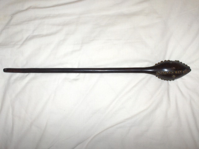

Please has anyone any ideas as to origin of this kerrie/stick ? I have seen similar attributed to the Zulu and, similar designed heads on other African clubs. Seems to have decent age.My 'gut feeling' is that it is African and early 20th C ....any suggestions, thank you
OAL 89 cms 'head' 8.5 cms 'high', 5.5 cms at the widest section

Hi David
I'm fairly sure its African, but can't say definitely whether from Southern or Eastern Africa. Most likely Southern, they carved sticks and clubs in all sorts of shape varieties...a nice piece.
Colin
Old 24th June 2009, 05:50 PM   #3
Posts: 6,010
I would agree with Colin that it is African. Just what I like too.

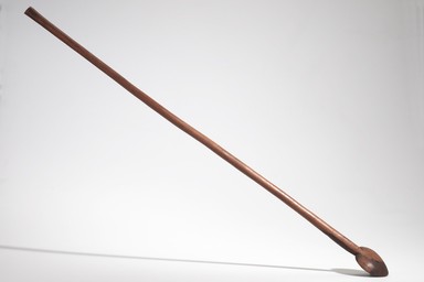

So I think we agree 'African' ......the closest example I could find was 'deemed' Zulu (pic below) on this website (well worth a visit they have a wonderful collection spanning the world)
http://anthro.amnh.org/anthro_coll.shtml
Kind Regards David

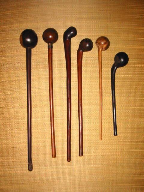

check the link Tim made the same comment on a similar shaped club a while back. Also that reddish wood seems to be Rhodesian Teak as seen on many Gogo tribe clubs most Zulu clubs have made from bicolored or brown coffee colored wood(Assegai wood). In the pic below the two center clubs are of the same wood as Tim's club and they hail from farther north.

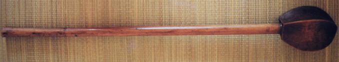

Here are a couple of images of a stick I once had, that was from one of the Nguni tribes of South East Africa (eg. Zulu, Swazi, Xhosa), for comparison.
From the top, the outline is a bit similar to Katana's example, but not conclusively so.
The South East African tribes were excellent, artistic woodcarvers and I believe they (the men) usually liked to carry a stick or staff of some sort, partly for defence but also with a strong element of display/part of costume. Hence the wide variety of stylish shapes, protusions, heads etc.

Thank you Lew and Colin for the extra input. Lew, it is a shame that we do not have a resource whereby the wood used to make the clubs is not noted....it would certainly help to ID origins.
Nice club Colin....very unusual, never seen this design before.
