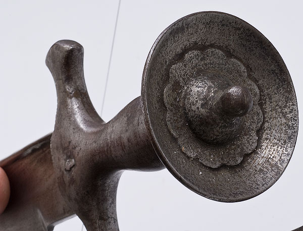

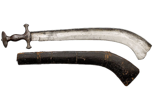

Plate 41 in Rawson depicts two "Koras with sheaths covered with velvet; chapes and lockets of pierced and chased silver. From the collection of King Frederick VI. National Museum, Copenhagen".
This image from John Powell shows a much more utilitarian version:
Berkley is offline   Reply With Quote

Hello Denee, do you still have access to those photo's? as I was speaking to a friend of mine, who has travelled extensively in Tibet, and he has not seen any Kora/khunda being used there at all, only the traditional Tibetan swords and knives.
Nice picture Berkley, that appears to be a wooden handle on the khunda? The initial problem regarding Rawson works, appears to be no Nepalese input on the khunda.

The grip is leather wrapped ferrous metal.
My reference to Rawson was for the purpose of directing the reader to his photographs, which speak for themselves - the proverbial 1000 words, as it were, in neither Nepali nor English.

Thanks for the answer on the handle Berkley, it looks to have a great grip.

Old 13th May 2009, 06:56 PM   #30
Norman McCormick
Norman McCormick's Avatar
Posts: 1,657
Hi,
Found these photographs on the net, the arrangement at the ricasso appears unusual for a Kora plus the pin through the hilt and scabbard stylistically, I think, points to an Indian origin for this piece. The langets look like they may have been removed from the hilt, whether this was done to an original blade/hilt marriage or the hilt has been removed from another weapon and modified and added at a later date is difficult to ascertain. The decoration on the pommel is very similar to a Tulwar I have, see thread entitled 'Tulwar Inscription'. Interesting discussion so far.
Norman.
