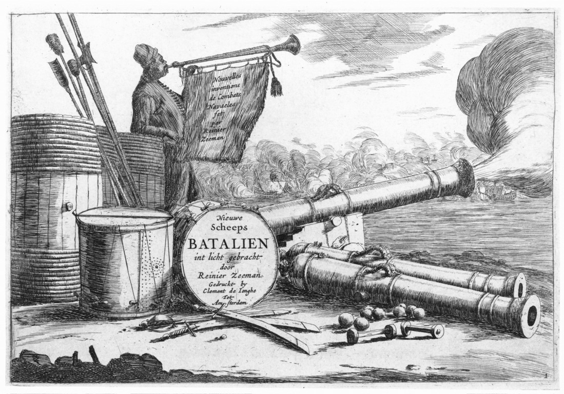

Hi Captain,
Can i illustrate your thread with this interesting image; in that we see that barshot was already in action during the 17th century.
(Courtesy of an email sent by Jan Piet Puype to Cathey and Rex about cutlasses)

Excellent pic, Fernando. It would be nice if it piqued a few comments again. I have learned that the barshot pictured (the type with the hockey puck-type ends ) was a French pattern, as seen on the wreck of the Mashault and others. The classic 'half spheres' were popular with British ships and the two whole spheres with square bar are used by multiple countries (Britain, the Netherlands, etc). I believe the odd wedge-shaped (door knob shaped) shot was a French pattern as well.

...I have learned that the barshot pictured (the type with the hockey puck-type ends ) was a French pattern, as seen on the wreck of the Mashault and others...
Yet in the picture, barshot depicted have puck-type ends and the author of the work is Dutch
