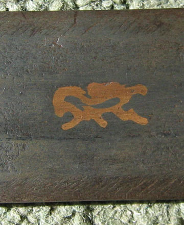

I would be very grateful if anyone could give me an idea of the reading of these Arabic texts which are inscribed on a kaskara blade.
The blade itself is stamped with an orb and a lion as per Pallme's footnote, which might date it as early as 1837 although I expect the engraving is later.
It is not as long as usual (31") showing no sign of having been shortened and handles very well.

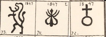

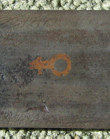

I have posted this one of mine a couple times. The marks are attributed to Peter Kull the print is from Geschichte Der Solinger Klingenindustrie by R. Cronau.
I hope this helps.

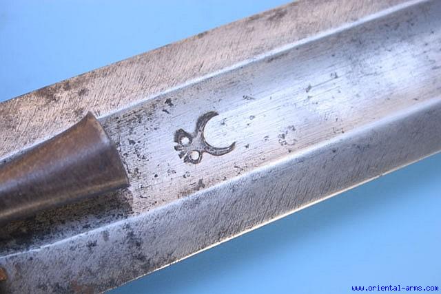

Thanks...did that sword come from Artzi (Oriental Arms)? There was one on his site before which looked quite old. When I saw him at the London Arms Fair he mentioned seeing one with those marks there (it was in my bag by then ).

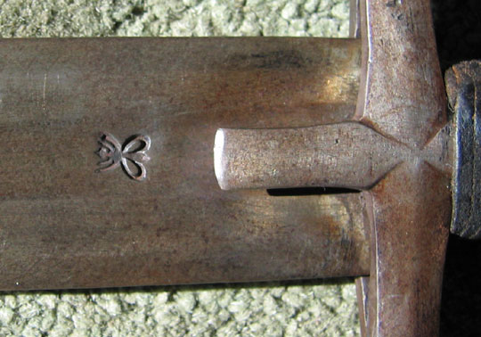

In the Pallme text Peter Knell is presumably Peter Kull. He gives very precise dimensions which suggest that blade length was standard by that time. The nearest I could find to the Death's Head mark is below...
Would the inlay have been done as part of the forging process or later?

No I got this one quite a few years ago, it was about to be taken apart to have its "original" crusader style hilt placed on it . I did see a similar one on Artzi's site a few years ago. The inlay was added to the original makers marks later, most likely locally. It appears to be a red gold. The example you show is not the deaths head mark it is a swallow tail butterfly for a yet unknown maker. The only death's head I have seen is on this thread http://www.vikingsword.com/vb/showth...ght=skull+kull this is apparently on a kilij which doesn't make sense, unless it was converted to a kilij from a original broad sword. Unfortunately Teodor was not able to show the blade to confirm this.

...that has to be it. The pierced tang is exactly what I would expect to see on a kaskara blade. It also fits Pallme's comment that the imported blades are "...rounded off inferiorly".
