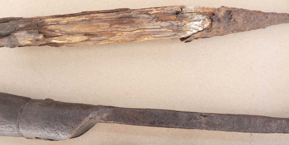

This is another topic on a kind of important early gun accouterments almost never discussed.
Igniting irons were used to manually ignite all sorts of pieces of artillery, from the biggest cannon to haquebuts and even small handguns, even well after igniting mechanisms had come into general use. With all those little noise makers (Böller) employed in alpine regions they never actually seem to have vanished before ca. WW II.
We know from original sources of information that, when needed, their heads were kept red hot in a bowl filled with live coal and finally put down the touchhole.
It is true that the earliest igniting device documented together with the earliest known illustration of a gun in the famous de Milemete ms. at Christ Church, Oxford, dated 1326, is clearly a short stick with a split upper portion and a glowing piece of tinder jammed between the jaws which could be termed a sort of linstock (first attachments). However, we have no further records of linstocks for almost 200 years after.
The next two contemporary sources of illustration attached are from Konrad Kyeser's Bellifortis of 1405, both depicting a rectangular thin archetype of iron mounted on a short wooden haft. We may therefore assume that that was the usual type of 14th to early15th century igniting devices. The oldest known actual singular piece of identical type, although in excavated condition retaining a portion of its original haft, is in my collection (see attachments).
Hence forward, 15th century practical experience seems to have developped a reinforced pear like shape of the igniting head with a thin prick to it to reach down the touchhole; the larger mass of the iron was of course apt to keep the heat for longer. Due to the nature of their use - kept red hot for hours and hence calcined, then, after left rusting away for months, bearing the same procedure all over again and again - the actual touch prick of those igniting irons has in most cases gone of surviving examples.
Again, relying on illustrative sources, linstocks with jammed in glowing tinder or smoldering slow match do not seem to have seen wider use before ca. 1500 when they were depicted in the Maximilian arsenal books (Maximilianische Zeugbücher), ca. 1502-1507. Allthough match linstocks seem to have taken over for at least half a thousand centuries from now, we still know of some large samples of early 18th century heavy artillery accouterments retaining their original igniting irons mounted on long hafts and forming part of the equipment of their original carriages.
The singular short linstock, early to mid 16th c., with the two piece zoomorphic head retaining its original blackened haft together with its original tarred cord binding on the rearward grip plus a pointed iron shoe finial for ramming the piece into the ground on intermitted action, is also in my collection while most images of other igniting irons were gathered together from various sources.

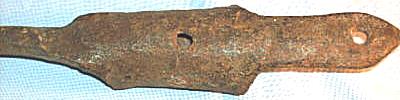

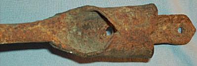

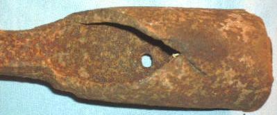

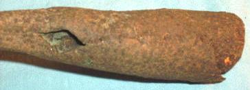

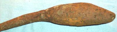

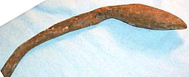

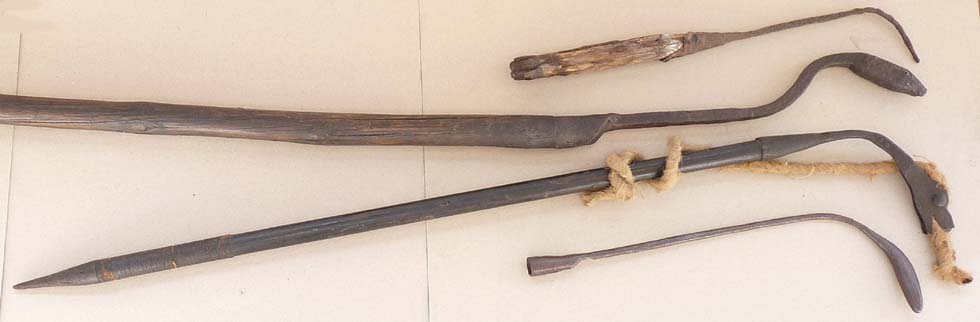

More igniting irons of uncertain dates, probably 15th to 18th centuries, some of them retaining their igniting pricks.

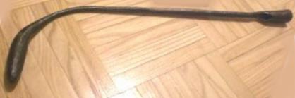

Another one retaining its igniting prick.
Michael

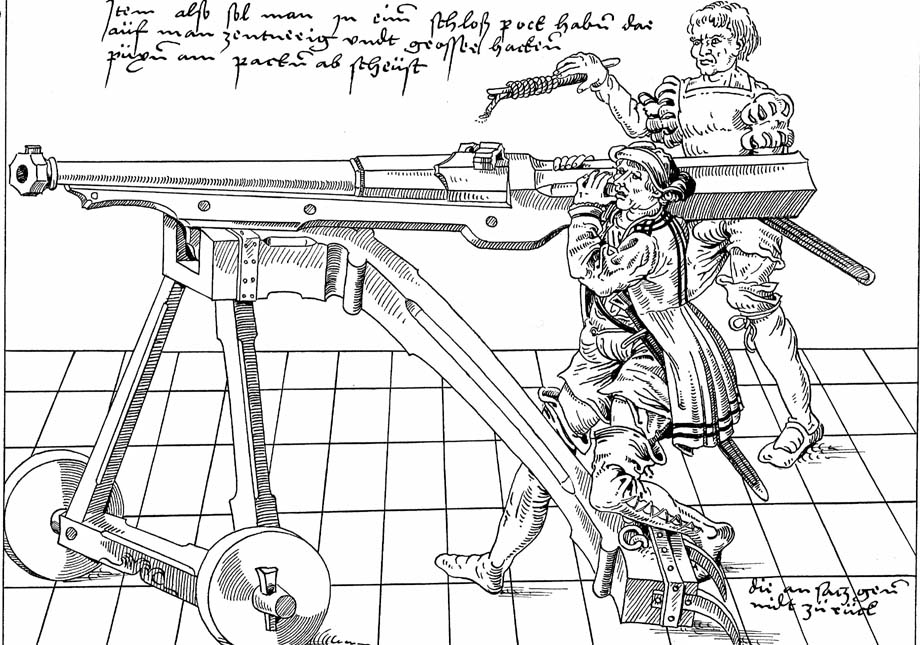

Posts: 4,310
Ignition of a tripod mounted Doppelhaken (wall piece), early 16th century, using a match clamp.

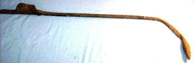

Old 22nd September 2009, 04:30 PM   #12
Matchlock
Matchlock's Avatar
Join Date: Sep 2008
Posts: 4,310

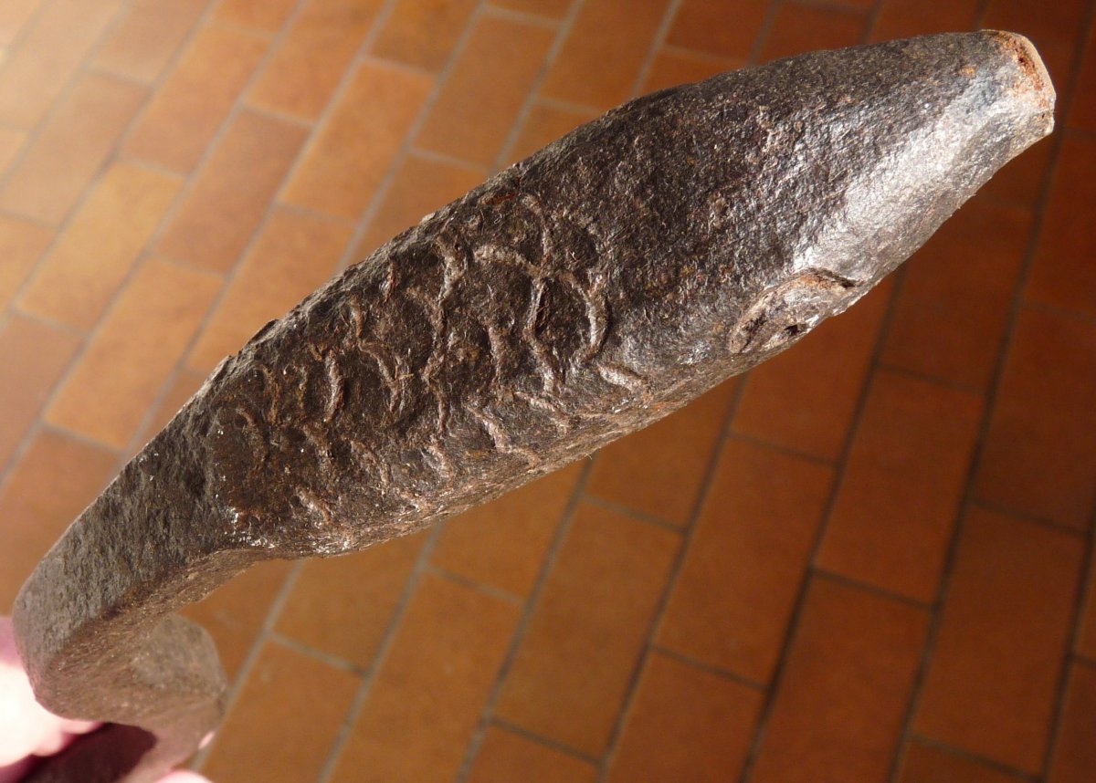

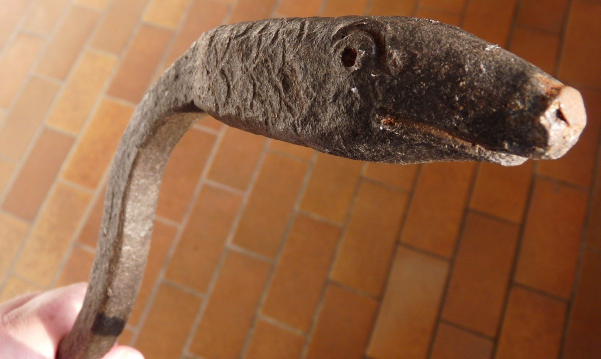

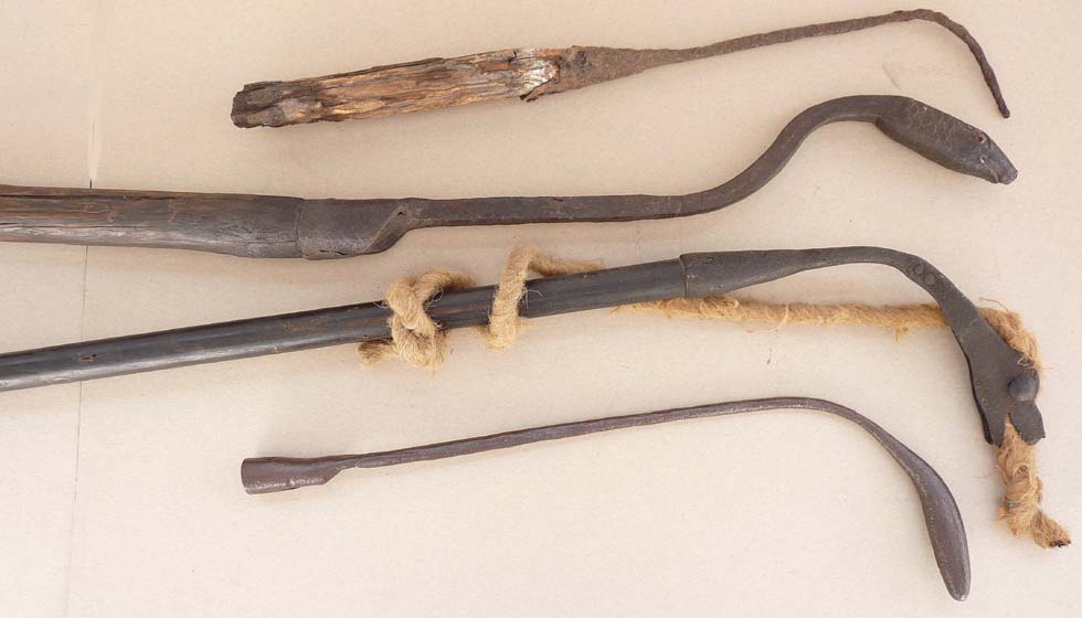

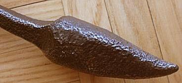

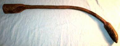

Default My latest acquisition
Hi there,
I am not dead, just been having some unpleasant times but I am back again with you now.
This is to present my latest acquisition, a gift from a friend of mine whom I was able to do a big favor:
an extremely rare Austrian igniting iron, ca. 1500/early 16th century, the zoomorphic head formed like that of a serpent and punched with scales, eyes, and a mouth. Originally the snout was a bit longer and probably ended pointed but that of course has rusted away in the course of the centuries and the many alternating heats the item was exposed to.
It is shown together with better images of my other three, the dates being from top:
- 14th century, the earliest known
- ca. 1500 to early 16th century
- 1st half 16th century, actually a linstock for match
- ca. 16th to 18th century
Michael

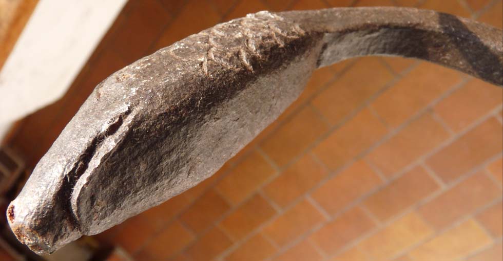

Posts: 4,310

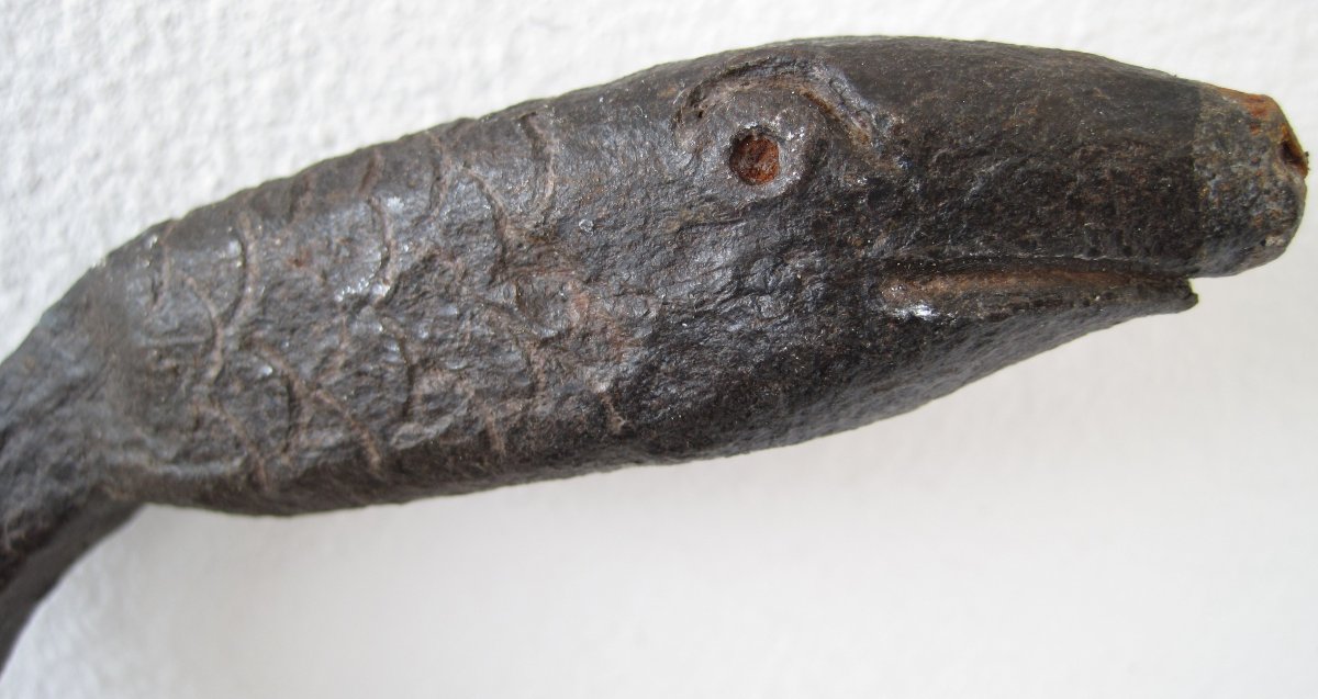

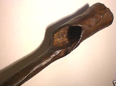

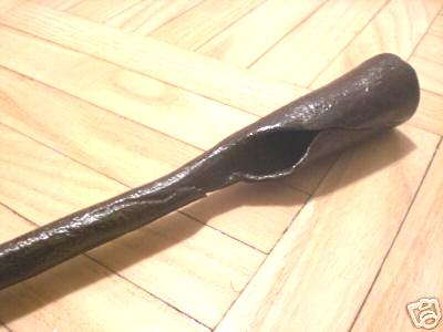

Default Details of my serpent head igniting iron
Now ain't that a cute serpent's face?
Michael
Old 25th September 2009, 01:16 AM   #19
M ELEY
Location: NC, U.S.A.
Posts: 2,236
Wow! Now that looks positively ethnographic! Yes, I know it's not, but if you didn't know it wasn't Indopersian or Africanic, you might question it. I wonder why this particular igniting device is decorated so while others are so plain. Than again, I have also noticed this with linstocks...some are decorated or intricate designs, while others are strictly utilitarian. Still, its interesting to think about what the blacksmith who made yours might have been thinking about. Kinda like- 'Hmmm. I'm bored. Looking forward to going fishing this weekend. Sayyy...I wonder if I can make this thing look like a trout!"

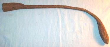

Default Earliest Igniting Irons

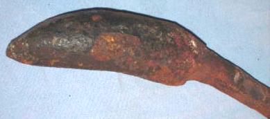

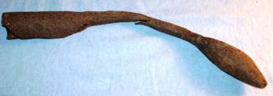

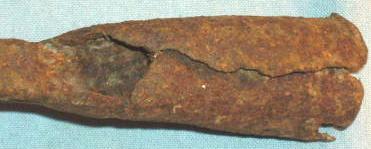

The smallest sample in my collection, posted formerly, the one with the fragmented haft, is the earliest known to have actually survived!
As I pointed out above, the dating criteria are based on its characteristic shape: very thin, delicate and fragile, and with almost rectangularly curved prick.
In addition to the only two related pieces of period artwork known hitherto I posted here, I found some more dating from ca. 1460, in an illuminated Gothic codex by Jean Mansel, La fleur des histoires, preserved in the Geneva library, Ms fr. 64. One of these fine and important miniatures contains the second earliest representation I have seen that is historicaly and technically correct enough to also depict the pan with live coal for heating the igniting iron!

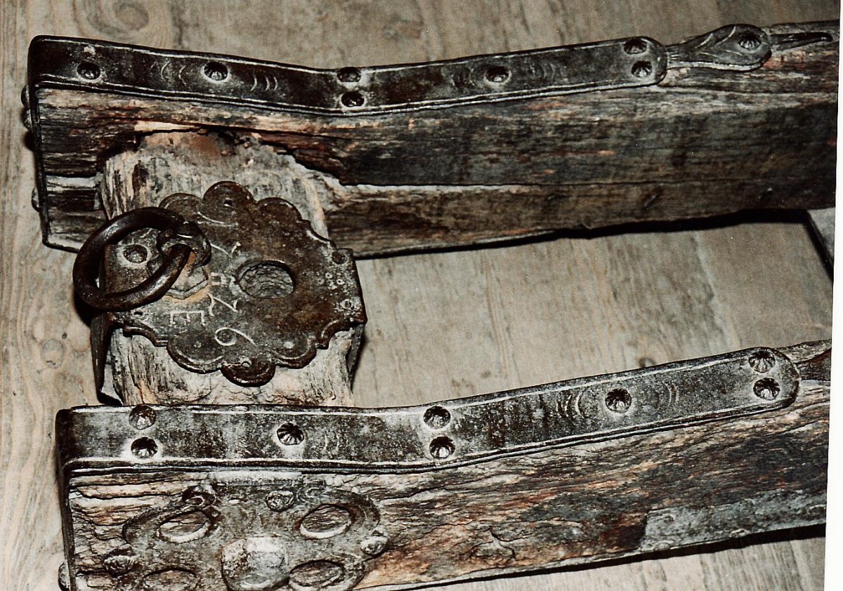

Old 7th June 2012, 03:35 PM   #25
Matchlock
Matchlock's Avatar
Join Date: Sep 2008
Posts: 4,310

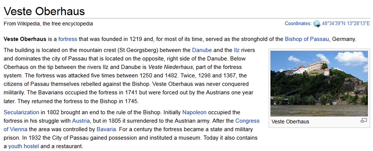

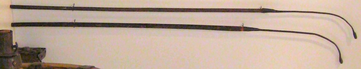

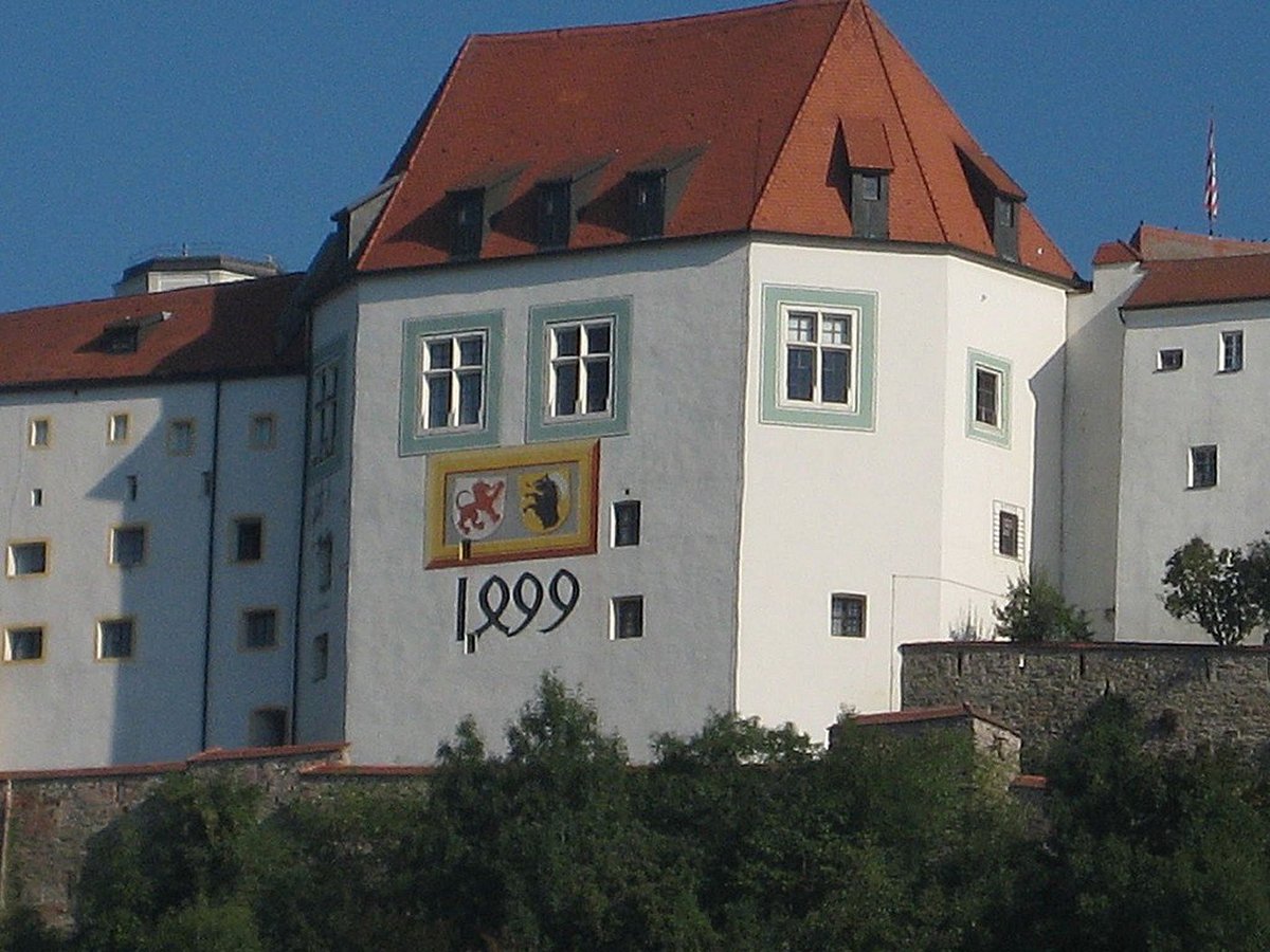

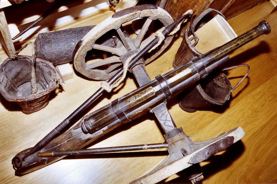

Two early 18th c. igniting irons retaining their original long hafts, as part of a large piece of cannon: the bronze barrel and carriage mounts both dated 1726 - the barrel additionally cast with the Passau wolf which has become famous as the trade mark of the medieval Passau bladesmiths - ; together with two contemporary scourers (Rohrwischer); in the museum of the Fortress (Veste) Oberhaus in Passau/Lower Bavaria.
The outer walls of the huge fortress which was never conquered are dated 1499.
m

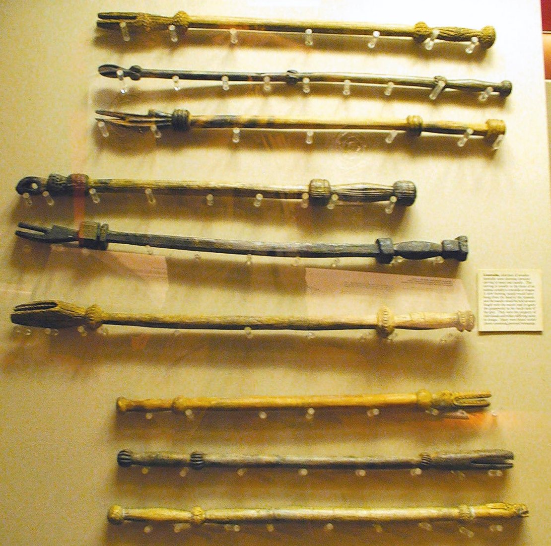

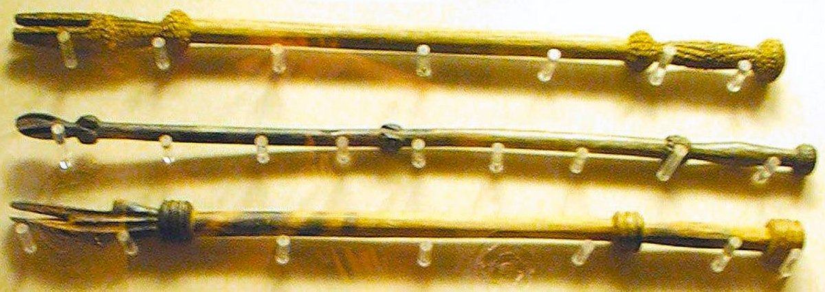

Posts: 4,310

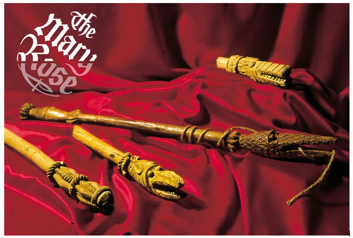

Default Fine Linstocks Salvaged From the Mary Rose
The Mary Rose was sunk during the Battle of Spithead in 1545.
As Henry VIII ordered many items for his men from Northern Italy, especially the Brescia region, the zoomorphic, monster-shaped heads of the linstocks are consistent with the style of the Renaissance period.
The Mary Rose Museum, Portsmouth.
