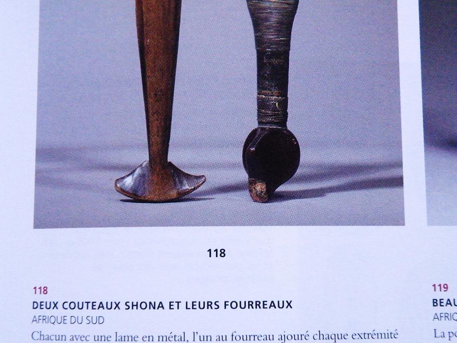

Its the broken-off tip from a Shona (Zimbabwe) dagger or sword, scabbard. The brass wire plaiting is typical.

I agree Zulu or Shona wire work. Shape of the hilt seems to be an elephant ears and trunk.
Lew

Here is an image from an old Christies sale catalogue.
