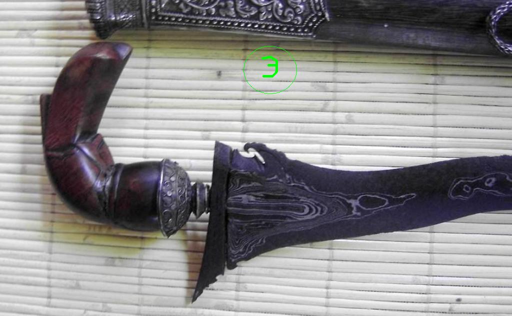

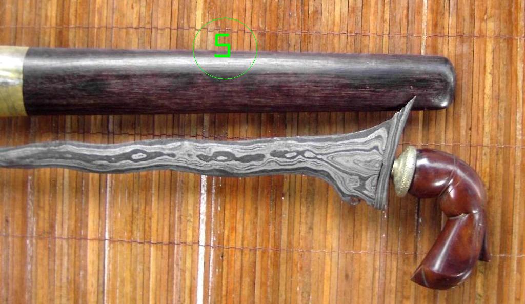

Hi forumities
Somebody from Malaysia told me that this kind of pamor called Pamor Rahim (Uterus).
hhmm.....
I heard this kind of Pamor name few months ago, Is it really exist that kind of pamor name?
Thank you
Bre.
Old 21st January 2009, 08:31 PM   #2
Posts: 7,255
Not in any pakem that I have ever seen, and I could not imagine any Javanese person with any self respect applying such a name to a pamor on the ultimate male symbol. To me, this sounds like current era pop krisolgie.

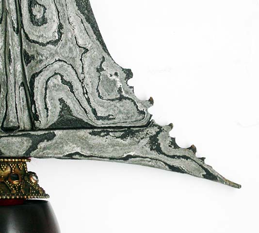

Originally Posted by brekele
Part of ganja keris called Rondo Nunut.
Rondo = Widow.
Nunut = Ride in / Boarding.
Dear Brekele,
IMHO, "rondo nunut" is not a "rondo" (widow) -- riding something. But an 'easy spelling' or 'quick spelling' of "rong dho" (two 'dho' -- two javanese 12th alphabets 'dho' or 'dha' in the greneng) nunut.
So, IMHO, "rongdho nunut" could be meant for "two more dhos above two dhos in the end of the greneng")
Below are two pics of Javanese characters or caraka scripts, vocal and consonant. And also, example of a keris greneng with 'rongdho nunut' at the end of the keris tail...
GANJAWULUNG
Old 22nd January 2009, 01:35 AM   #5
Posts: 7,255
Yes Pak Ganja, correct, however, I think that a better explanation of the "nunut" might be that "nunut" means precisely to "ride along together", not "ride in". In the case of the ron dha nunut, it is "riding along together" with the other ron dha ( which could be more than an additional single ron dha) in the greneng. I understand your logic with "rong" , but a couple of very knowledgeable and respected people gave me my explanation.
