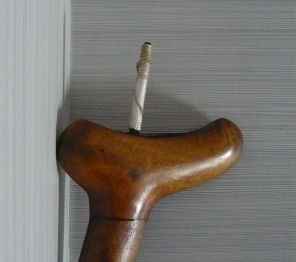

Can we please see the pesi when possible?
Old 17th December 2008, 03:09 PM   #10
BluErf
BluErf's Avatar
Location: Singapore
Posts: 1,180
Hi all,
Sorry, was busy for past few days. Ok, I've got the pic here. Pardon me - I didn't unwrap the nylon thread around the peksi because I thought it was rather well-done and packed-in to try to unravel. Anyhow, you can see the base and the tip, and get an idea of how tall and thin it is. The nylon thread is quite thick.
The keris blade is 11.7in, which makes it more or less the same size as a standard Bugis keris. The peksi is more than 2in tall.
