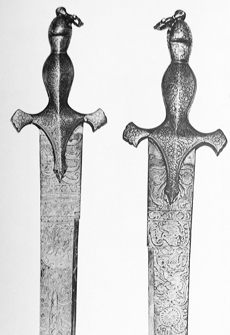

In Des Armes Orientales by P.Holstein, 1931, volume II, plate 1 and 6, another tulwar hilt without disc is shown (see the picture, showing both sides of the hilt). Holstein gives the place of origin as Katch. The strange think here is, that when looking closely is seems as if there never was a disc, but there are slits on each side of the hilt where it should have been, but the slit does not seem to go the whole way around the hilt, only on each side. If the hilt was not meant to have a disc, why make the slits?
I have never seen a tulwar hilt without a disc, other that on these pictures, but I have heard about two more. They were taken, after a one of the last English cavalry attacks, close to the Khyber Pass in the 1930’ies.

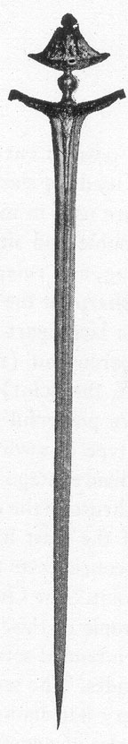

Let us move to another kind of sword, the one on the picture. It is from the Malabar Coast (Stone, page 594, #4). This hilt is even narrower than the tulwar hilt, but if you watch old paintings and sculptures, you will notice that it is held with three fingers, plus the thumb, around the grip, and the rest of the hand around the pommel. Why it is like that I don’t know.

Wow, real bizarro; switching to a 1/2 push-dagger type grip, as seen in a variety of styles re smallsword? Some African swords have these like 2 inch handles where I can only imagine the usually but not always small pommel resting within the hand, even in like the hollow of the center of the palm; I mean, normal or small size humans like the W/C African aborigines (pygmies)aren't THAT small; about nipple high on me, usually, and then the much more nunerous Bantu race is a genetically large and also a beef eating people, not unlike (and in many other ways not unlike) Europeans.......a notably k(e)ris panjang-like blade there, I think, BTW.

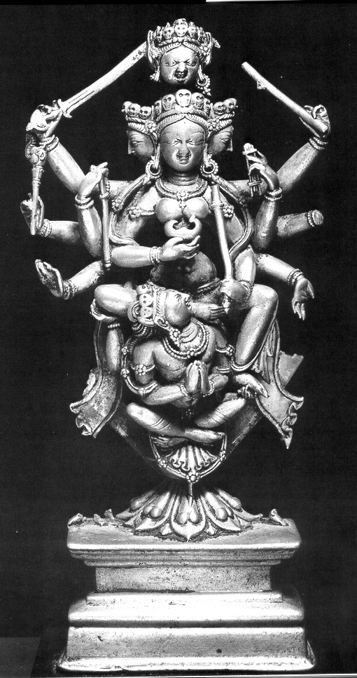

On the picture you can see how I think they held the swords with the small hilts. Part of the palm of the hand rested against the flat pommel. If this is so, when stabbing, it would almost be like stabbing with a katar - very powerfull. This kind of grip is of course impossible with a tulwar hilt.
The picture is a Kashmeri bronze. If I remember correctly it is ealier than 15th century.

When looking at the statuary of Hindu gods, and perhaps some Buddhist works as well, it is common to see the forefinger and little finger raised, even when holding certain objects (as in this picture). I believe this representation has some religious significance. Similar hand postures are seen among traditional dancers in India, Thailand and elsewhere in SE Asia, where the third and fourth fingers are flexed towards the thumb, forming a C-shape, and the forefinger and little finger are extended. I don't know the name for this posture, but it seems to have been around for a long time and must have a particular significance.

Ian, you are right of course, but this does not change the size of the grip/hilt. I still think the flat pommel rested against the palm of the hand - just like Tom described it.
If the grip on the hilt was like this, the ' freedom' to move the sword in any direction would be the best possible, and I don't think the strokes would be less fatal.
