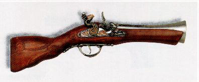

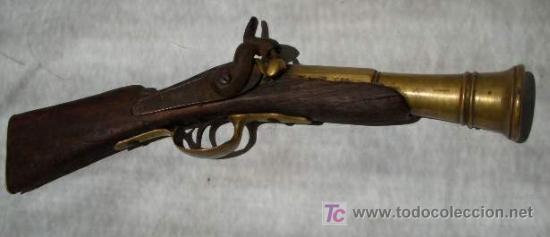

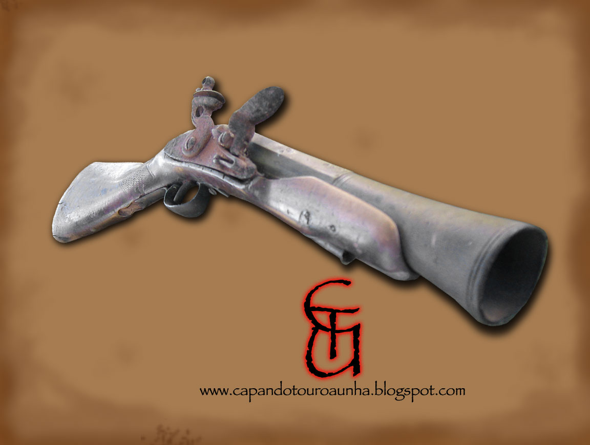

Similar blunderbusses found on the net

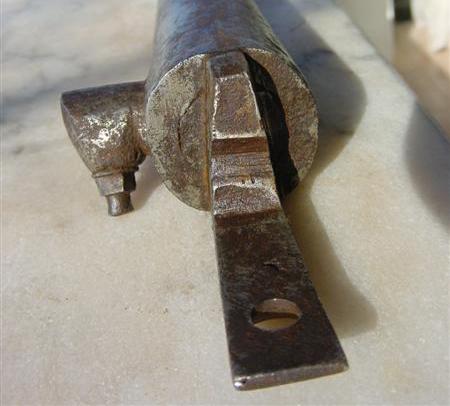

Hi Fernando,
Seems I survived "The Battle Of The Hook" at Gloucester, now I feel like I'm coated in burnt BP...
Just replaced the broken camera, I hope these new macros of the disassembled lock and barrel end better focused than the previous.
I sold my India Pattern Bessie a couple weeks ago. The similarities go well beyond the shape of the stock. The Lock is virtually identical (both sides). The trigger mount is different though, but similar in its design.
Check the follwing images.
Best
M

Old 25th October 2008, 09:10 PM   #27
Ai Ai Ai Manolo, that breech plug
A screw instead of a plug?
Do you trust it ?
Here are some plugs.
Fernando

Frankly, no. And the end shape of the flint holding screw is flat, instead of pointed. And the finish underneath the barrel's tang and the barrel don't seem well done. Add to that the total lack of markings and we get a confusing picture. Why?
This gun has seen action, there are multiple flint cuts in the side of the barrel, as well as burnt marks around the priming channel/ear and the cazoleta/flash pan has that unmistaken sign of having been flash-burnt repeatedly. Obviously, it was made to be used, not to be sold to unwary tourists. It's functional.
Kahnjar's theory looks more plausible now...
What do you make of it all? Fake, copy, field repair? Besides the barrel, most of the gun feels legit.
Do you trust it ?
