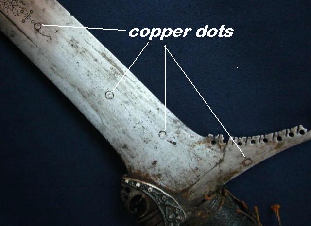

I noticed that this Kris has copper dots inset on the top part of the blade, the dots are on both sides of the sword.
Do you Forumites think that these were just place randomly or do they have any talismanic values. Any ideas

A lot of good theories. Thanks.
Atlantia, No not Buddhist, the Moro's are Muslims. There are only four copper dots on each side of the blade.
Battara- Upon closer inspection the clamp seems to be made of copper that was covered in silver. I have seen suassa over silver, this is my first encounter with silver over copper.
Kai- No hairline crack inline with the dots. Although there is evidence of a repair to the tang.
VVV- I can't invalidate your theory, anything is possible.
Does the dots have anything to do with the tang repair? Cato said that the Jin is released if the blade is separated from the ganya. I wonder if the dots were placed on the blade prior to doing the repair, to prevent the Jin from escaping.
Which came first the tang repair or the copper dots???

Very cool sword. How many dots total, can you point them all out? I'll throw in my 2 cents of speculation.
The fellow that owned this was very superstitious, so some of the meaning may specific, as to him as an individual. Perhaps he was of some religious status.
Seeing as the first dot is on the gangya & is as close as you can get to holding the sword, he may have felt he was sending his inner power down into the blade. The first 4 dots certainly look as a continuation of his arm right to the center of the blade.

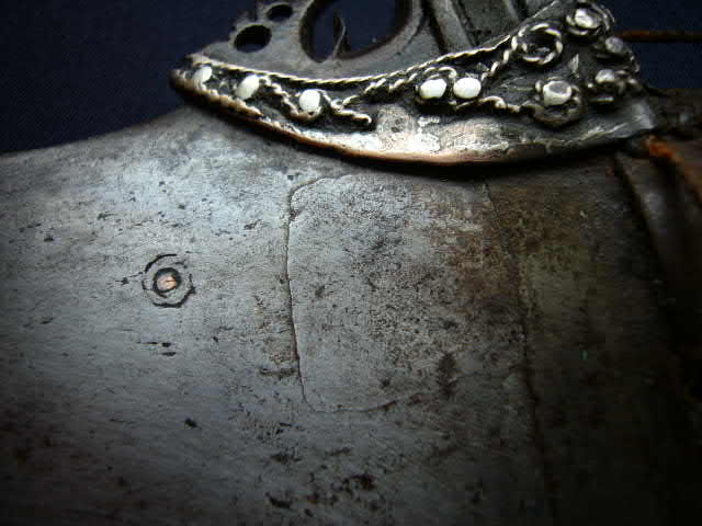

That "repair" is interesting too. I have a blade that was clearly damaged & the tang was replaced. But I have also seen a high % of talismanic blades with what appears to be tang replacements.
Could this blade be made this way deliberately? Some of the work looks like it was sawed/filed in a straight line/box; while some (like yours) are rather uneven (made in the forging process?). The tang being made of some metal of spiritual value (old sword, etc) & being added to the new sword; an old Jin, you might say?
Yeah, I wasn't suggesting it in this case - just mentioning possibilities in general.
With one of the dots on the gangya, I don't see how this might have been supposed to work. A master bladesmith should be able to (re-)apply a Jin when finishing the repair work; I'd guess that there were rituals to house the Jin elsewhere while working on a blade, too.
We'll probably never know. However, I'd guess the dots were part of the original talismanic design.

It would be great to collect more data on these constructions. I'd ask anybody removing the hilt of a kris to take close-ups and measurements of the tang and also pay special attention to modifications done to the gangya. Thanks in advance!
