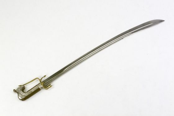

Here are two nimchas, from a Bulgarian private collection (unfortunately not mine), who have always struck me as very suitable for a pirate weapon. One of them is actually similar to the Hopsonn sword. I believe they were collected in Bulgaria - there must have been serious movement of people and weapons in the Ottoman Empire back in the day.

Wow! Nice nimcha! That top one is particularly amazing with its thickened point! I'd love to get my hands on that one. Rick (RSword) has a truly amazing nimcha that I had the opportunity of holding, with gold leaf inlay. Its amazing how many of these swords are very simple/utilitarian, while others are made of the finest materials. Thanks for sharing.

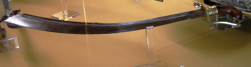

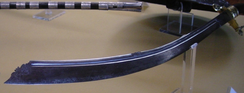

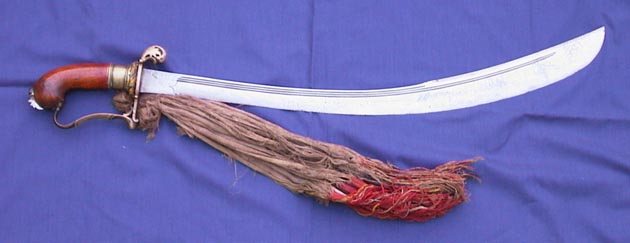

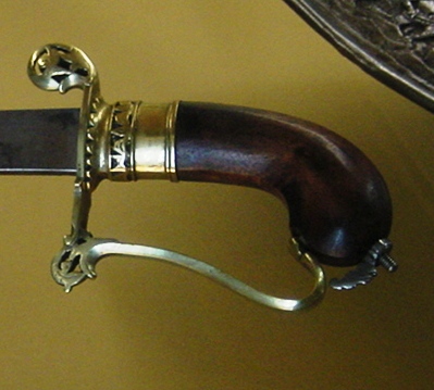

Clandestine pictures taken at the Lisbon Military Museum.
The text in the tag mentions that this nimcha (?) was the sword prefered by Moroccan pirates of the XIX century. These are not the right words, but such was the sense.
Fernando

Well, it would not be the first time museums give bizarre info on things . For a start, they call it a nimcha, which (even) i know is not correct.
The tag text for a nimcha is probably right, and so must be the preponderance of the parang for the Malay pirates, so only the conjugation of both being wrong

With a patient observation of the tag text in three of the pictures, that i had cut off to concentrate on the sword images editing, i think i managed to read it. Here is a crude translation:
ARABIAN SABRE OF THE "Nimcha" TYPE.
Origin: Northwest of Africa, possibly Morocco.
Period: XVIII-XIX century.
Total length: 74 cms.
Blade of one only edge, widening at the point, with very deep gutters.
Handle of wood, with a pistol grip shape, with spur hand guard in brass.
It was the type of weapon prefered by the pirates that used to rapine the ships along the African coast.
I understand your question about the fittings being gold or golden, though.
That brass happens to have a rather high polished finishing.
Fernando
