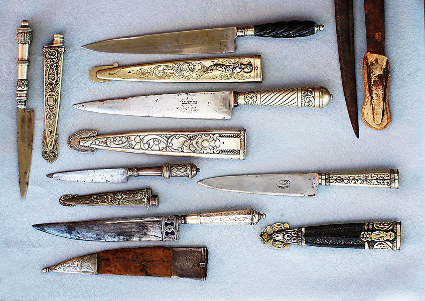

Old 14th July 2008, 01:44 AM   #10
Posts: 7,255
Not all strictly "gauchos", as we think of them, but all of a type.
A few of mine.

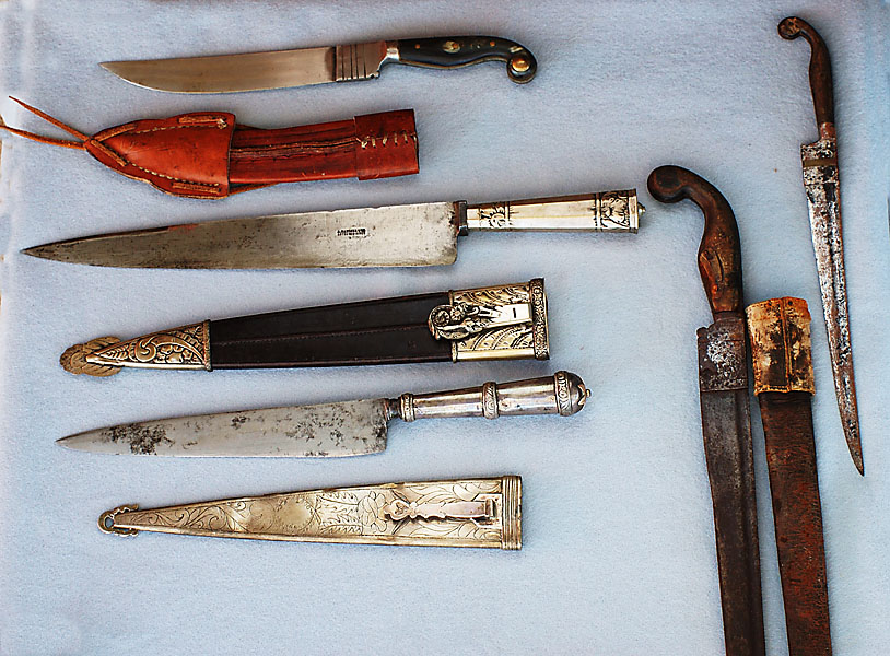

Old 14th July 2008, 08:52 AM   #13
here's my modest set: all 'new'
top is a modern 'gaucho' fighting knife from mission in argentina i picked up a few years ago. 10 in. carbon steel blade & guard, full tang. scales are wood, riveted on. i wrapped and varnished the grip to fit my hand a bit better. the notch is usefull if you choke up on the grip.
middle is a smaller criollo from tandil, from last year or so. wood grip, alpaca fittings (german silver), 5.25 in. carbon Steel blade. nice 'S' at the blade/grip junction on the blade.
i like the leather sheaths with their central seam, belt flap and shirt protector fan at the top.
bottom is a more decorative one with an etched 7 in. 'inox' (stainless) blade, marked with a trumpet as a makers mark. un-hallmarked silver (plated?) grip & scabbard, turning a nice black patina i'd expect from a silver alloy.
Old 14th July 2008, 12:16 PM   #14
Posts: 7,255
Yeah Chris, no problemo.
From the top---modern in leather sheath
1---no name, Brazil, about 20 years ago, by supposedly last traditional smith in the country
2---A. Panizzi y C??., Artes 122 B-Aires
3--- no blade stamp
4--- (second pic, black hilt) Verminck & Desteves, Montevideo
5--- A. Panizza y Cia, Artes 122 B-Aires
6--- S Holberg, Joucla Y Silva ????
7--- JJ CA, Tandil, Argentina
8--(vertical, LHS) J,Jnvernizzi, Buenos Aires
9--- (two vertical RHS)--Brazil, no blade marks, very old.
10--- (bottom , pierced ricasso) an ancestor:- meditteranean dirk, 17th-18th century
Old 15th July 2008, 02:01 AM   #15
Chris Evans
Join Date: Mar 2005
Location: Australia
Posts: 685
Yeah Chris, no problemo.....
Thanks for that listing. Nowadays, the most highly valued antiques have old German or French blades and was hoping that you may have one. Nonetheless, you have a fine collection. Doemench, in Dagas de Plata, gives a listing of all the prominent brands and is worth buying for this alone.
Cheers
Chris
Chris Evans is offline   Reply With Quote

Old 15th July 2008, 04:16 AM   #18
Gonzalo G
Gonzalo G's Avatar
Join Date: Apr 2007
Location: Nothern Mexico
Posts: 458
Chris, a very precise description. The gaucho was a frontierman, a nomad usually living and sleeping in the open, hunting wild cattle and trading with the indians, form whom he learnt many things, as the use of the boleadoras to chase cows and cimarron horses. Like a mountainman in the USA, but in another geography, la pampa, the great plains with pastures, just like the big plains in Dakota, USA. He was also a bootlegger form Argentina to Chile, a bandit, an occasional cowboy for the landowners and a cavalry soldier in the civil wars and the wars against the colonial powers. However, I want to make some precisions. The real gaucho endured maybe to the middle of the 19th Century, as a nomad and occasional cowbow, bandit and bootlegger. Blades made industrially were imported from Europe, but there was also a local blacksmithing production which made several blades for the market, mainly from used files. Facones were not always made from broken swords or sabers (there are also antique curved facones made in this way), and discarded bayonets, but also with blades made by local blacksmiths, sometimes with fullers, sometimes without them. The gaucho was ultimately finished by the private appropriation of the land, the wire fences surrounding the land and their prosecuting by the government authorities. The gaucho usually carried more than one knife. He carried usually a small criollo or verijero and a facon, or a puñal criollo and a facon. I read the article about the facon here, The part of the buttons must be reworked. Argentineans also uses rounded buttons, but are different from the uruguayans. The description of the buttons can be made with precision to identify their origin without doubts, and there is another type of button, not mentioned, the riograndense button, from the region of Rio Grande (Great River). Faca in portuguese just means "knife", and facon means big knife. As reference, the books are:
Abel Domenech
Dagas de Plata
privately edited by the author
Buenos Aires, Argentina, 2005
Mario López Osornio
Esgrima Criolla
Ediciones Nuevo Siglo (Biblioteca de la Cultura Argentina No. 9),
Buenos Aires, Argentina, 1995
The last, is in fact a smal manual about knife, rebenque (the leather tool used to incentivate the horse, I don´t remember the name in english in this moment), poncho and chuza (a spear) combat techniques. A very small manual in fact, and difficult to get. But Abel has his own page and you can purchase his books from there:
http://www.domenech.com.ar/
He´s also one of the moderators of the Forum Armas Blancas.
My regards
Gonzalo
Old 15th July 2008, 05:07 AM   #19
Gonzalo G
Gonzalo G's Avatar
Join Date: Apr 2007
Posts: 458
A. G. Maisey you have some brazilians facas over there, and mostly puñales criollos. The puñal usually have a drop point with a false edge, and a button where the blade ends, at the beginning of the hilt. No guards. There is silverwork from the Olavarriense school, and the Rioplantense School. The facas look like made from bayonets, but I´m not sure. The last puñal criollo on the photo, below, has a piece of silver or alpaca covering the ricasso of the blade. This piece is called "empatilladura", and it has similar functions as in the yataghans: it is an ornament, but also a pice which gives more rigidity to the blade and absorbs part of the vibrations when you chop with the kife or parry another knife. It also serves to avoid rubbing the blade against the metal entrance of the sheat and secures the knife in there.
The blade from Adolfo Panizza & Cia is from the end of the 19th C to the beginning of the 20th C. Panizza was an importer.
The sixth is Scholberg, Joucla & Silva, a variant of the Broqua & Scholberg, a Liege, Belgium, blademaker. Probably the knife is from the fist quart of the 20th C
The seventh is a Juca, Tandil, an argentinean blademaker from the mid of the 20th C, still working today.
The others I can´t remember right now, I must search in Abel´s books.
My regards
Gonzalo

Old 15th July 2008, 06:30 AM   #21
Posts: 7,255
Thanks for your comments, Gonzalo.
The two RHS vertical knives could be from bayonets, but if they are, they have been extensively reworked, as both have a strong distal taper and some spring in the blade.
The bottom knife that looks as if it has silver over the ricasso is in fact a early European knife, not a South American knife. What looks like ornamental silver is in fact an ornamented steel ricasso, an integral part of the blade
