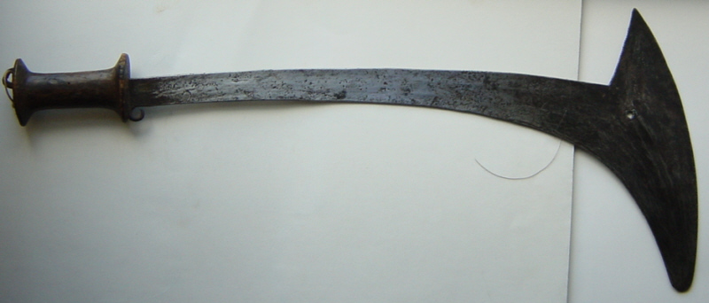

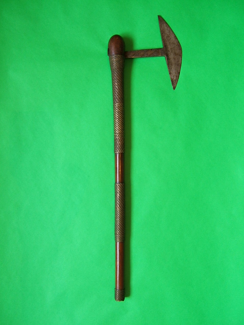

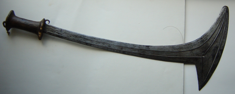

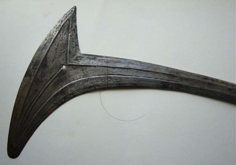

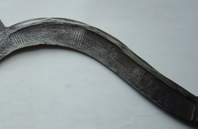

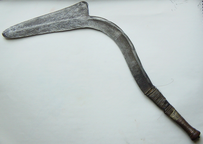

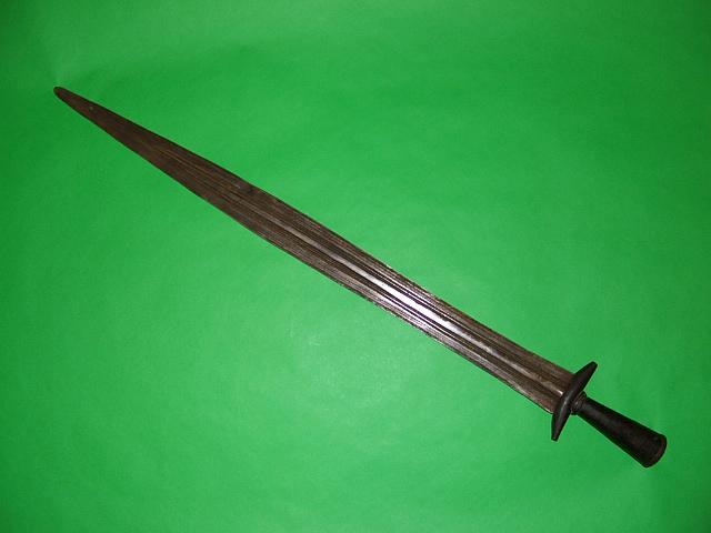

We have been here before. You need to look harder and examine more quality pieces. Superb quality can be found. As to layering, I am certain metals of various carbon content were mixed when available or needed but any visual signs of layering that I have found just seem to be incidental to forging the work. I have big macho spears all the way down to small blades like the old safety razor blades. When I have time I will post pics. Looking at some work, before the introduction of trade steel. There is the most ingenious use of form and fullering to achieve strength with minimum use of steel, if not rare, then certainly expensive and hard won. A different kind of bigness.

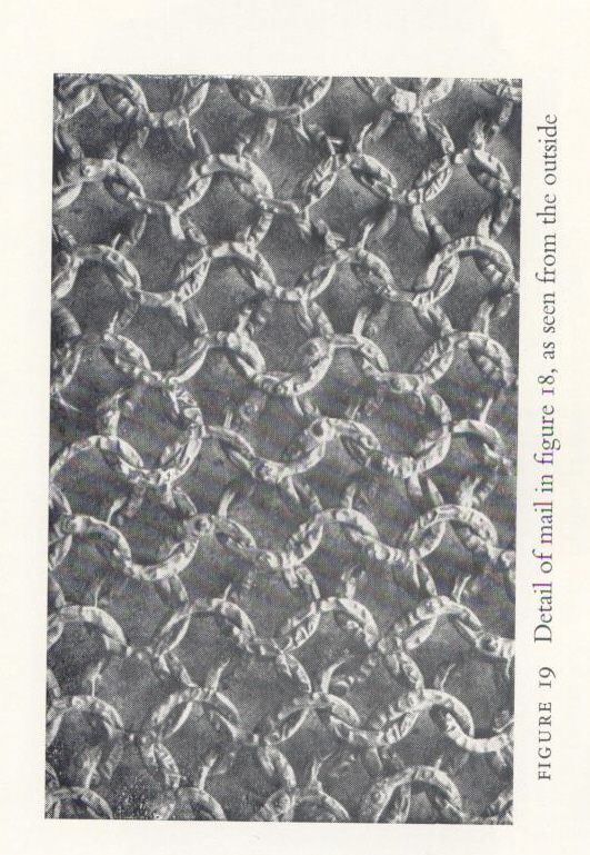

Posts: 6,000
Default Mail shirt

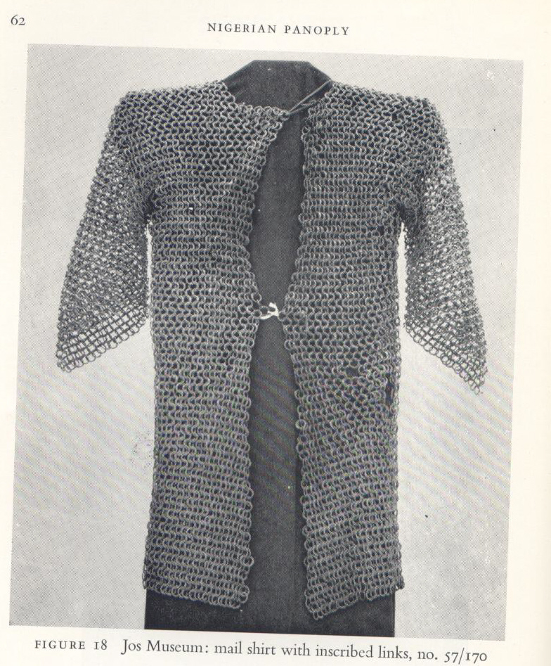

ausjulius, you might find this stuff interesting. This book was printed 1963 then the outlook on what Africa could produce was a little different from today. Every other possible source of origin is suggested but also questioned. There is no open mention of an African origin, however I read that this is an open invitation for contemporary collectors and students to take further. It is interesting that the weapons of Persian form and etched with script are made in Africa. Some infidel weapon forms from the forests of central Africa have indeed be Islamized by such decoration. Read these extracts from "Nigerian Panoply arms and armour of the Northern Region" We are looking at Islamic city states not mud hut villages.

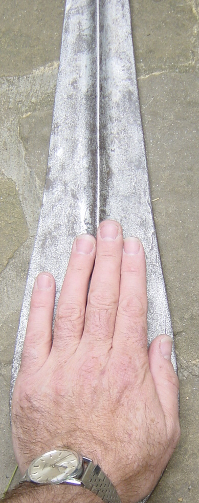

Posts: 6,000
Default Thousand km south and east

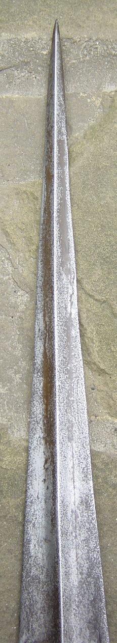

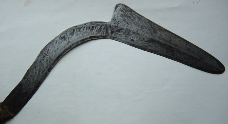

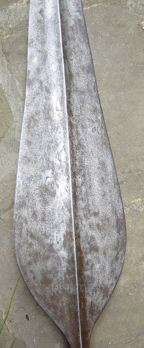

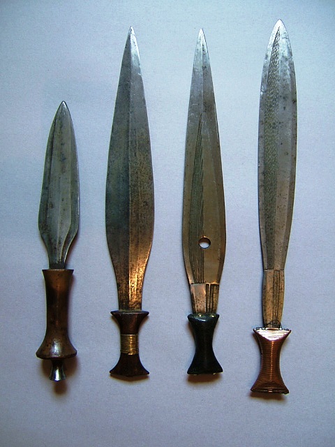

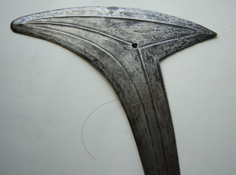

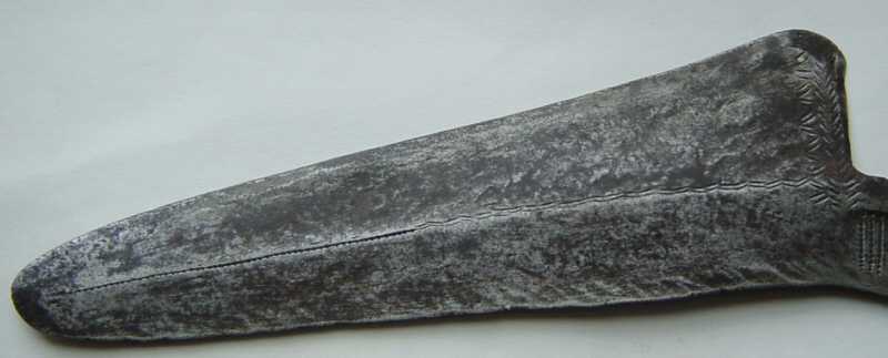

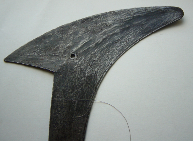

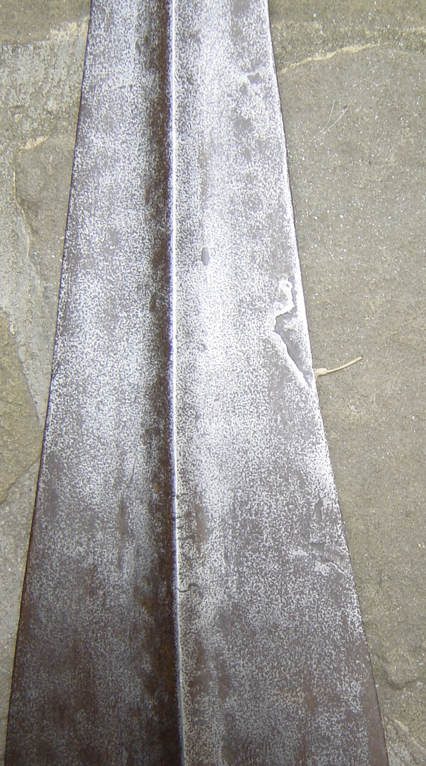

If you down load these pics and examine magnified. You will see a form of layering. Believe me this is tempered. I am sure that if I were to etch the surface, patterns would appear but only incidental. The spine of the spear is over 1cm thick. I think one has to develop more of an eye with African pieces
thanks yes, and in southern sudan mail like this was very common, but these people wer einfluence and dominated by small numbers of middle eastern traders,, introducing new things and ultimatly dominating the society in these areas.
i was after indiginous invention.

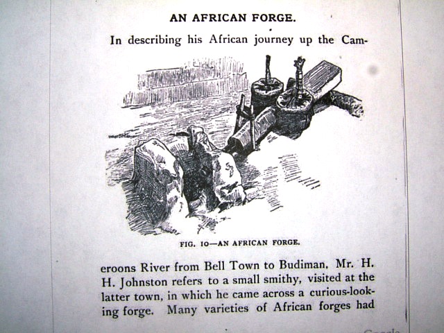

does anyone have any pictures of the equiptment of a 19th centuary blacksmith of this area?

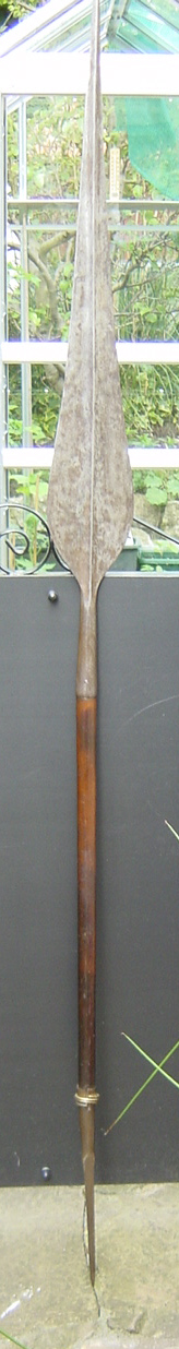

I would have bought this book but have my eyes on other things. I have snatched this picture though.
http://cgi.ebay.co.uk/ws/eBayISAPI.d...MEWA:IT&ih=025

just good technique,
african blades are hard to make, compared to a simple stirght blade.
and would take alot of work to produce,
the poor heat treatment and hardening is comon just the same in simple tools and knvies as in complexed tools and knives , it is not the shape,
although no doubt it would be worse in more complexed wepaons,
id say you can find many many african blades from the 19th centuary and quite alot from the 18th centuary and the styles are similar as is the quality.
i thin ingeneral most swords were not used for combat,,
but they ust have used some as there is accounts of them doing so ,
a sword made around 1900 for military use is a cheaply made functional item..
... its use is instantly apparent .. and it is designed for a function,
the afircan swords ive seen ive never been able to see any use for any of them,
the masi knives yes, they are a multi tool basucaly in the style of their spears.
the swords of ethopia yes and many appear to be use and had a specific technique to use them,
but the congo area of affica,, the "african" africa,
swords just, seemed to be...... mostly decorative,, or....... made more for a shape that for a use,
even the small galdius type swords they have no guard and no pommel cap and the handle is just a hunk of green wood pushed into the hand and peen over, mostly the handles are broken or split,
if these were being used so often then i would exspect them to use metal in the guard and pommel, and even atlease finish the wood well and maybe use a better wood,
it is interesting no doubt the swords held some cultural importance for rank and power, but how important if at all were they in combat,
the mosy afirican spears and clubs although routhly made are rather fucntional items that are made for a task that is apparent when you see them
the same goes for bows,
but when it comes to swords,,
"klingonish" comes to mind :P
however ,, i realy wounder how old these odd styles are, and was there some stlyes before that that were more simple and more functional??
also , im interested,.....
has ther ebeen any study as to when the sword came into africa and what styles came and what part did the arrive first.
as it realy is clear the concept of a "sword" is something people learn from one groups to the next. hence the different types in earily history spreading around..
Tim, thanks looks like an interesting book ,
however the individuial in the picture is mostlikeliy a moslem frim the north of this region near camaroon and nigeria ,e ct ect,, and not form the southern non arab influenced areas,, hence the horse and the armor. still even this is interesting, as i wounder why it never spread further south,
realy somebody must have a closer look at all this are africa seems to be rather under researched,
and it is interesting to have some information on these things,

I think most of the African longer swords from the Congo were more status symbols than actual weapons. Some of their shapes are not really that practical in combat. Spears,clubs and bow and arrow were probably their best weapons and the dagger for real up close encounters. There are a few exceptions though such as in this sword. Heavy blade with a very well made point. Many tribes often used axes in war such as the two pictured below. The point here is that these weapons were developed based on the type of warfare that was common at that time and since the other tribes were not developing any new forging or heat treatment techniques that were producing substantionally superior weapons than there was no need for an arms race to make better weapons as was apparent in the Asia,Europe and the Mideast. Btw the viking sword was a complex wonderful piece of steel but was very expensive to produce and was quite costly to the owner to afford. The viking weapon of choice was the spear and the lowly axe which had a simple Iron head axes were easy and cheap to make. Battle field weapons evolve due to adjustments to the enemies tactics and weapons. In Japan the use of the straight double edged sword was abandoned sometime after 1276 after they realized that it was not very effective against the invading Mongols and created the tachi/katana or curved sword which was more effective. The style of the Japanese sword has changed very little from 1300-1800s because it did the job it was designed to do and it did it well. The same goes for African weapons the smiths just did not need to improve their techniques what they had did the job. Necessity is the mother of invention
Lew
Old 23rd June 2008, 06:19 PM   #20
Posts: 6,000

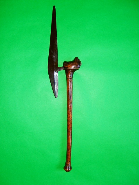

This is a nice weapon. The beak is 26cm long, not a toy and anybody could pick it up and fight with it. So you see some super things yes?. Lew and I have done so well without Danny, Freddy, Luc and others sure there is more to follow huh

I'll start with the mail shirt posted earlier on this thread. It's ceremonial.
A common mistake made by many when viewing mail of this type is to assume that it's functional. Mail of this caliber was never meant to see combat. This mail shirt is a talismanic ceremonial expression. A tell tale sign of this are the Arabic inscriptions placed on every single link. It is a tribute and a sacrifice of one's time and effort to show their religious devotion and was worn on ceremonial and festive occasions. Real functional combat mail worn by the Sudanese was much more closely linked.

ive noticed that most african knives had large flaws in the blade,
and as i dont know what type of smithing techniques they sued i woudl hazard a guess in that they used a stone anvil and proably very simple tools..
still to put so meany fullers into the itmes would take quite some work without good tools..
but realy the hardening if found is mostly very soft, or none atall,
all antique african weaponrt ive found is no softer than a normal machete or other spring hardened item, 45 rockwell or less..

And as far as mail armor not being indigenous to southern Sudan, this is ridiculous. What is indigenous? Mail armor is believed to have been invented in East Asia or Eastern Europe, yet no one accuses mail armor of the Middle East as not being indigenously Middle Eastern.
Also, the Romans would have no mail armor if were not for their encounters with the Gauls who they considered to be of another race in the modern sense of the word. Are we to say that mail armor is not Roman?

hmm first to the anvil.. i disagree.
look for exsample at the size and complexed awkward shapes these african weapons come in,, they were using a crude anvil to make these, these shapes are much much harder to form that a european or japanese blade shape which is very simple by comparison, apsecialy the japanese blade.
a good exsample of good tempering is blades made fomr semi nomadic groups in borneo..
thes epeople use very crud tools but the treatment and finish of their wepaons is very impressive for teh tools they used,, when you look at old weapons of their from 18th and 19th centuary which were collected they are very well hardened and made.. but they had much less resources and no more complex tools that in africa,

I disagree with your anvil theory. I have been known to forge on a good smooth hard stone anvil. And stone anvils have been used throughout history all over the world.
