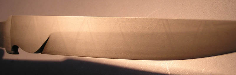

I located the blade for ’04 with the angle grinder zig-zags, as you can see there is a similarity to the way the ladders look even though the underlying character of the wootz is quite different, it is something I don’t recall seeing in an antique blade.

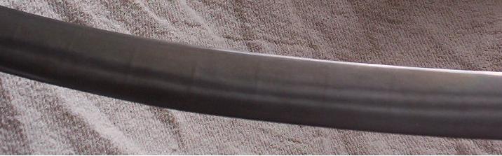

Here's an authentic blade with Shah Abbas/AssadAllah cartouches. The blade has Kirk Narduban/Ladder pattern and when viewed under an angle - the ladders appear "raised" (Sorry, the quality of the picture does not represent it that well). I have not seen many swords with similar effect, and this is to demonstrate that this is not an illusion per se, but a real and natural effect on some Kirk patterned blades !
Old 16th June 2008, 07:41 AM   #39
Jeff Pringle
Jeff Pringle's Avatar
Join Date: Nov 2005
Posts: 189
Marvelous, Alex – that’s what we need, those are certainly tighter ladders than you run across in run-of-the-mill, everyday wootz. Now if you had a higher-resolution version of the photo, we could really start comparing. Without that, I can give an opinion that the AA blade’s ladders seem less sharply defined when taken in total, and perhaps more importantly - notice they have a light/dark (or dark/light, depending on which direction you read your wootz), two stage influence on the light reflecting from the blade surface, the zig-zag blades have a three stage dark/light/dark reflection on many rungs, depending on the angle of incident light.
Imagine a semi-circular trough cut into the wootz, and a more squared-off trench, the first leans more towards a left side, right side reflection, the latter towards left side, bottom, right side.
But hopefully we can scare up more examples, to bounce opinions off of.
