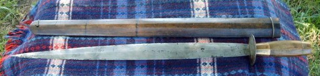

This is a sword that I've had for awhile and need help in identifying. The steel blade is of diamond shape and is 21-7/8" in length. The tang is set into the grip with what I believe to be pitch or some other type of resin. At the hilt the blade is just over 1/4 " thick. Hilt is made of wood and is 5-5/8" in length, 1" thick and 1-1/2" wide. Unfortunately there is some damage to the carved end. Total length of sword is 27-1/2". Scabbard is a dark wood with four large diamonds (1") and four small diamonds (1/4") carved into it. There is also a star about 1" across carved into it. There is some kind or writing carved into the hilt that can be seen in one of the pictures. I will do a rubbing of it later and post it in hope of getting a translation. Any help in identifying this sword and the writing would be greatly appreciated. Thanks.

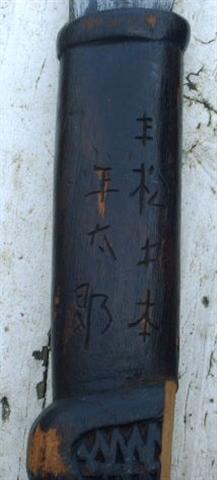

Here are the characters that are carved into the grip. I am hoping that someone can translate these and that they might help in identifying where this sword came from.

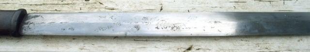

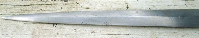

Would it be possible to get a couple of close up shots of the blade? The writing looks Asian but the handle and scabbard are atypical of anything I am familiar with. The blade could be a nice old blade so close up shots might reveal the qualities of the steel.

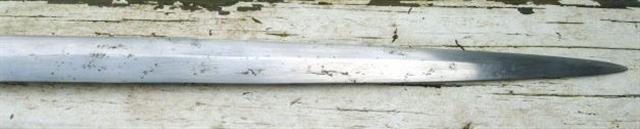

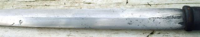

These are the best that I could do with the camera that I have. Hope they help.

Robert, try rotating the writing 180*. I can't translate, but some of the characters are upside-down.

The blade very well may be an old Chinese Jian blade. The diamond shape cross section plus the bottom picture hints at an inserted edge and there seems to be some hints of lamination in the blade especially near the hilt. The point, however, is much more tapered than is typical and may be the result a slightly longer blade being reshaped or shortened due to tip damage. The handle and scabbard are unique but seem to show some age and may point to a small ethnic group. I like the blade. It has a certain stoutness to it!

Thank you for the information. What would be the best way to tell if it has an inserted edge ? Would etching the blade with lime juice help or would that be a bad idea? Thanks again.

Hi Robert,
If you look at your bottom picture and then look at the bottom edge you can see that the very edge is showing up slightly lighter in color than the body of steel. You can also see, if you look real close, a faint "line" or "hamon" which is visible to my eye in that sunlight you took the photo. I do not recommend lime juice for this blade. If you wanted to give it an etch to see what may pop out I would recommend using a hot vinegar etch, taking your time and watching closely along the edges for a "hamon" and also looking at the body of the blade near the ridge line for any subtle lamination. Look at the blade closely in sunlight in those areas and you should be able to see what I am seeing in your pictures. If you do decide to do an etch please share the results!

I did as you suggested and looked at the blade in the sunlight this morning. I can see a line about an 1/8" in from the edge of the blade down both sides. Funny how I never noticed this before. I don't think that I will etch the blade until I find a little more information on it. Do you know of anyone I might contact to have the writing translated? Thanks again for all your help.

Let me suggest that some lines of the characters are missing, and that the two right bottom characters are Ri and Ben, like in Japan, Ri missing a little on the top. The reason a suggest this is partly that I have had a dao with the characters Ri Ben Da Guo, Great Japan Empire, and Zheng, like in government, plus some thing about Manchuria, a I forgot the exact words, written on the handle in a similar fashion. Maybe this can give some lead to the meaning.
With may dao I speculated that it may have belonged to a Quisling group in Manchuria during the Japanese occupation, and maybe marked to show, who they where, if checked by japanese soldiers. This one doesn't have the exact same writing though, but still I must say the characters for Japan is rather close.
Also some times rebel groups did this on their weapons like the Tai Ping, and we have Tai as the second character to the left. The top left character can be Zheng as in right, correct, proper if one little line is missing....
Anyway, a few suggestions, interesting if somebody can figure the whole meaning.

Thank you very much for your help. I am adding a new picture that I have made of the markings with a little more detail. It is very hard to tell if some of the markings on the grip were made as part of the writing or are just damage to the wood. I hope that this new picture will help.

Well, I finally got a decent picture of the grip where the characters can be seen. I hope this helps as I would really like to find out something about this sword.

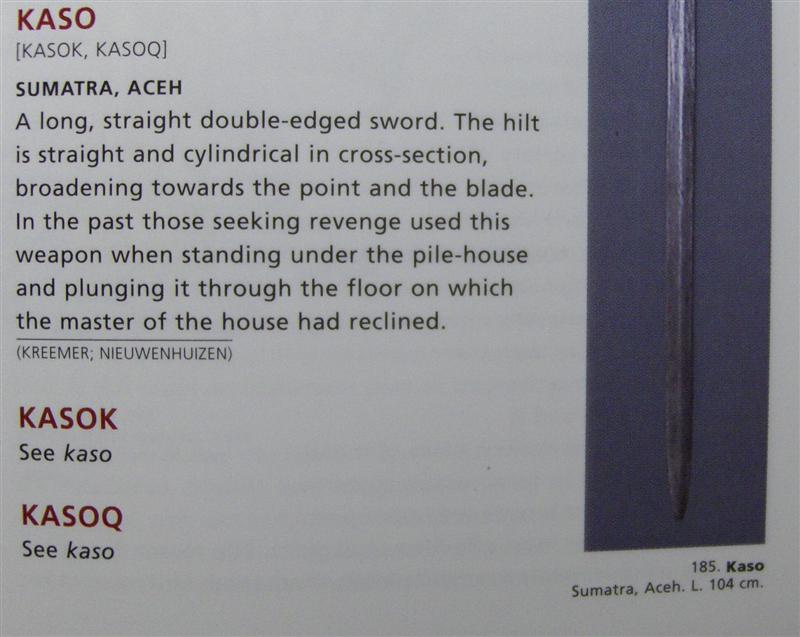

There is a similar weapon pictured in "Traditional Weapons of theIndonesian Archilepgo" on page 61, fig 185, called a Kaso,
Description as follows:
"Kaso
(Kasok, Kasoq)
Sumatra, Aceh
A long straight double edged sword. The hilt is straight and cylinderical in cross-section, broadening towards th point and the blade. In the past those seeking revenge used this weapon when standing under the pile-house and plunging it through the floor on which the master of the house was reclined."
A Van Zonneveld (quote)

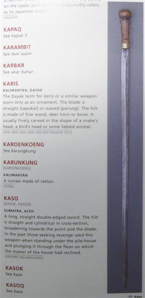

Default Kaso Pics
Kaso Pics
rand is offline   Reply With Quote

Thank you for the pictures. I see what you mean. The blades and grips are quite similar in style and shape with the main difference being in the ricasso area of the blade and the fact that the one in Albert's book has a ferrell to reinforce the grip and mine does not. It is too bad that there are no measurements and no scabbard shown with the one pictured in the book as it would also help in this swords identification. Again my thanks. Now if I could just get the writing translated.

Under the photo it says the length of the kaso, 104cm

Hum, not quite sure how I missed that. Mine is only about 70cm in length making it much shorter than the one pictured. Still the two do seem very similar.

Hi Robert,
I may have found you some answers. I have attached your image of the writing for reference.
My daughter is fluent in Japanese and took at look at the writing. Here is what she wrote back:
"This is very old, fancy writing. The second character (far right column down) means I, or myself, the third character (below that one) could mean rice paddy, a common component of many Japanese names ("da"). HOWEVER, the character below rice paddy is part of the word "nihon" which means Japan, and that makes me think the rice paddy character is really the "ni" part of nihon, and just written in a really old fashioned way that's missing a stroke. The first column is probably the guy's name..the first two characters are "correct" and "fat," but there's probably an alternative meaning for the fat one. correct is pronounced tadashi and fat is futo. i can't read the last character. So the guy's last name was Tadashi and his first name was like fat something, maybe like "bountiful harvest."

I cannot thank you and your daughter enough for your help in this. Did she see the picture of the hilt itself or just my poor rendition of the characters? If she has not seen the picture of the hilt could you possibly show it to her as I could have missed something when I made an attempt to reproduce it in a larger clearer form or posting. Thank you again for you and your daughters help.

OK, Now I'm really going out on a limb. If the writing on the hilt is Japanese does anyone know anythig about the edged weapons carried by the native people of the Aleutian Islands? Just a wild guess.

Robert,
I have sent the picture of the hilt with the writing to my daughter for comparison with your rendition of it. Heard nothing back yet. I will post info if she has anything more to add.
My guess is that you have a farming tool once owned by a villager named "Fat Tadashi" from Nihon (Japan). The "Ni" character has a double meaning (see my earlier post with my daughter's info): "rice paddy" and also the "Ni" sound in Nihon. So I'm guessing it is not Aleutian since I don't think rice grows well in the climate!
Again, I'm not an expert...
Good hunting.

Well, after finally taking RSWORDS advice I started Googling everything Chinese that I could think of and found this link forum.grtc.org/viewtopic.php?t=426 - 80k - The blade on mine looks amazingly like the one on this spear. I just wish it had the dimensions listed. Still waiting for information on the writing. Just checked the link and you will have to cut and paste it into your address bar to get it to work.

Robert.
This be the Chinese writing, is the name of a Japanese."松井本正太郎“。The sword isn't Chinese or Japanese.I think that day originally of the emigrant create.

Thank you very much for the information. Could you possibly translate the name for me? I was hoping that the translation might help in placing where this sword was from but now I don't think it will. I would still like to know the name carved into it though. Thank you again for your help.
