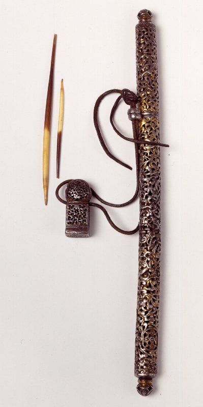

Location: College Park, MD
Posts: 186
The attached photo is kinda what I had in mind in terms of a pen case. They are often highly decorated and/or pierced, but there are simpler ones. The link below is to a similarly shaped example---which can't be seen very well but is described as containing a single-edged knife.
http://www.artfact.com/catalog/viewL...tCode=Sjp3zSo1 |
#7 |
Posts: 6,010
I think you might have the answer there dennee. The similarity of form and construction does seem too strong to think otherwise. A pleasant surprise. I hope to have it tomorrow.

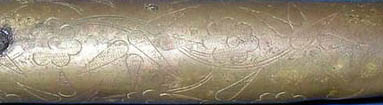

Posts: 6,010
Looking more closely with my 10x loop. I think this may indeed have some age. The decoration was that stuff known as koftgari however it is spelled. The surface of the steel scabbard and handle are completely covered in very fine scoring. Amazing how the blade is spotless, I guess it only takes a second to keep it clean?

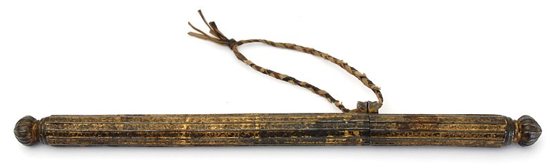

Posts: 186
I found another example of a Tibetan pen case that's a little simpler in construction than the last but has gold koftgari. Koftgari, especially in silver, was a very common decoration on iron (on belts, scabbards, etc.) in Tibet, usually heavily Chinese-influenced in motifs.
There are a number of references to substantial pen cases being used as a weapon of opportunity, as a cosh, in self-defense. It would be interesting to see that such items were also transformed into concealed weapons of a still more lethal character. The police/athlete/thug/etc. monks known as "Dob-dobs" were known to frequently carry concealed knives. |

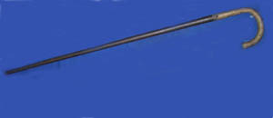

#19 |
Join Date: Apr 2006
Posts: 42
This one is similar to the above.
#20 |
Posts: 6,010
Yes along the same lines a concealed weapon. Looks a little larger, where from?
