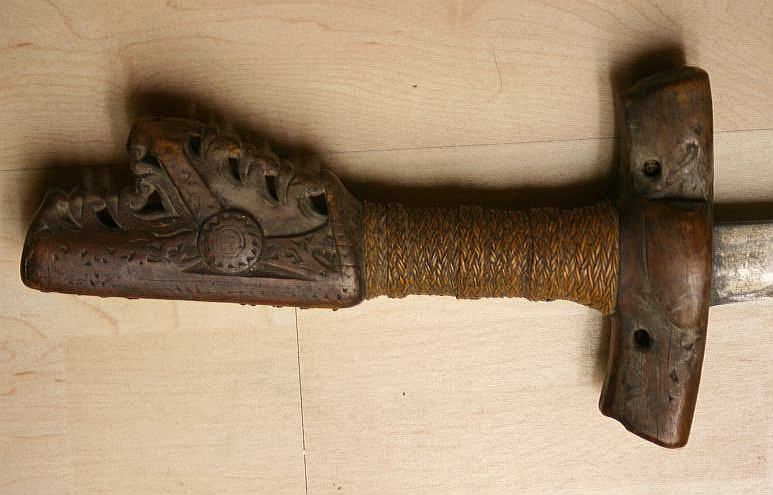

Hello. I have a newbie question about kampilans
Though I've had the pleasure of handling ginuntings, pinutes, keris, and talibons, my experience with kampilans has been nonexistent.
Which is the sharp side on a kampilan? Is it the side with the barb/hook, or the opposite side? Or are they double-edged. I thought I could tell by the orientation of the "crocodile jaws" handle, but I've seen the "jaws" facing both sides of the blades in kampilan pictures.
Also, does anyone know if it's true that small brass discs embedded in the blade are representative of how many enemies that enemy has killed?
Thanks,
Queequeg

Bill,
Thanks for the answer. I have a couple of further questions.
Are the "clip-point" or the spike sharpened, too?
Is the spike decorative, or does it give some tactical advantage?
Also, what initially confused me about which side was sharp was the direction of the handle. Most kampilan seem to have the "jaws" of the handle flared toward the sharp edge, which makes sense to me ergonomically. Yours has the jaws facing the spine, which seems (no offense) backward to me.
I guess it doesn't make any difference which way the jaws are facing?

Old 10th July 2007, 01:17 PM   #7
Hello Queequeg,
Welcome to the forum!
No, usually not. As Rick points out, the tip of the blade (wether with spike or not) is often/usually? thin enough to be used in a ripping "backward" motion.
I'd venture to guess that any tactical advantage isn't that big: A lot of Kampilans were used without a spike - some had there spikes broken off long ago and many kampilan blades never had a spike to begin with. Heck, with a blade of this size, even a passing hit with an unsharped "edge" hurts!
I've heard respected Filipinos explaining that the spike can be used to distract an opponent (i.e. asking for an opening) but none of those I remember were Moro themselves. It would be nice if someone well versed in a Moro MA style were to confirm this.
Nah, the flaring part of the hilt is at the top (like in Bill's example) - it's not a grip retention aid like in a kakatua pommel. I think I remember seeing a few genuine kampilan blades with hilts turned around but I'd strongly suspect these were trophies of foreign soldiers which got dabbled with...
OTOH, I've often seen kampilans mounted on a wall with the edge upside down. This always striked me as weird - maybe the sharp edge kept cutting any attachment string?

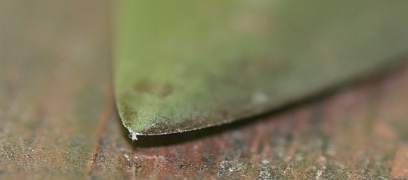

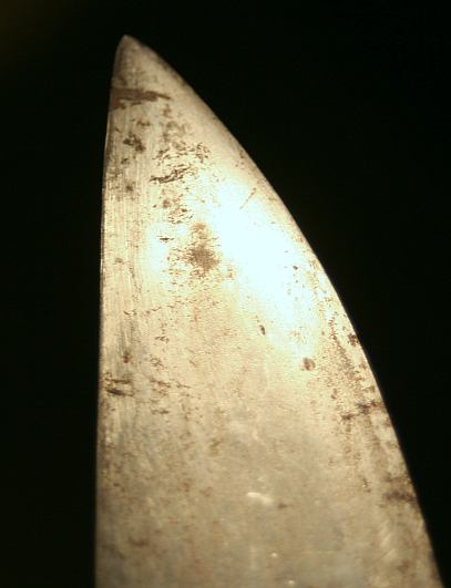

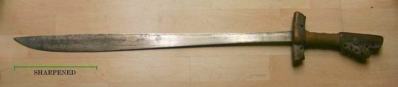

Hi all. As a matter of possible interest, I have a Kampilan that does have about a third of the "back" side sharpened. The finish and profile of the point, coupled with the facts that it is an older blade and fully an inch longer than my other spike and clip point variations, leads to the conclusion that it is in it's original form.

Old 13th July 2007, 07:00 AM   #12
That seems to be an old one - I'd have no qualms to place it into 19th c.
What's the blade length?
Could you please post a close-up of the blade tip?

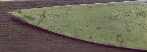

Old 13th July 2007, 09:09 AM   #13
potapych
potapych's Avatar
Join Date: Sep 2005
Location: Left Coast, USA
Posts: 14
Hi Kai,
Hope this helps, it's the best I could do being that it's night time here. The reverse taper is about equivalent to the front edge taper, (a little over 1/4 the blade width) and runs for about 8 1/2" (or 21.6 cm) back from the tip. It is as sharp as the front (very) and there is no indication it has ever been any different.The blade measures 29 5/8" (or 75.75 cm). I'll try for a daylight shot later.
It's scabbard also conforms to the blade profile but that in itself is not so compelling as they were often, (as I'm sure you know), discarded in the heat of things and later replaced.
Ray
potapych is offline   Reply With Quote
Old 13th July 2007, 09:18 PM   #14
Posts: 7,406
And you are sure that the curved back edge is not a later sharpening? This is very unusual. In every single kampilan (and traditionally) the straight part is what is sharpened.
Old 13th July 2007, 09:55 PM   #15
Hello Jose,
Maybe an acid etch of the blade may give additional clues?
The straight edge of this piece is fully sharpened if I understand correctly. This tip profile is the most likely to be also sharpened: Several members of the klewang family of blades (from which the kampilan obviously originates) do exhibit a sharpened back edge along the tip. It would be nice to hear of other examples if any were known!

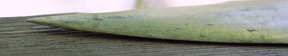

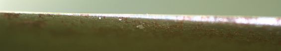

Old 14th July 2007, 06:30 AM   #16
potapych
potapych's Avatar
Join Date: Sep 2005
Posts: 14
Hi,
Please excuse me if I didn't explain well enough; the straight "front" edge is entirely sharpened, as is usual and the first third of the "back" (curved edge) is sharpened exactly equally.
Anyway, I tried to get better pictures of the profiles today, the last one depicts the taper of the "back" side, from it's full width to the point of where it is truly sharpened. (Please excuse the greenish hue, it's a from Japanese Maple that's always trying to get into the picture ;-)
Ray

Old 14th July 2007, 07:07 AM   #17
potapych
potapych's Avatar
Join Date: Sep 2005
Posts: 14
Hi Jose,
No, with my admittedly limited experience I can't be absolutely, positively certain but even if it the "back" third portion were to have been sharpened in that manner sometime after it's manufacture; it would appear it was done very long ago and indigenously, which would still make it a valid sub-type?
Ray
