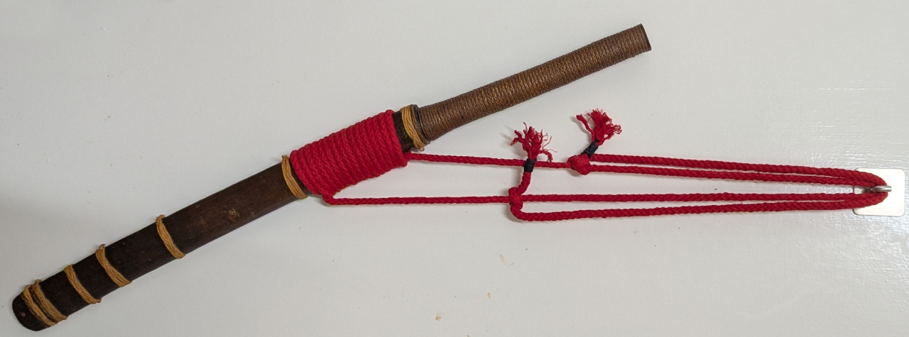

Old 25th January 2025, 11:27 AM   #18
Posts: 4,285
Update:
Got tired of the multicoloured nylon climbing rope on my short dha/daab, above. Replaced it with a more traditional braided red cotton rope with the traditional loop wrap mentioned above. Tied the cord ends in figure eight knots over the other end, so both ends can slide on the other for adjustment and spreading the load on my shoulder, whipped the cord ends & tasselated the ends.
