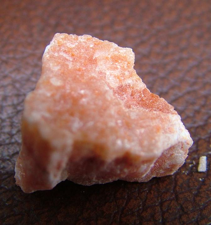

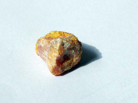

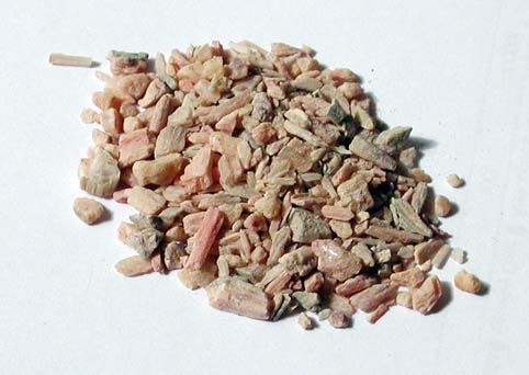

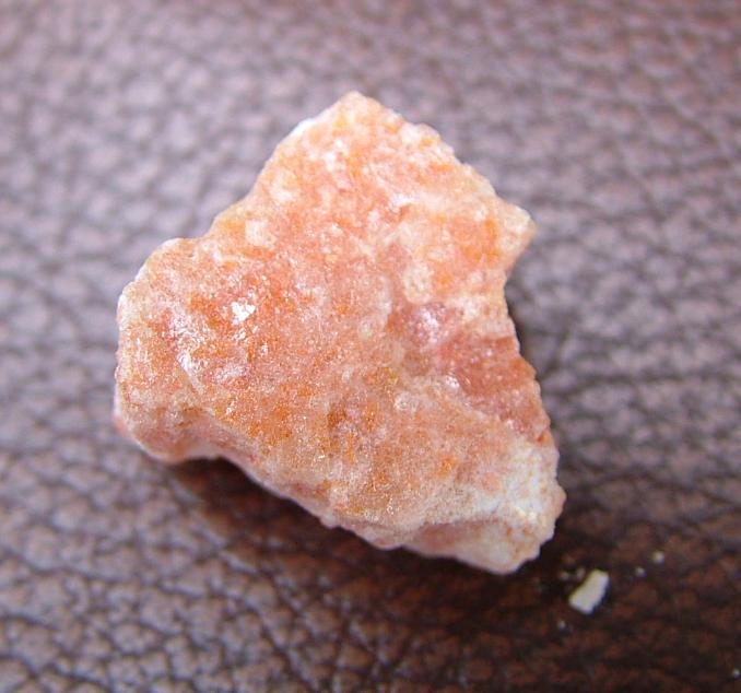

hello Tatyana
when you buy warangan its have to look like the warangan one the picteurs
you can buy many warangan but you can not use every warangan to clean your keris some even don`t work
regards semar

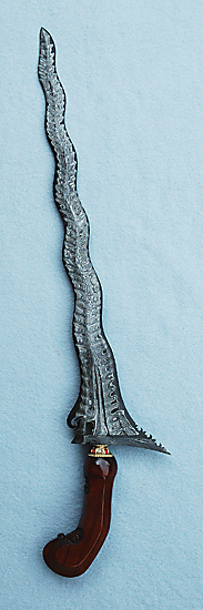

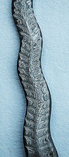

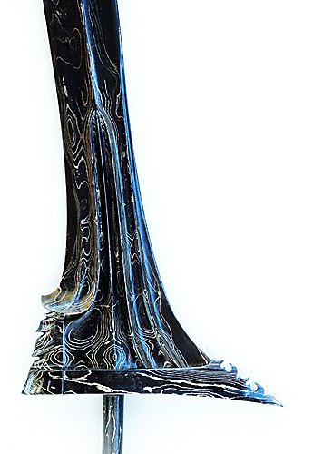

Over more than 30 years I have purchased and used traditional warangan in Solo.
It has never looked like any of the examples I've seen photos of here.
The warangan that has been available in Solo over the last couple of years has been very inconsistent in producing satisfactory results.
Since the early 1960's, and predating my use of Javanese warangan I have used laboratory grade arsenic tri-oxide. This has invariably produced very satisfactory and very consistent results.
Here are examples of these results:-

this warangan that i show you
comes from a friend of my from surabaya
mij friend cleaning the keris for a living
and i think whem you cleaning the keris everyday
you know wich warangan works the best
regards semar

I have heard that now days in Jaw also Selenium is used. Because of shortage/price of arsenic. Anny one ever hear about it? If it works must be one of it oxides. Haven't figured it out witch one. Sugestions, please?
And about the arsenic. Like Alan said, Di Arsenic tri Oxide (As2O3) works best, since it is the most agresive...lethal too. 100mg in your body will kill you, when taken oraly, dont know about in to blood stream.. probaly much lower.
than you have Realgar, red to orange AsS, easly bought in mineral shops. The mor red the beter, is what people say.. i got a big chump here of maybe 300Gr red to orange colour.. it works. Just when you make the bath ready.. pulverise the realgar realy good, i use a farmacy mortar to grind. A big hammer does the job too . and piut the stuff in lime juice. I never put it on a filter.. let the fiber rot.. good for the acid value (PH). En my best tip.. let it stand for atleast a year... other wise it wont work properly... limjuce i white/yellowisch... i should become dark red to black sollution... you will know when you see it when its ready.
The pinkisch mineral, i have seen it. But never used it my self.. And dont know if its a mixture of compounds, or a seperate mineral, cant find anny info about it.
And finaly orpigment a other arsenic mineral yellow colour! As2S3. Never used it my self.. but hear diffent story's about it. The person that learned me.. never want to have it.. since it's not working...other people say otherwise..
reagrds Michel
Ps sterling arsenic is metal arsenic, of non use for us! just looks pretty for mineral collectors. But it wont react. You can make trioxide of it.. but it dangerous.. so i wont tell you more about this
kulbuntet is offline   Reply With Quote

Well, as i read through this post i notice a bit of conflicting information here. I am not going to get into a this is "wrong" and this is "right" argument because firstly that's subjective (some people really get results in ways that others don't i suppose) and secondly it's just plain counter-productive. But i will give my own advice and reasoning for how i do it and why i don't follow some of this other advice.
Lab grade arsenic tri-oxide does work best and it is the only method that will provide consistent results. This is because a gram of As2O3 is always the same exact strength each and every time, without any added impurities that might exist in all the various forms of realgar. The only disadvantage that i can see is that it is not always easy to obtain, but i managed to get a hold of some after only a few well placed phone calls, so don't give up if you want to try this. And yes, Michel, it would be in it's most potent form and therefore more deadly. My advice would be, don't stick it in you mouth and definitely don't shoot it in your veins and chances are good that you will be just fine.
Actually, i would have far more fear about grinding it up in a mortar & pestle, or even worse smashing it with a hammer with pieces flying everywhere as this is more likely to make particles airborne and therefore breathable. If you are grinding this stuff up i would strongly recommend that you wear a surgical mask.
Michel, if you really need to let your solution rest for an entire year before using i see this as another advantage to using As2O3. I usually let mine settle over night and it's good to go. And i am not sure that i can see how letting the pulp rot adds to your acid PH or if that is even necessary if it does.
For those who what to use realgar i wish we could come to some agreement as to what color is best, because we are all over the map here. I have heard that purple is best, red is best, pink is best, orange is best and yellow is best. Well, only one can be best. If i were planning on using the mineral form i would be very confused right now.

Gents
For my sins I was once an aspiring Geologist. It was a long time ago but one thing about minerals sticks clearly in my mind. They differ in composition and colour a lot. If the relative amounts of arsenic to trace elements is important for the etch to work there is no saying that this will always be the same colour. Often other trace elements will alter the colour, sometimes a lot.
The result of this is that a good "etching " realgar may be red in one mine but may be yellow in another.
Roy
Old 12th August 2009, 07:01 PM   #24
Posts: 7,297
Originally Posted by Royston
Gents
Roy
Thanks for the geological perspective Roy. Makes sense. Also makes realgar even less predictable if you can't really count on the color as a guide.
