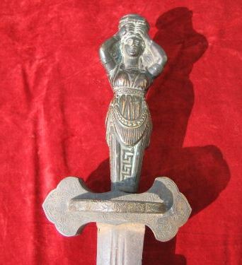

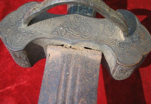

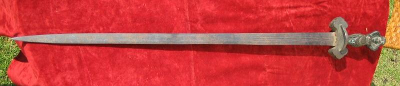

I have taken the liberty to post some pictures of the sword....for future reference.
