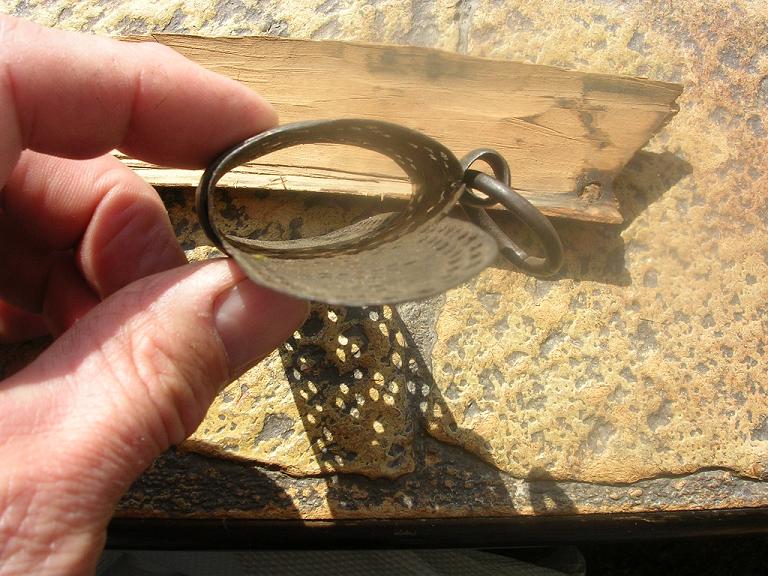

If I turn the fitting upside down and turn it, the decorative side won't be where the 'imprint' is. I can see we might bog down on this one, as it is hard to describe what I mean!
Below are added some pictures.
The first picture shows the middle fitting with the decorative side facing us.
The "imprint" on the wood, shows that the decorative side was always On this side. As can be seen, this would appear to make the scabbard left-handed.
#2, shows decoration and imprint aligned, but this means that the ring is on the cutting side of blade.
#3, shows that with the ring in the usual position, (on the inside of the curve) the decoration does not line up quite with the 'imprint.
#4, shows the 'imprint on this side of the scabbard.
#5 shows the mount removed from decoration, it appears to have never been apart before, but notice, the ring is on the narrower side of the mount, as though it was indeed made to fit on the 'outsid' of the curve, ie, ring nearest the cutting edge.
This struck me as a bit interesting, but if no-one has seen one mounted in this manner, I'll just mount it in the conventional way.
Sorry this sounds a bit confusing!!

It all looks very strange, and it seems as if the ring has been placed on the outer curve, which, to my oppinion, would be most unusual. I think I would place the rings of the old and new fittings on the inner curve – maybe the user was very excentric. Btw the upper fitting, could very well have looked like the mid part of the fitting you show in detail.
Nice pictures.

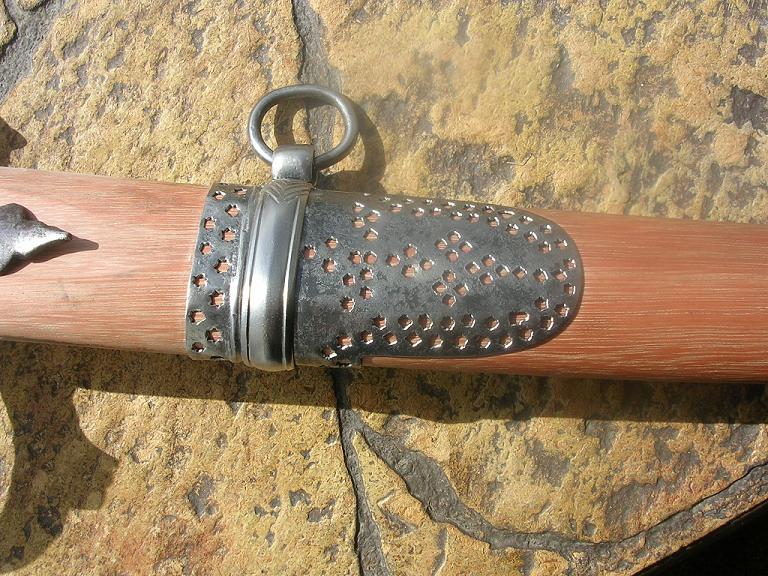

Well,
This is as far as I've got making the scabbard and top mount.
Attached are pictures;
1, of old mid-fitting on new wood.
2, The new top fitting, "aged"
and then ;
3, New fitting "in the white", plus old centre fitting.
4, new top fitting "in white"
5, old and new fitting in place.
Do you learned chaps think this is OK??
If so, just need to add a leather or fabric cover to the wood, and we'll be done....
Richard.

Very well done. I would like to see some pictures when you have the fabric on the scabbard. What kind of wood did you use for the scabbard?
Jens

Hi Richard,
thanks for the additional info
As to the cotton/canvas backing....It probably depends on the 'finishing' material. I think the idea of the backing is to 'smooth out' the surface so that finer fabrics appear smoother. Velvet would not show any minor imperfections in the woodwork below.......I am not suggesting there are 'imperfections' in your own scabbard (it actually looks very nice, the fittings set it off nicely...but I do not think the wood would have been left 'uncovered' originally....unfortunately) Glueing seems to be the normal method, however I do not know what sort of adhesive would have been used originally. Most modern 'contact' adhesives should be OK....but I would recommend that you 'seal' the wood first by applying a coat of the adhesive to the scabbard and letting it dry.....and then use the glue to bond the fabric 'coating'. I have one velvet covered scabbard which has the 'seam' ( folded edge) hidden beneath some decorative 'edging' but do not know whether this is traditional.I want to make a scabbard for the khanda but would like to find a 'period' looking covering for the wooden core......and the 'suspension' rings/mountings will have to be fabricated.(again I will have to find examples). I really like those on your scabbard.....sufficently ornate without being 'over the top'.
One other thought....the scabbard furniture...was it fixed/riveted to the scabbard or bonded/glued to the scabbard?
Regards David
Old 29th March 2007, 01:43 PM   #22
Pukka Bundook
Join Date: Jan 2007
Posts: 803
Hi David,
The middle fitting was loose when I got the scabbard, and no sign of glue or anything to hold it in place. Probably a friction fit.
On new scabbard, It took a while sanding and fitting 'till the fittings would slide up far enough to align in their original position, as scabbard has some taper.
The velvet had been added After the fittings were in place, fitted and glued around their contours.
The lower fitting was interesting.
The last 7 inches or so of scabbard was an add-on, either because of an earlier breakage, or more likely, the wood used wasn't wide enough for the curve.
This added piece was half-lapped and glued together with the same resin that is used to glue the tang into the hilt. (Peepole tree resin?)
Also, this same resin had beed added fairly thickly to lower part of scabbard,to glue the chape (or lower fitting) into place.
Re. the decorative strip to cover the join in the fabric;
Q. Can you (or anyone else for that matter!) tell me if this strip is normally on the showing side or Inside of the scabbard??
Thanks in advance,
Richard.
